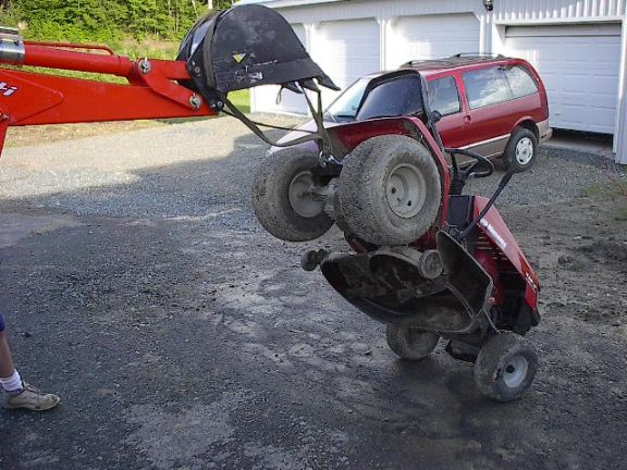

Having the hoe sure comes in handy for tire service, nice to be able to lift all four wheels off the ground if you want to rotate the fronts to the rear... Wait that's on my Jeep... /forums/images/graemlins/blush.gif
Seriously it makes a handy tractor lift....
