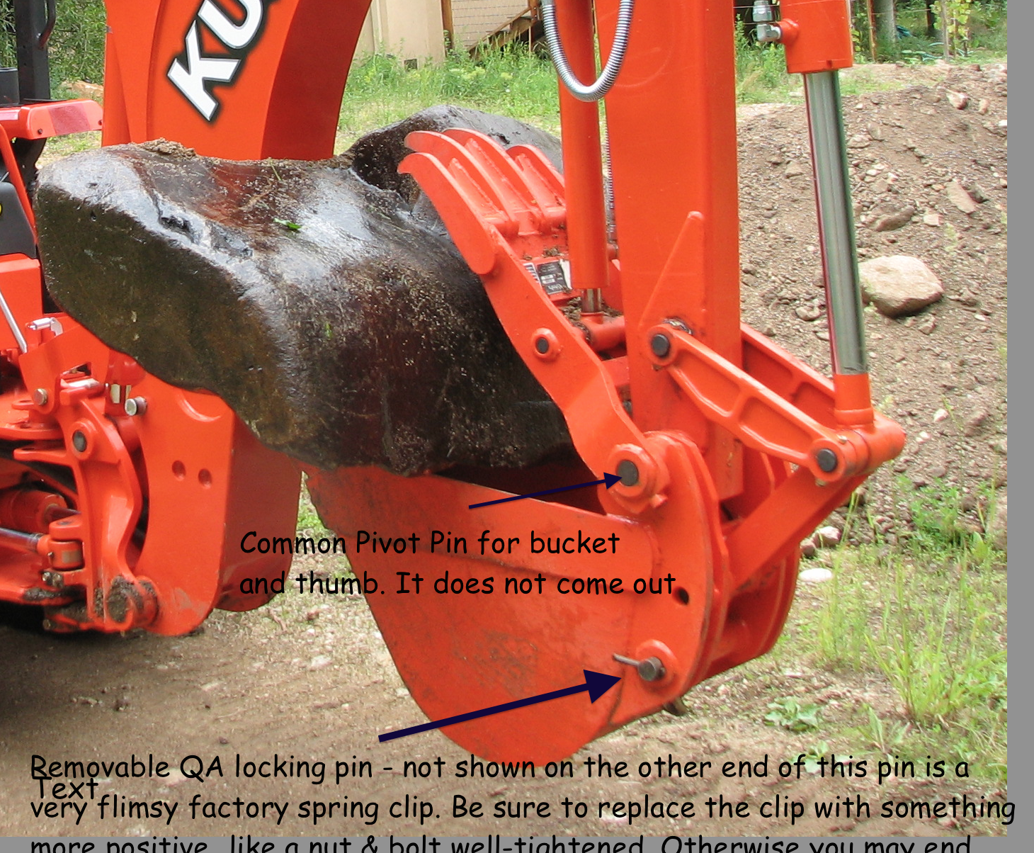

It's not the first issue we've seen with Kubota backhoe pin keepers. Almost ten years ago I remember us talking about their quick attach BH bucket that had the main retaining pin held from sliding out by a simple cotter pin. Several people - including myself - had the cotter pin fail and the backhoe bucket get into trouble.
The cure for that problem is the same as for this issue: use a proper fastener.
Here's photo from 2014 - it mentions the problem but if is of the wrong side to show the cotter pinSide closeup after annotation.jpg.png
Here's photo from 2014 - it mentions the problem but if is of the wrong side to show the cotter pinView attachment 785961
rScotty
You probably mean hitch pin, but yeh I hate those too. Anything I use often that has a hitch pin, and the hole can be drilled out to at least 1/4", I replace with a lynch pin. $1 dollar at TSC.

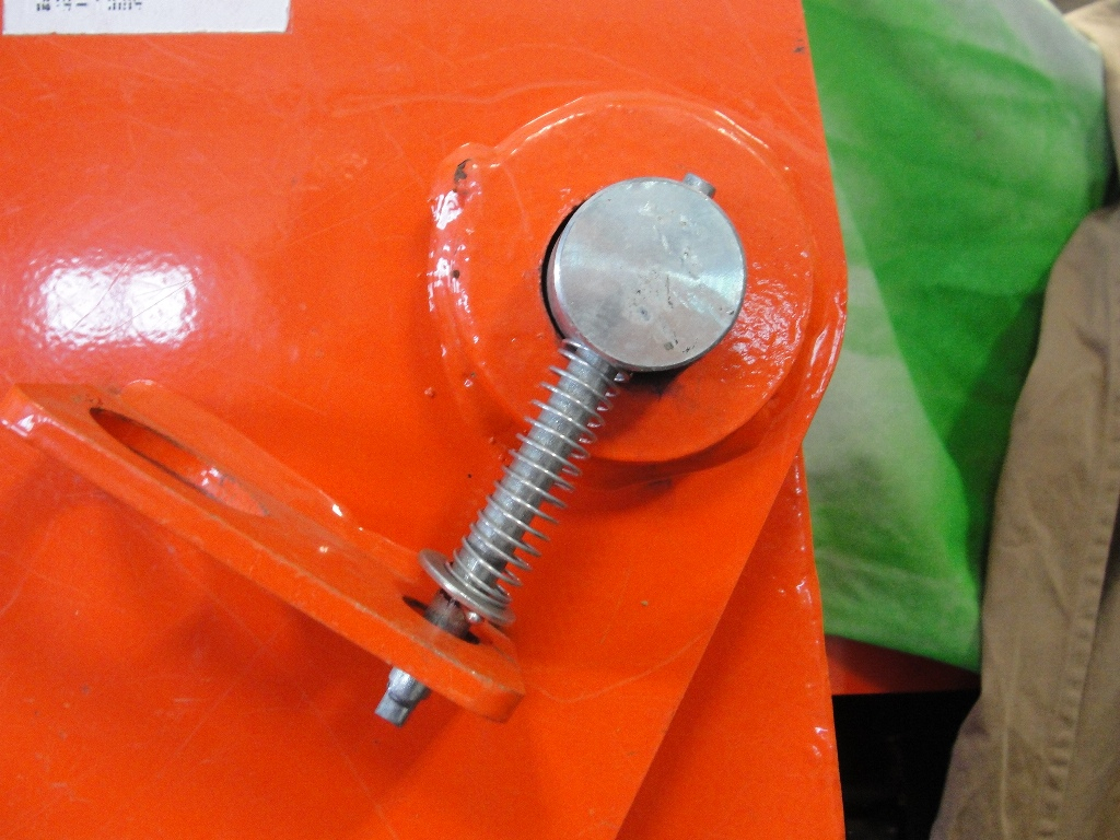

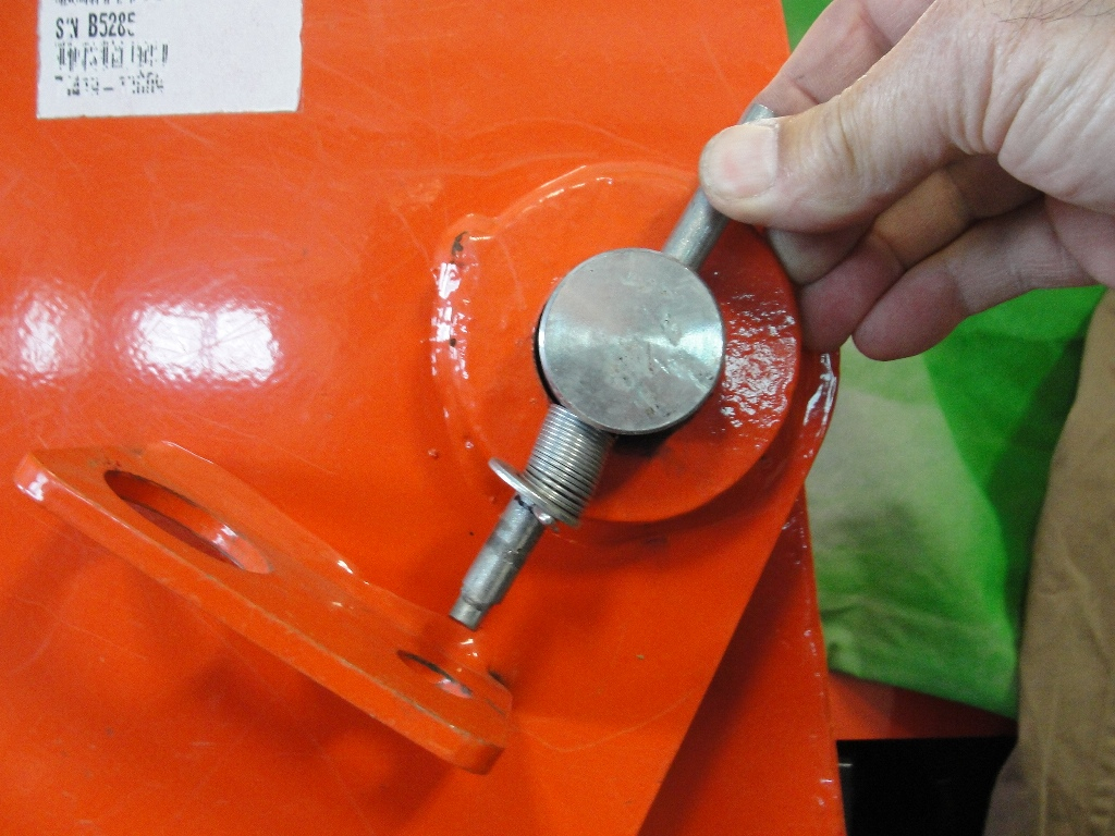

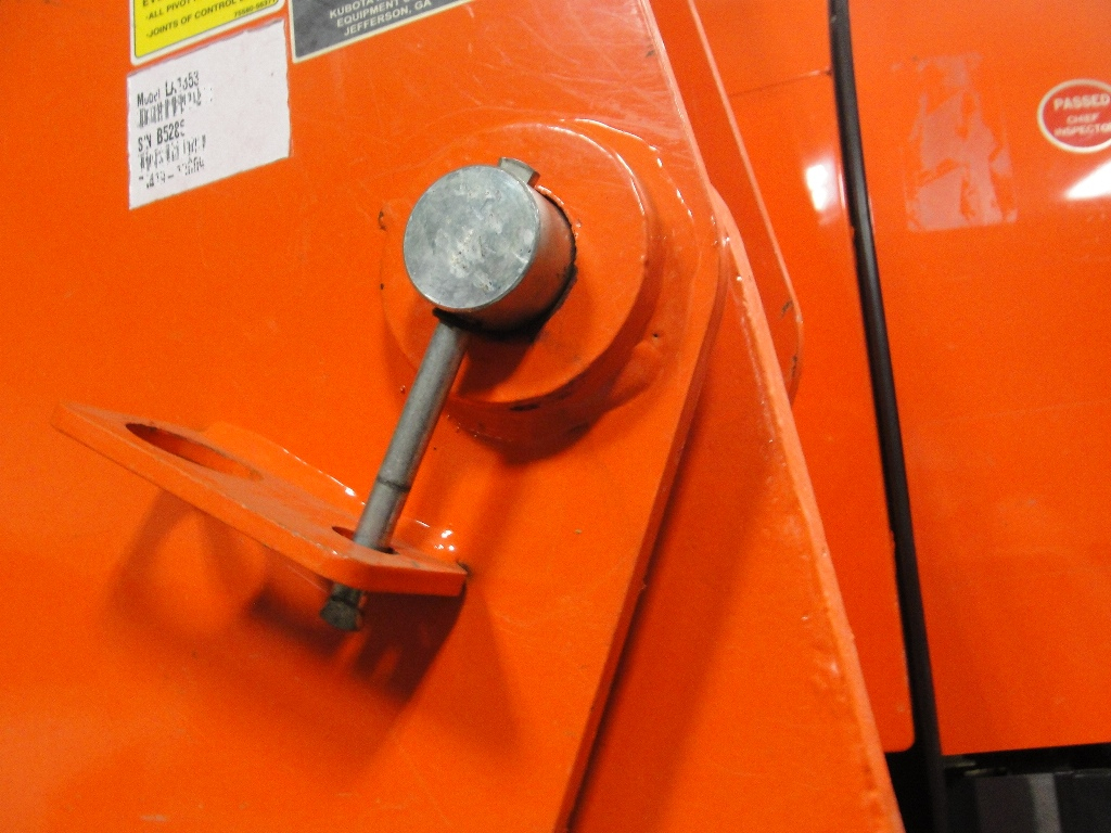

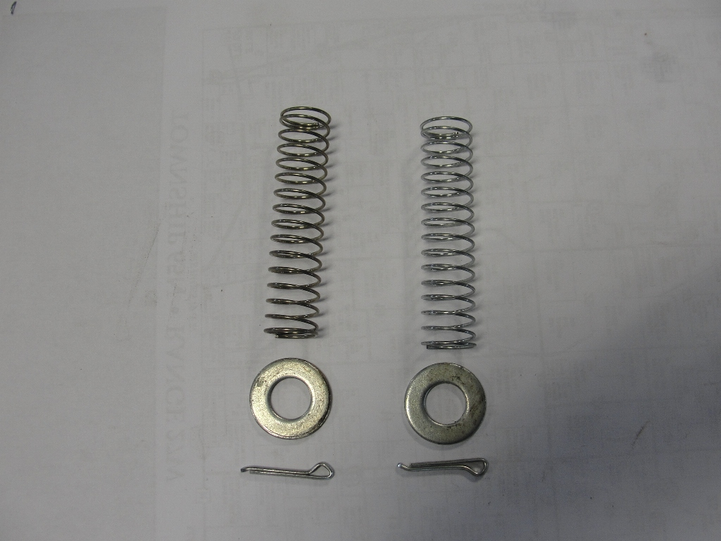

Although this situation was an error on the part of the installer, this might be of value.
Kubota uses a similar setup to retain the FEL on their tractors. Difference being gravity is in your favor. Several years ago here on TBN someone started a thread about their pin coming out. They had bounced the tractor hard enough to cause the keeper pin to rise out of the retaining hole.
Being wintertime and shop bored I decided to "fix" that issue. Using my factory retaining pins I modified them and eliminated the chance of them bouncing out. Here's some pics of what I did.
