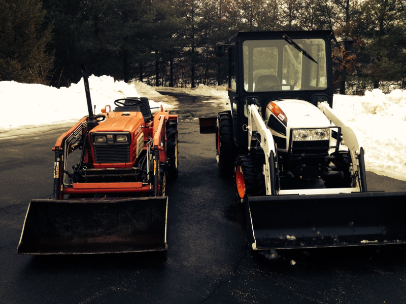

Here is one of it sitting next to a ct225. The ct is 1 foot wider.
Can only post one pic at a time

If you discount the cab, how much difference is there between what work you can get done and implements you can use between these two. I understand one's much newer and has an HST but can you do 2x as much or 2x as fast with the bobcat? I guess I'm trying to get some measure of work/$. Which one would you say is the better value?

Over all grunt is a lot more with the bobcat but it's a lot heaver to. It is not 2x as productive maybe 25% more. But it is much much nicer to operate with hydro trans,power steering smooth hydraulics large comfortable platform and everything seems to be where it is supposed to be. Don't get me wrong I loved my Yanmars they were great but they were 1982 and older machines. And did everything I needed especially the 1702. Until I found the deal on the bobcat I planed on keeping the Yanmar forever. In fact I kept it quite a while after I got the bobcat because I was so fond of it and I new I could count on it. But after using the new machine I did not want to use my beloved Yanmar anymore If you have never operated anything like a bobcat ct 225 (kioti ck 27) you should really take one for a spin it is a pleasure to operate and get on and off of not a chore.
/ Which Yanmar model (if any) #40
Generally speaking 1 to 2 foot wider Implements. Bushhog 4'vrs 5'. Box blade 4'vrs 6'. Grader blade 5'vrs 7'. As far as better value? I guess only time will tell. The Yanmar was Cheeper obviously ( I still paid about half of what I had to pay for the bobcat)but it was a used 30 + years old gray market and the ct was a new 1 year old model. So I think that if in 30+ years the bobcat is still going strong like the Yanmar was then I don't think anyone could complain about that.
