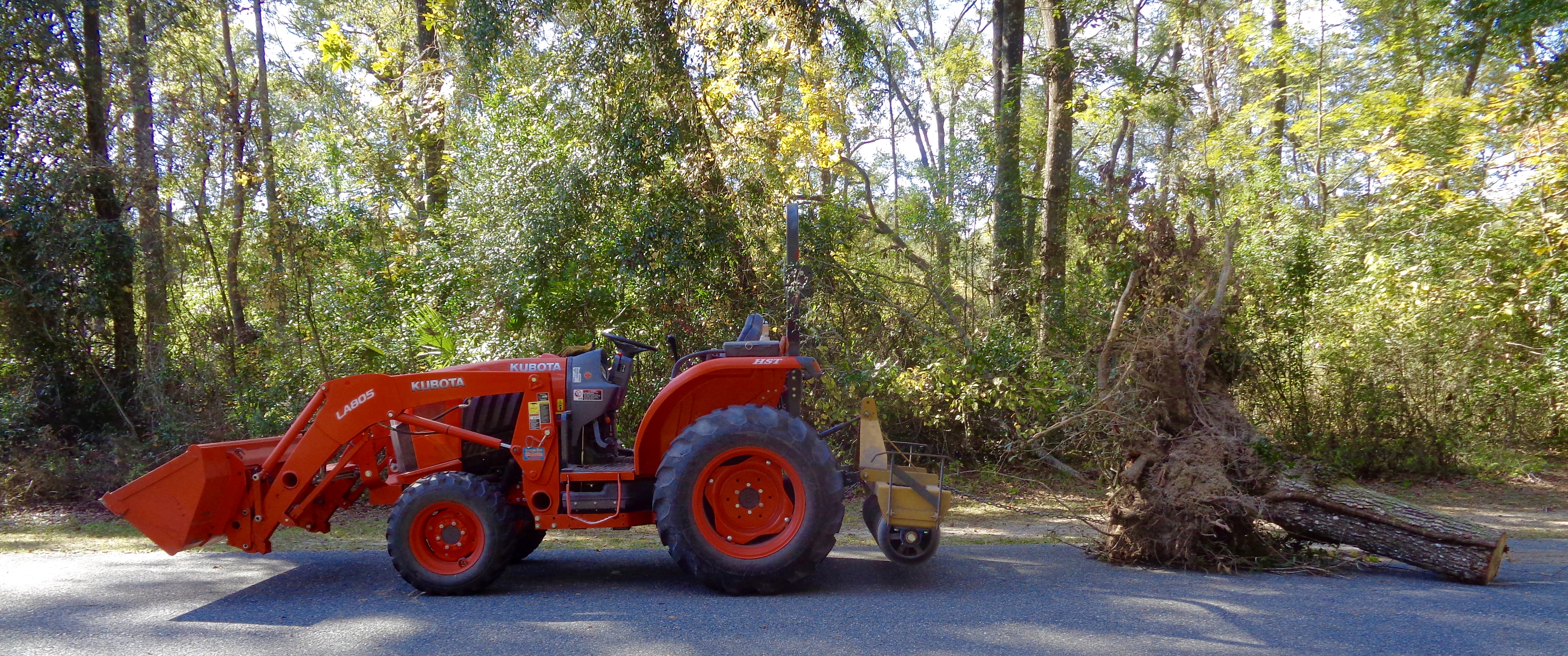

My bare weight 3,500 pound Kubota L3560 tows some fairly heavy loads from the rear/center drawbar with chains. You can drag some large boulders with from the rear/center drawbar of a much heavier Utility Tractor.

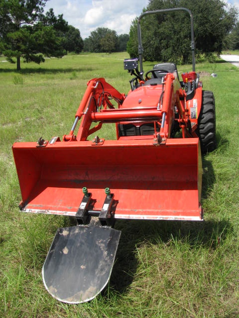

I volunteer in a small, organically farmed Blueberry patch, owned by an aging Viet Nam vet.
We have found a $400 Bucket Spade to be extremely useful.
MORE: http://www.tractorbynet.com/forums/attachments/328798-bucket-spade-today-fel-bucket.html?highlight=
I love my Kubota but I was in the same position as you. I found that the best thing was get a skid steer you will be a lot happier if you have a lot of heavy loading to do with one you can lift a lot more in a smaller package , and if you decide it's over kill after your done with the road just sell it. My 2501 does great for 90 % of what I do I do have a grapple on it almost never use the bucket. But when it comes to heavy lifting I use the Bob cat. If you do get a tractor I have had both a manual and HST and if all I'm doing is bush hog or harrowing a manual is the way to go you get more pulling power out of them, but if you do a lot of loader work the HST makes life a lot easier .
