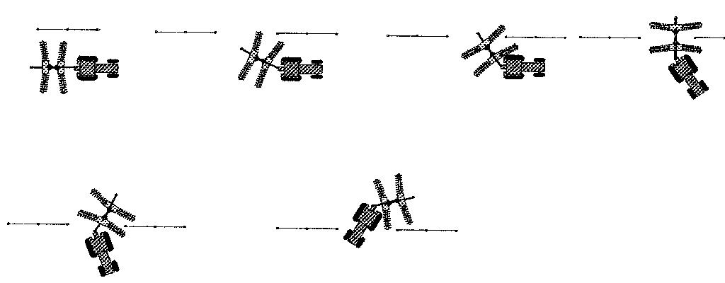

Halftrack, ok man, I have been racking my brain all night on how you would back a 14' tandem through a 12' gate. I have gotten into some tights spots before so I am not sayin that it can't be done. Can you describe how you would do that or send a drawing a picture or something!

A tandem has an X shape when viewed from overhead. It may be 14' wide at the widest points but is much narrower in the middle. You can work the X through the gate. I have never done it on a disc but I have got wide bull dozer blades through narrow gates many times this way.

Right on bdog. Hopefully the attached diagram will demonstrate the movements needed to accomplish squeezing the disc through the gate. Looks easy on paper but, typically involves a lot of shifting, clutch riding, lock to lock steering, brake riding and cursing. Now, imagine using a 1964 model Case 930 tractor with LESS than power steering, brakes that were shot and an over-center clutch. I remember once actually putting the tractor in reverse and backing through without stopping. Of course, no one was around to witness the feat and no one would believe me later. The limitation on what gate your disc will fit through is the distance from one side's transport wheel to the opposite side's disc gang. I my case the was probably around 10' so the 12 ' gate was doable. disc backing.jpg

Awesome Halftrack, thanks for the sketch. I think even I could pull that one off:D

That is an impressive sketch.

Thanx for the compliments. I had to work on that a while and thats why it took so long to respond to tmc_31's request. Somewhere in the process, I lost the fact that the tractor was BLUE and had supersteer.
