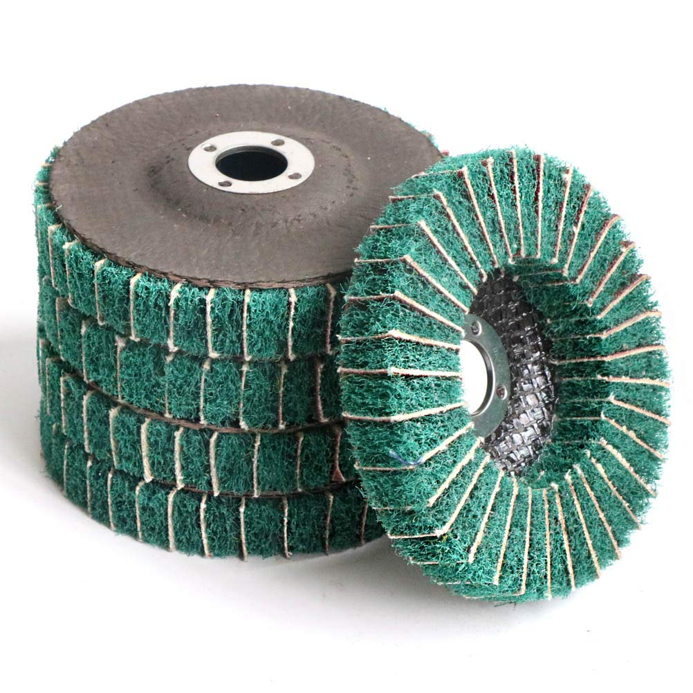

We have some large picnic tables we care for which are located at remote locations. The finish is starting to peel so they need to be scraped, buffed and refinished. For cleaning and buffing them I thought I'd bring my generator so I could use my 4.5 angle grinder to do that job with. We'd then blow them off with air compressor when done. What pads might we use? I thought about trying these soft pads in 120 grit.
FPPO 5Pcs 4.5" x 7/8" Nylon Fiber Flap Disc Polishing Grinding Wheel,Scouring pad Buffing Wheel for Angle Grinder, Polishing Tools (Grit 120) View attachment 755689
I am with the guys who recommended the random orbit sander. Start with perhaps 80 grit and move up to 150 grit for a swirl free sanding.

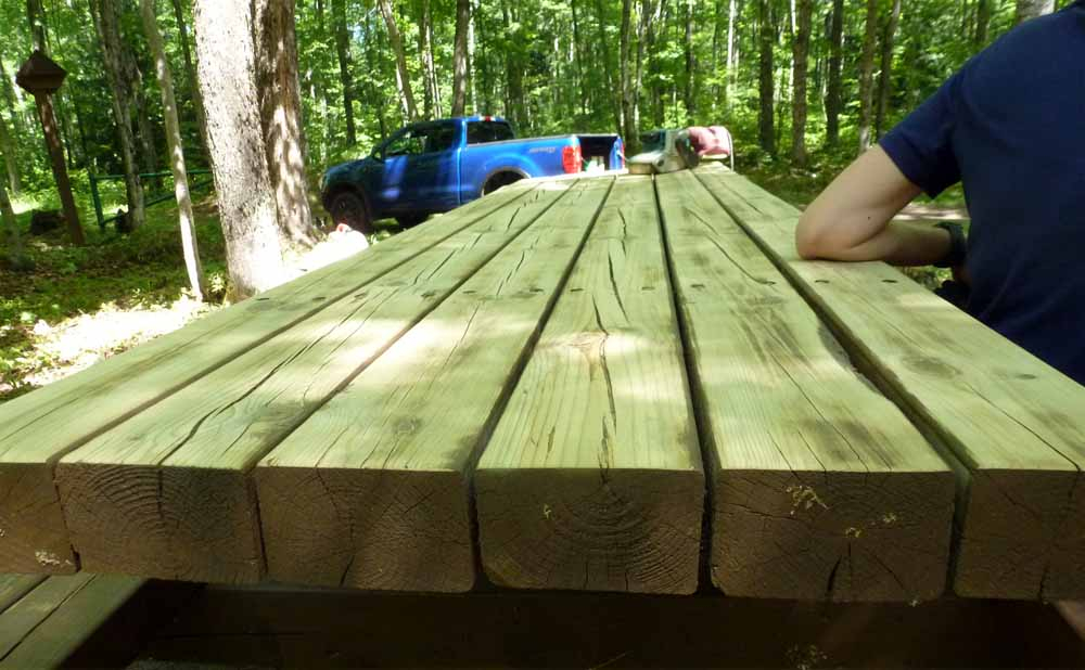

I few pics taken yesterday. Seems if we'd had used a orbital stander, we would still be out there sanding away. 😅
So much material was taken off, the 4x24 was the best way to go.
