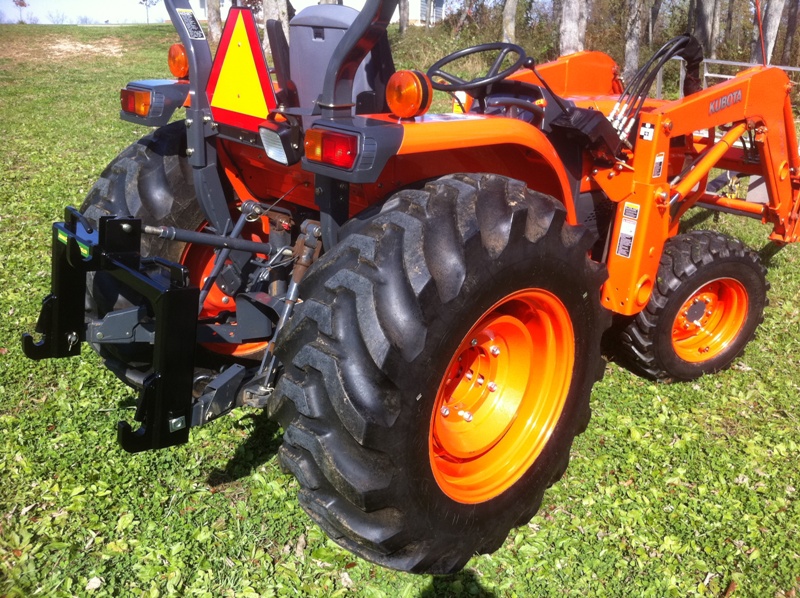

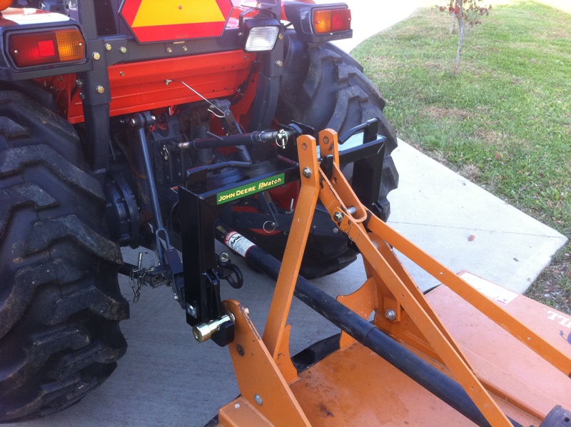

The problem I see with people and their QH's is they cheap out and buy the low grade hitch and then get peeved when things don't work. The JD iMatch is nice but an adjustable top hook is a must IMHO. That is why I recommend the Landpride. Top quality with adjustments. I haven't found an attachment yet that it will not work on.:thumbsup:
No need for a adjustable top hook if your attachments are to Cat 1 specs. If they are not I would rather modify attachments than fuss with adjusting the top hook. Takes the quick out of the quick hitch. :laughing:
Yeah I agree about the cheap hitches. I saw one at TSC that looked like it was welded by a child. I think it was made in china so it probably was. :( What get's me is it was over $200!!! :confused2: An American made JD iMatch can be had for around $280 if you haggle. :laughing:
