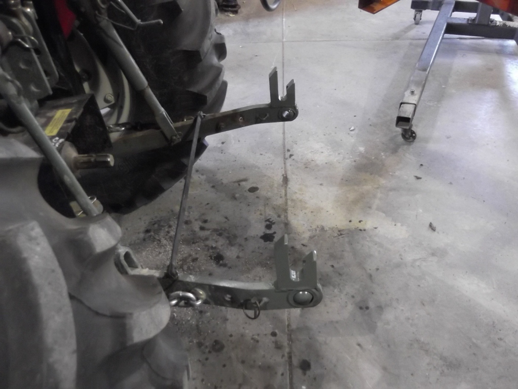

I got these weld on hooks and I like them a lot probably the best $65 I have spent on the tractor yet. The pins are missing from the pic because I just got done painting the hooks at this moment the pic was taken.
