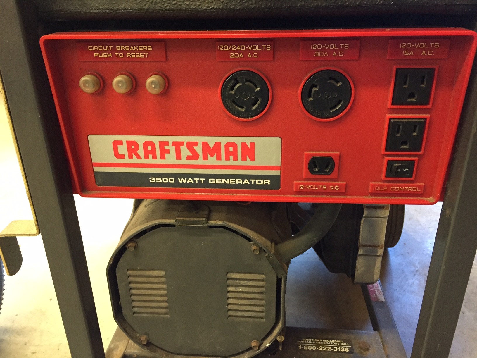

This Craftsman generator came with the house in Mendocino County. No idea when it was made. It has a Generac engine. It always starts with one pull, or actually half a pull, it is very easy. There is a manual transfer switch and input receptacle installed near the garage breaker panel for running circuits in house and garage. I've never used it. The power does go out sometimes, but I can live with that for a day or so, by which time it comes back on. I run the generator every couple months using some power tools for a load, and keep the tank filled using a fuel stabilizer. It seems to be a good generator.
That looks like my old Generac, re-branded I would guess.
