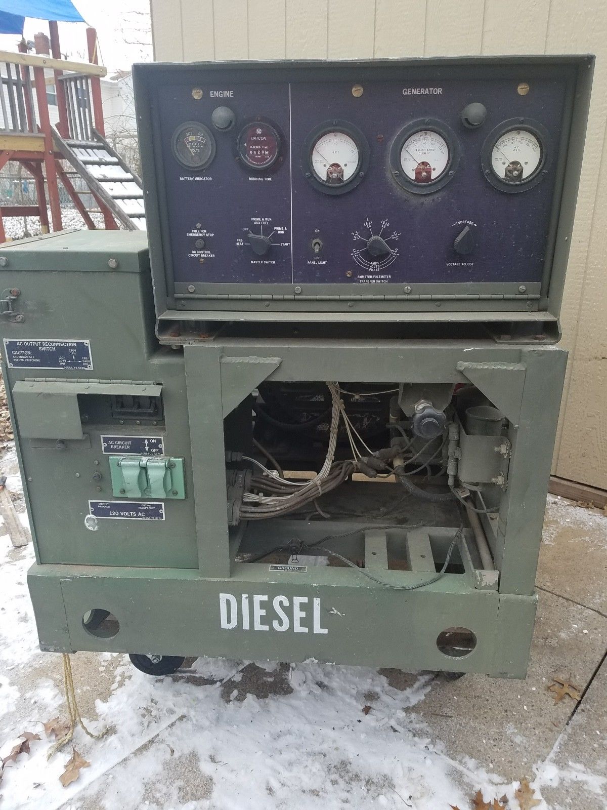

Yes, I bought a 10KW diesel 1800 RPM military generator back in September. Had 33 hours on it. 2007 model. Thing is freaking AWESOME! Will run both my 5 ton and 2.5 ton heat pump at the same time. Way under rated. I have the aux fuel kit for it as well. I have it sitting in my garage on top of caster wheels and can just plug in panel and fire it up to run my house.
