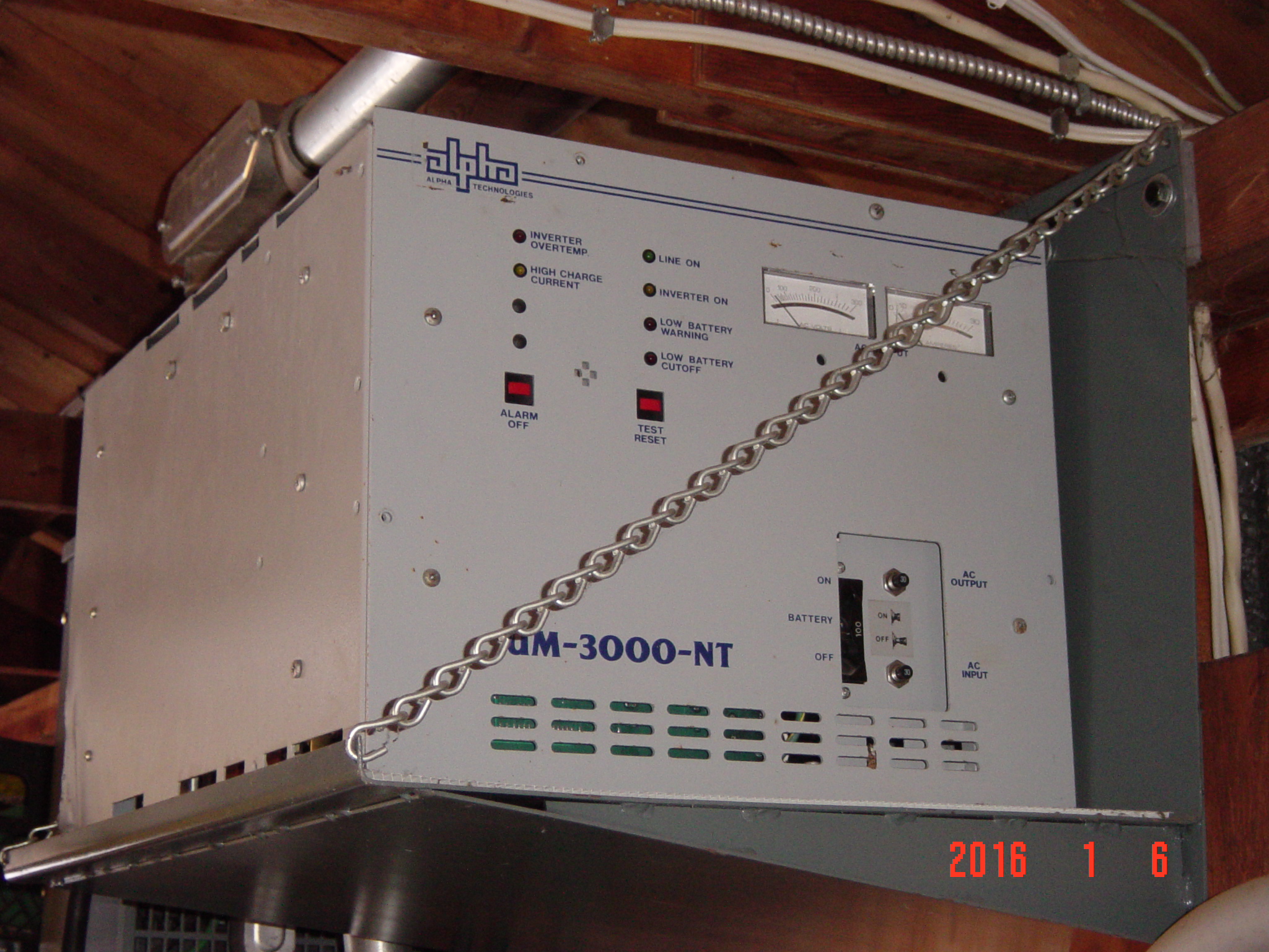

I have the 3000 Alpha Telecom inverter (Installed) uses 48 volt batteries.

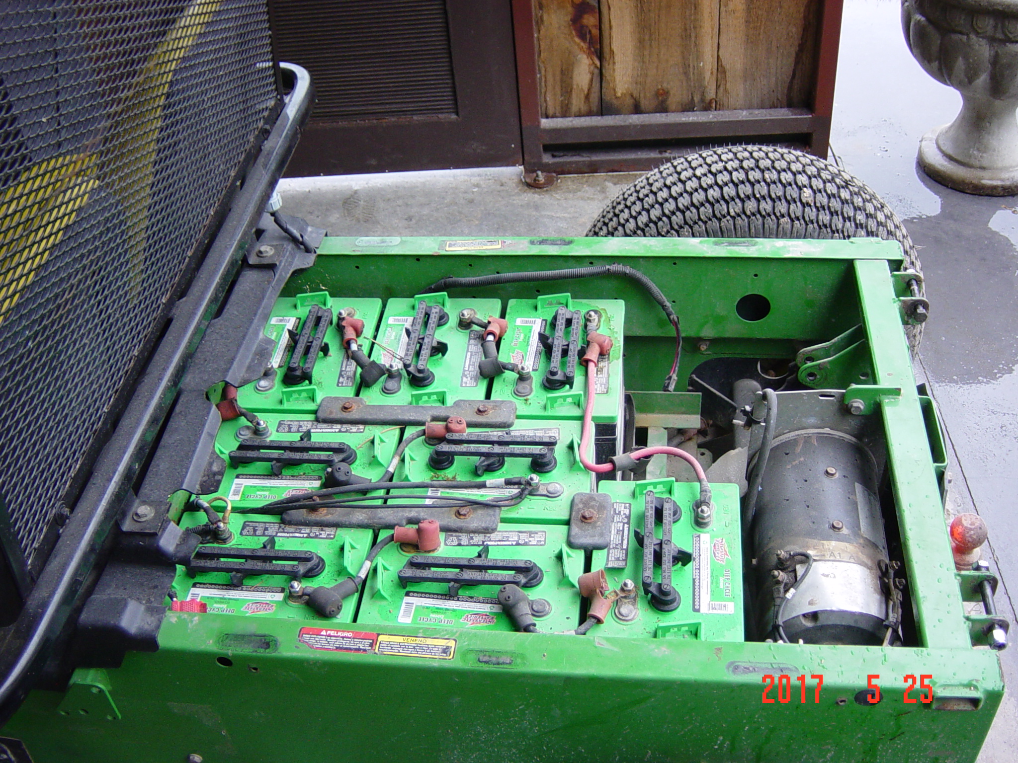

I have the E-Gator, with the 48 volt batteries.
So, the next time I get some small Diesel Engine/Generator, cheap or free, I may build a 48 Volt DC charger and have that thing running VERY slow like 1200 rpm.
The LOW Battery Alarm on the inverter could be used to start the Diesel, then have it timed to run a while.

The 48 Volt Gator gives all kinds of options being multipurpose... similar to Musk is promoting with Tesla...
/ which portable generators do people have #288
It beats having a rack in the garage with eight 6 volt golf cart batteries that take up room, need to be watered, charged and just grow old.

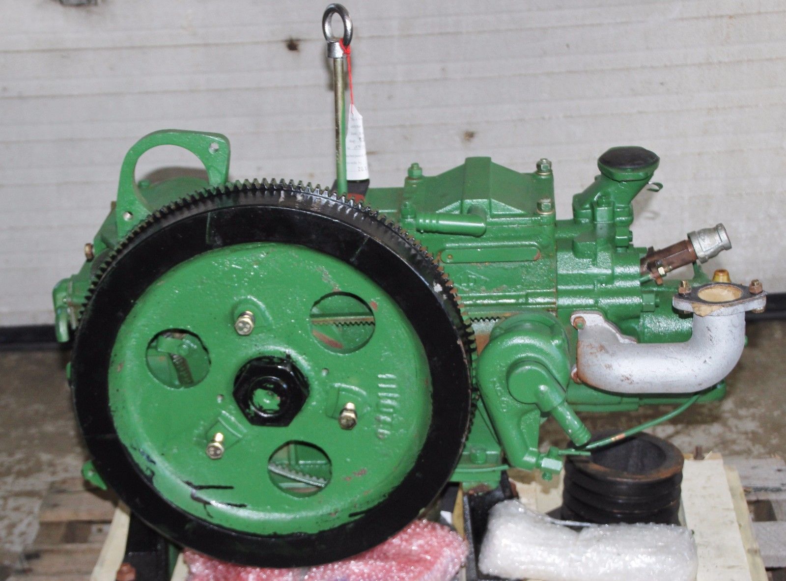

I just came across this LaiDong "Compressor" on E-Bay out of Canada. They also sell the Listeroid "Compressors". LOOK MA! 2018 and NO PLASTIC! Anybody know anything about these? I see from You Tube that they run at 2200 RPM! That's disappointing.

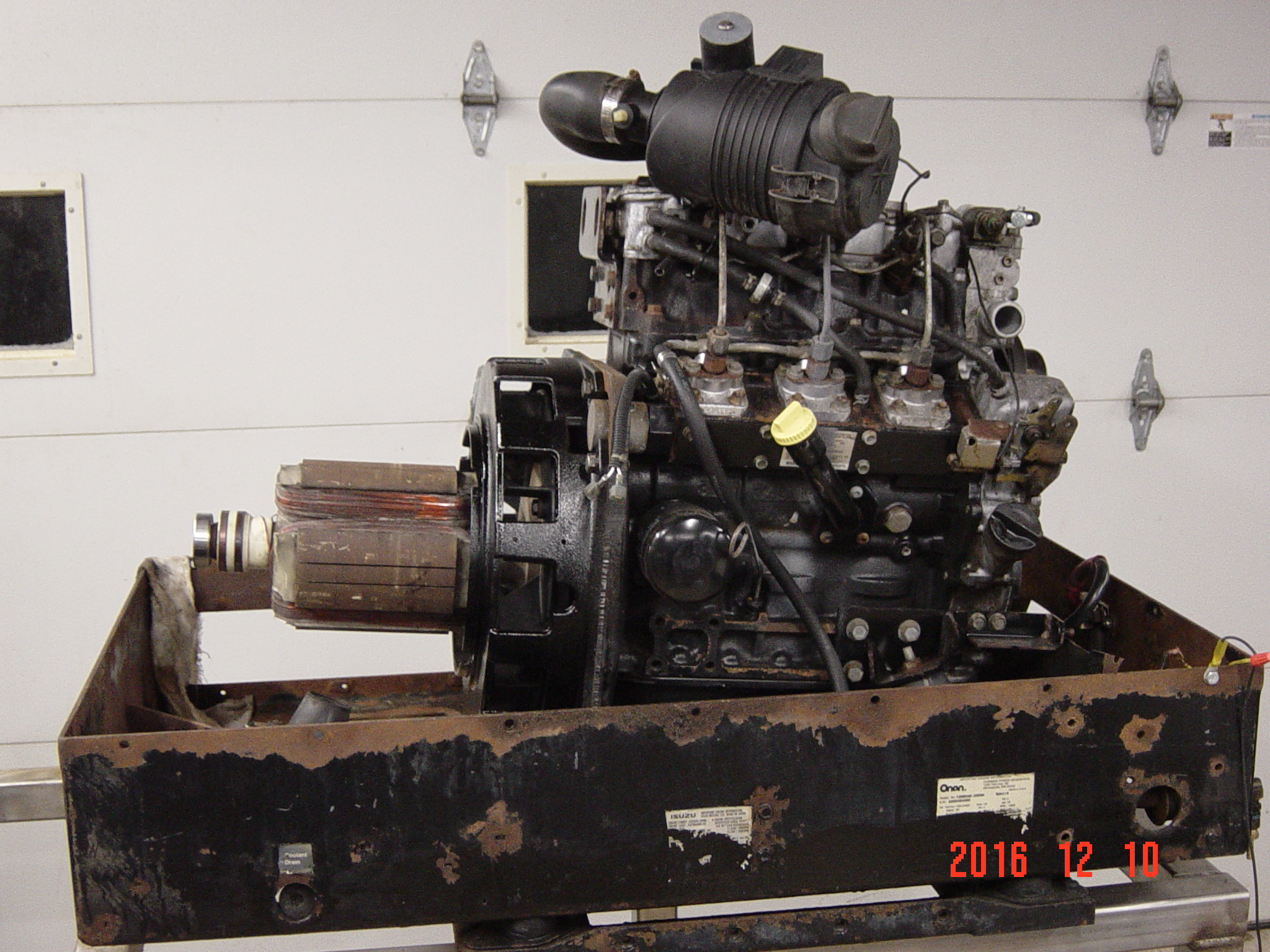

As I previously stated, I was looking to upgrade from an Onan I currently have. Was hoping to power the whole house but, it appears I don't have sufficient tractor horsepower to do that so, I'll stick with what I've got. BTW, compared to where Dave is, my heat requirements are insignificant.
