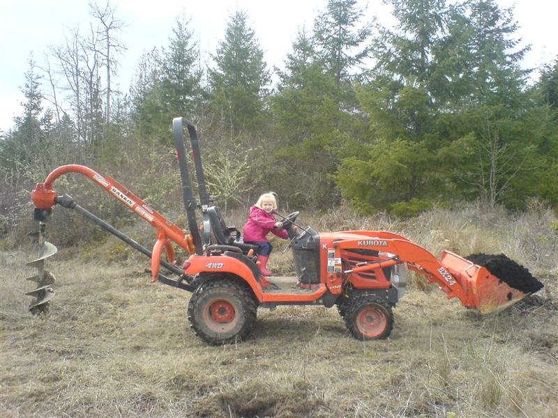

I have a Rankin 601 for my BX-24 with 9 and 12 inch augers. The 9 inch is 48 inches long and I can only lift it about 2 inches off the ground. The 12 incher is 42 in length which I think is perfect.
Pictured is the 12 inch.
