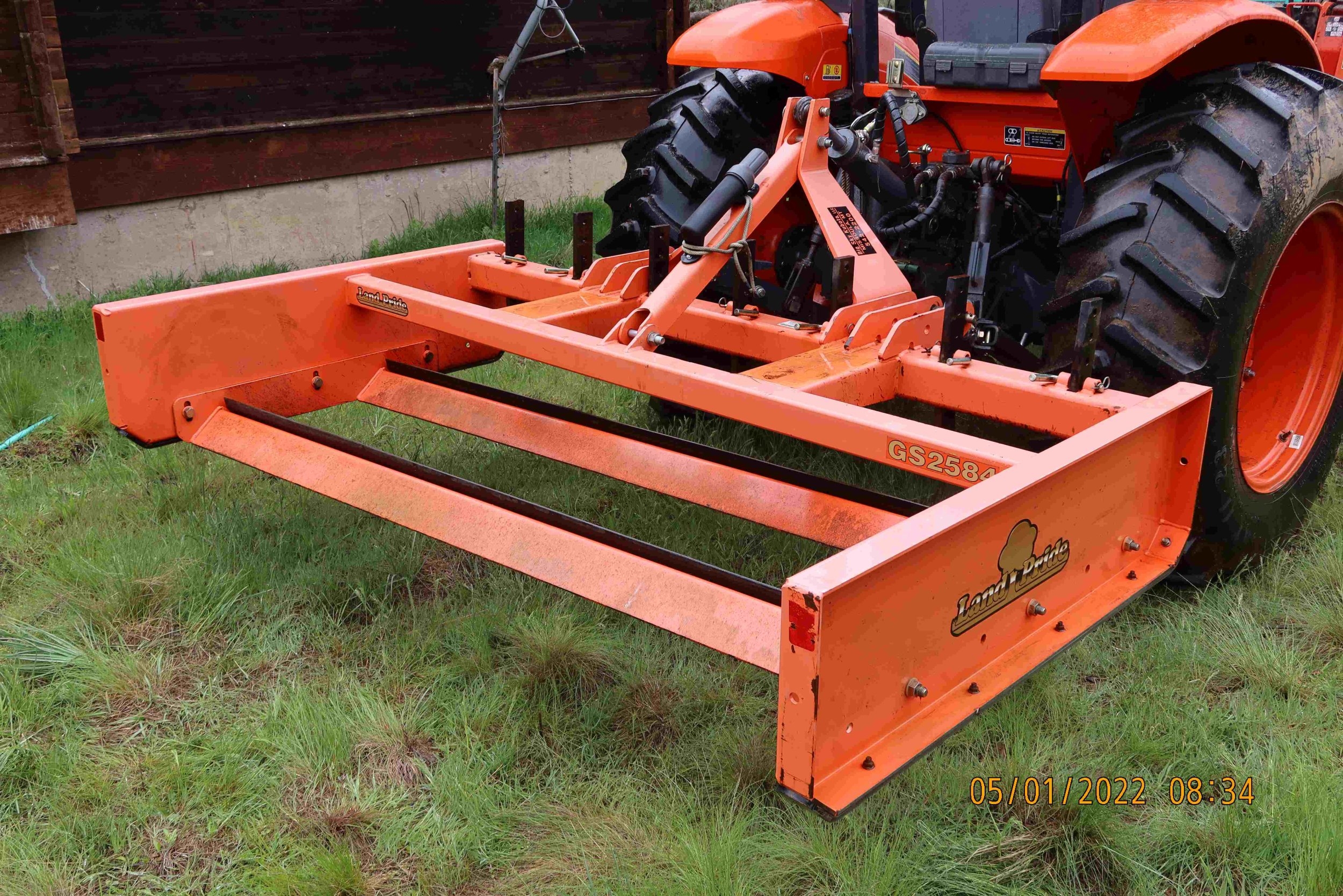

Look at Land Pride. They make a very tough LPGS. I have a 84 inch one ( GS2584 )and use it on my mile long gravel driveway.
All my implements are class 2 or 3. So specs and prices would not do you much good.

I have a mile long driveway. The surface is a combination of gravel, sand, volcanic ash and silt. It dries out, after the spring rains, as HARD as concrete. I have scarifiers on my LPGS. They are very important to break this surface "crust". Otherwise it takes two or three passes to "break" the surface. It's nice and clean - just washed all the dirt off.
