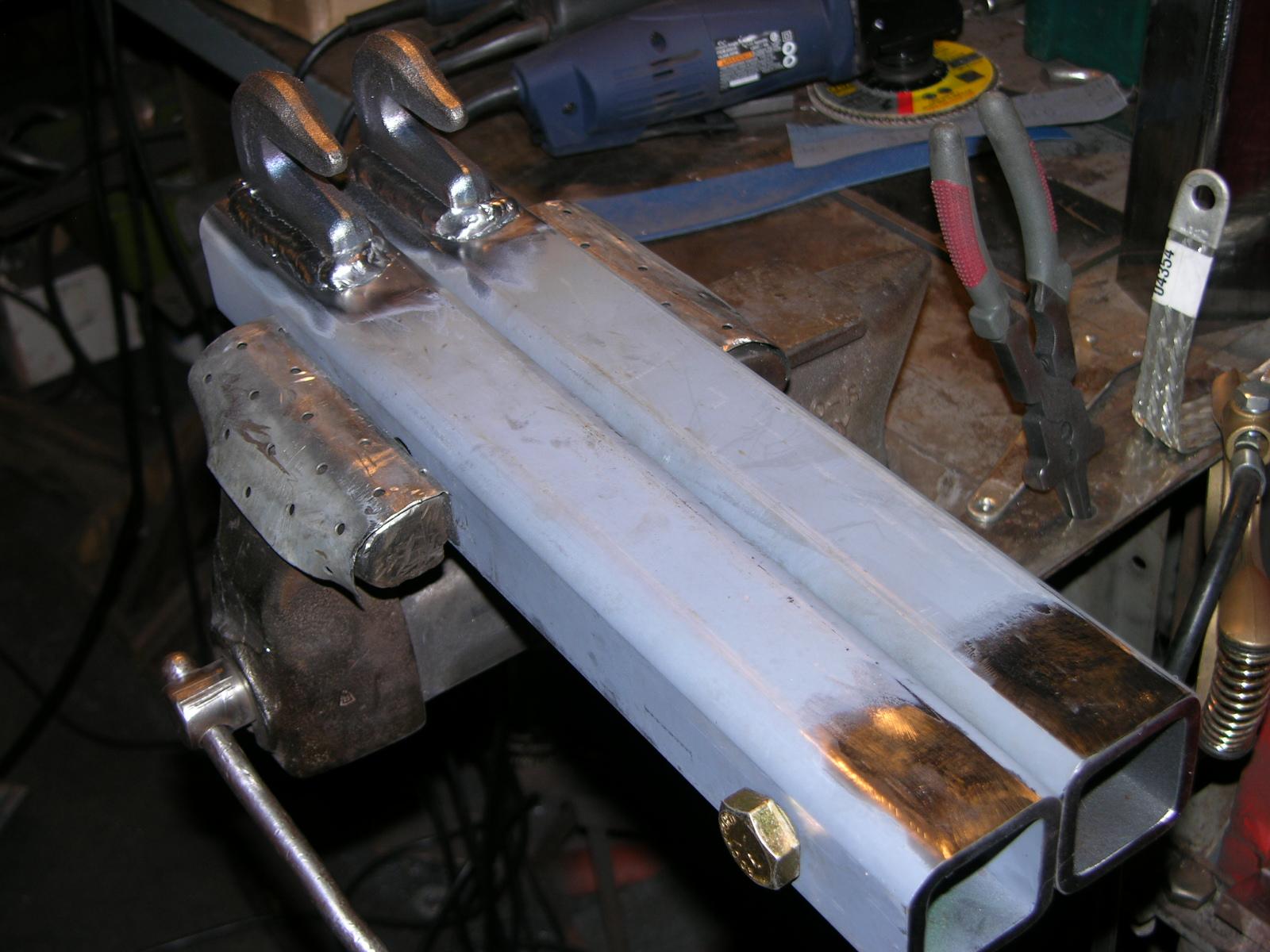

Thanks for looking Steve. Does anyone know where we can get this style of forged hooks?? Thanks!

I don't know about the second one but I noticed the pin hole is not right compared to the orientation of the hook. when installed the hook will be horizontal instead of vertical.

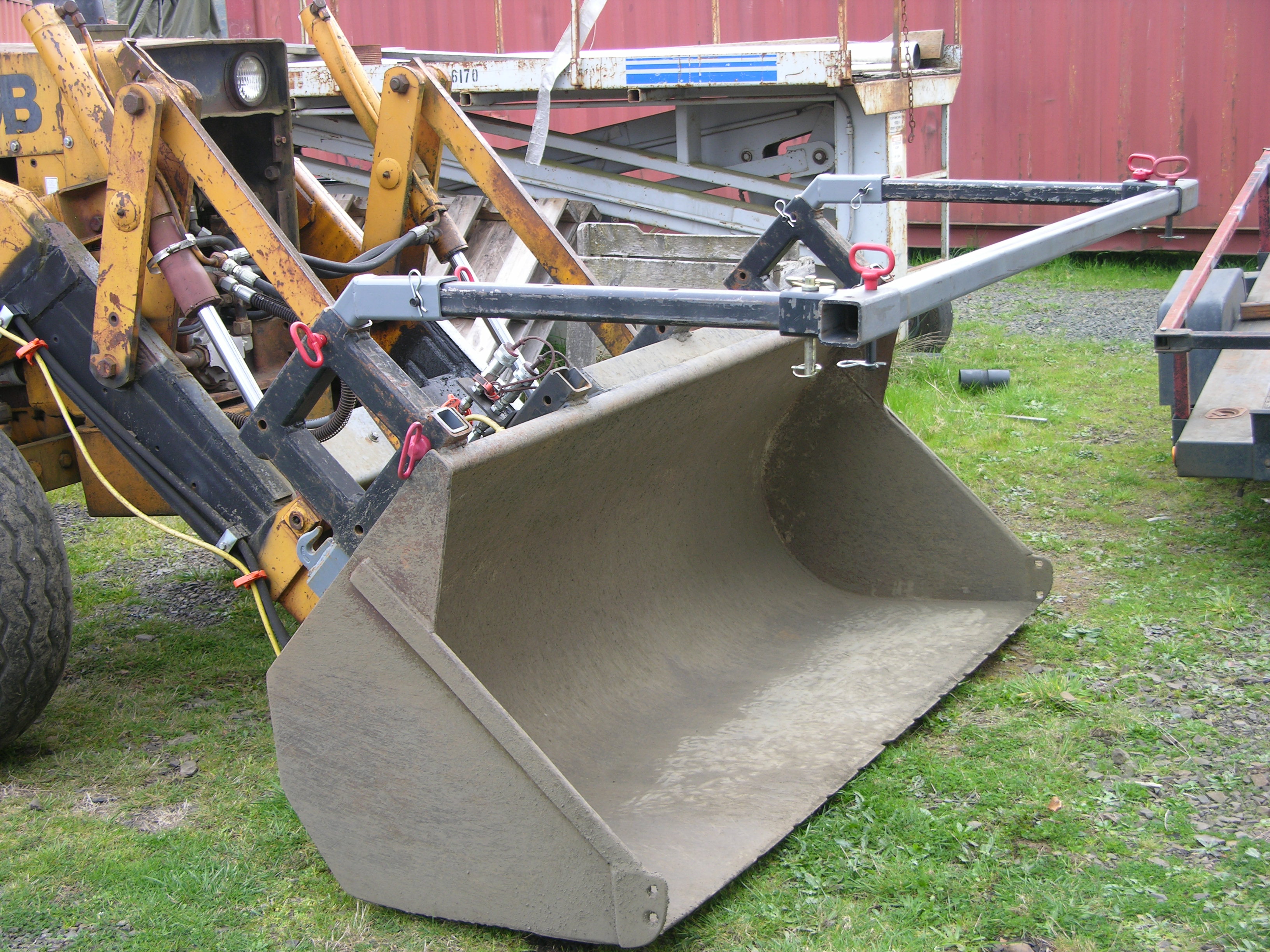

Jons got that correct. I just put the hook on top of the 2" tube for the photo, no welds made but it was 90 degrees off. I went to the school shop this morning to finish the hitch's up and found school was cancel due the virus thing. Oh well.

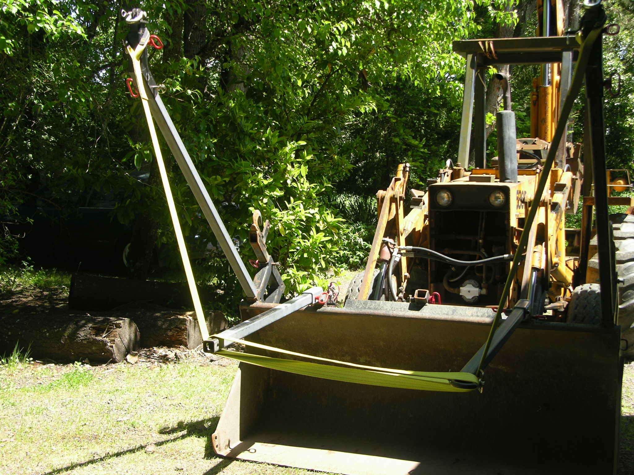

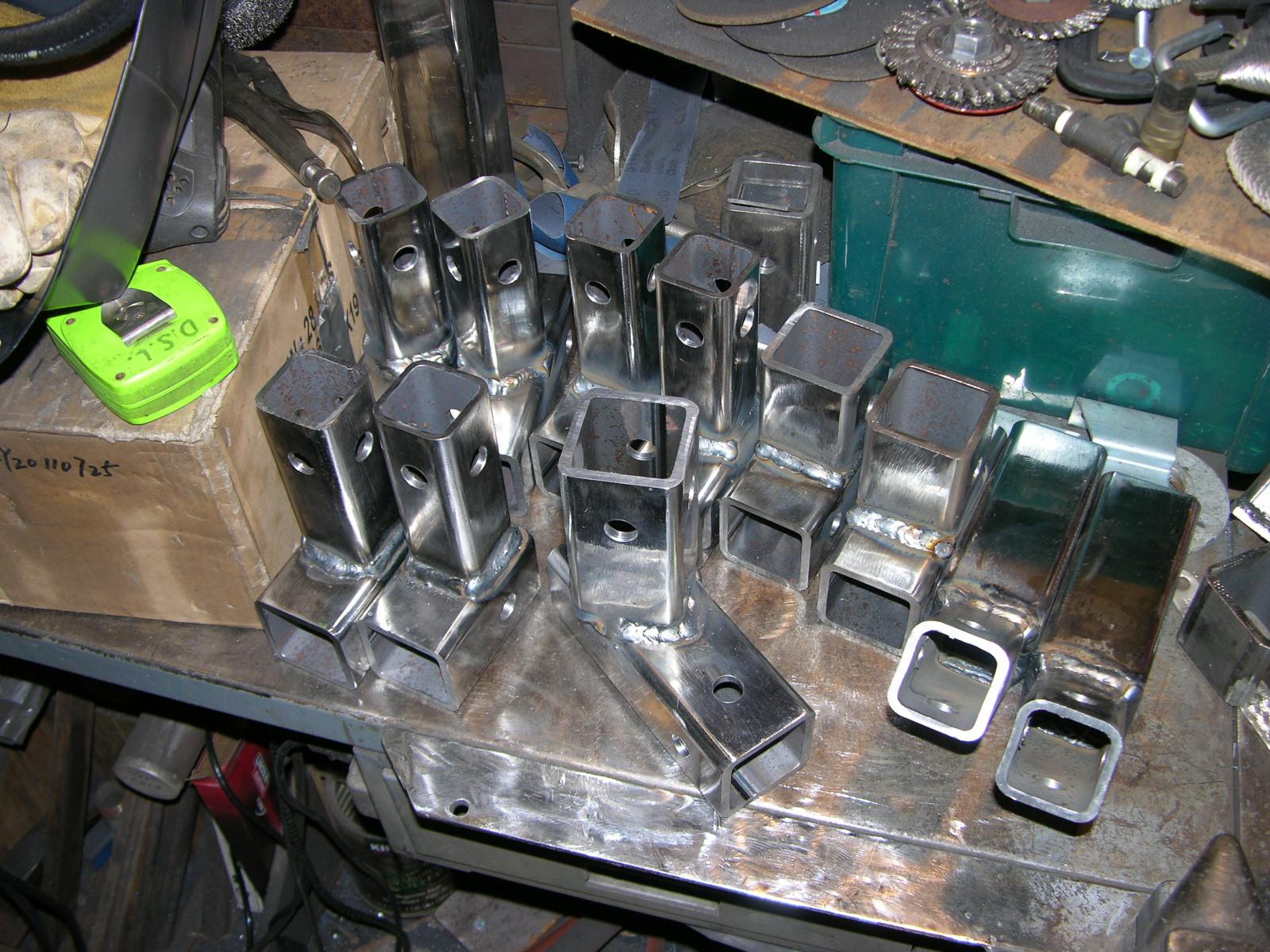

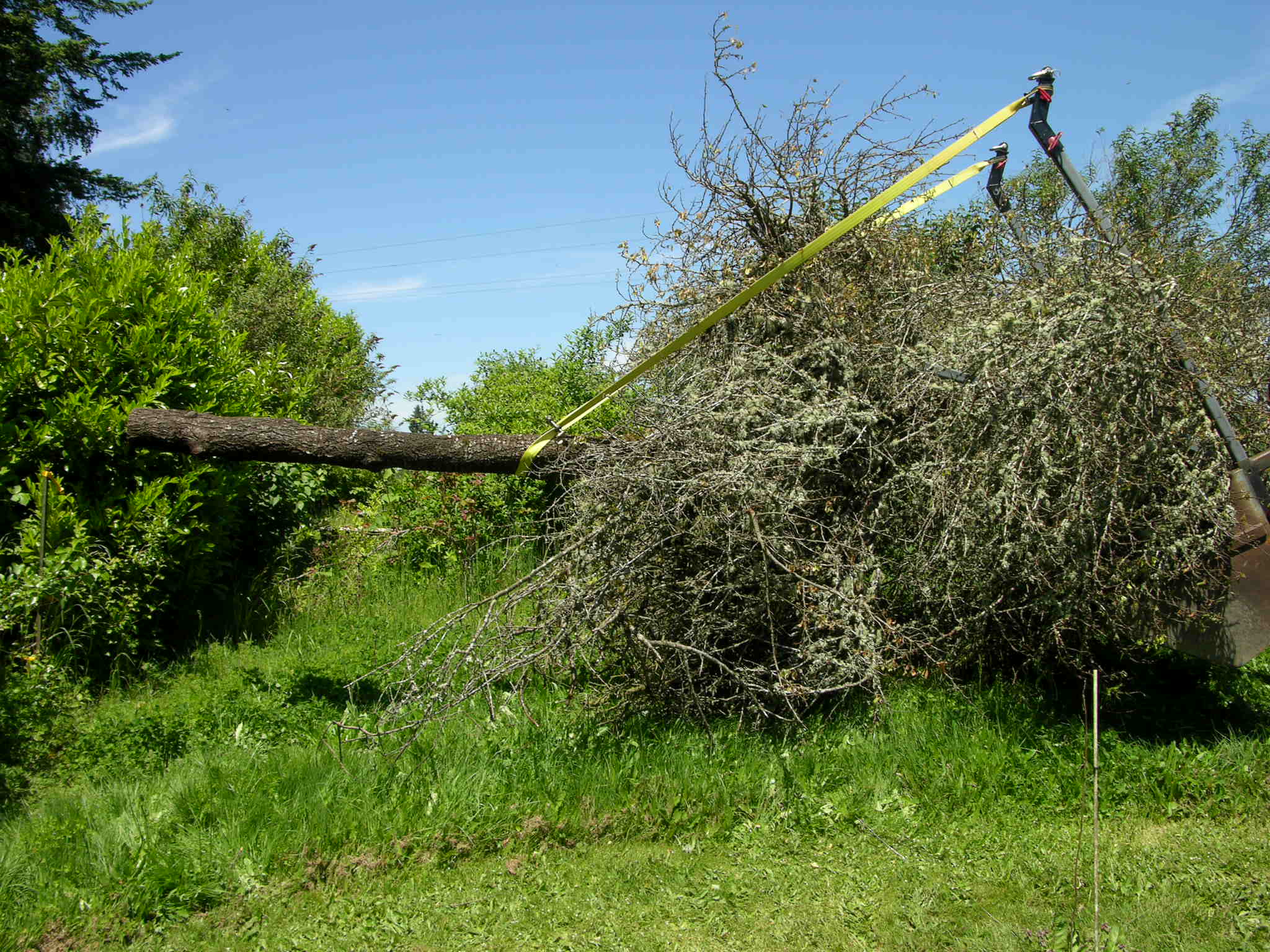

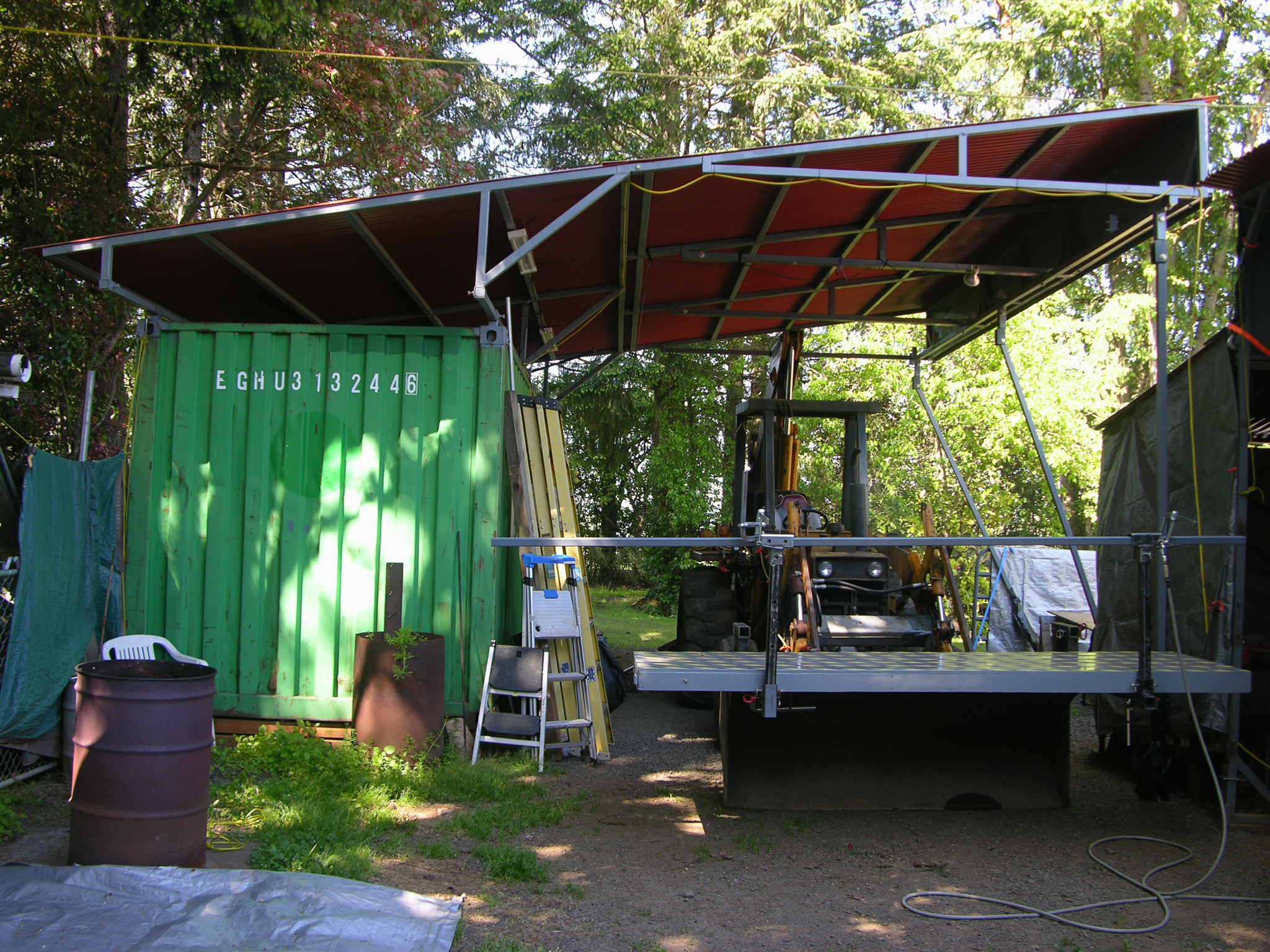

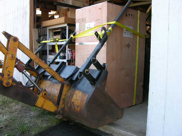

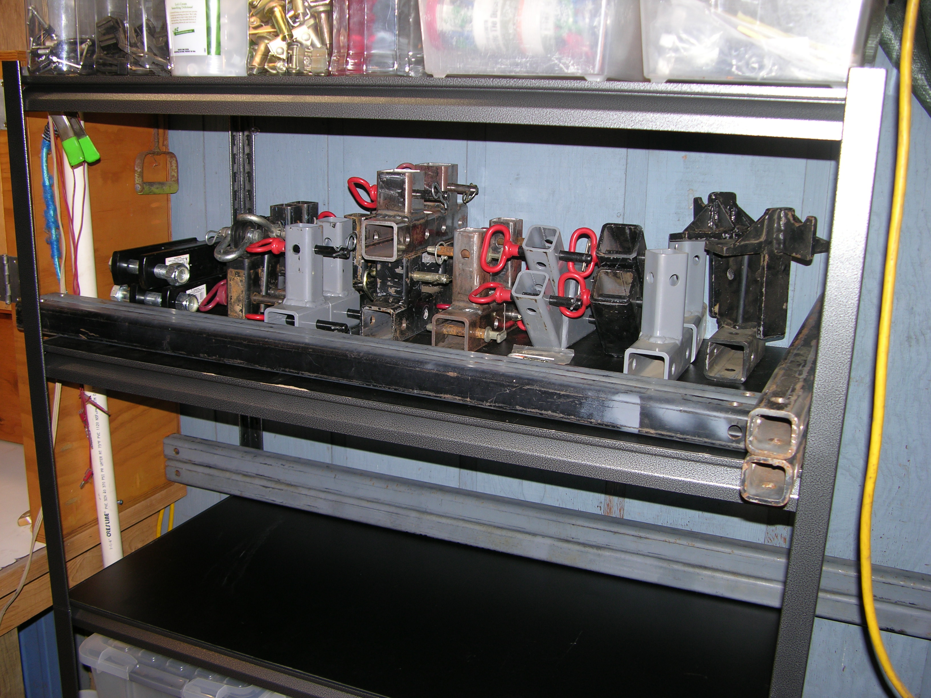

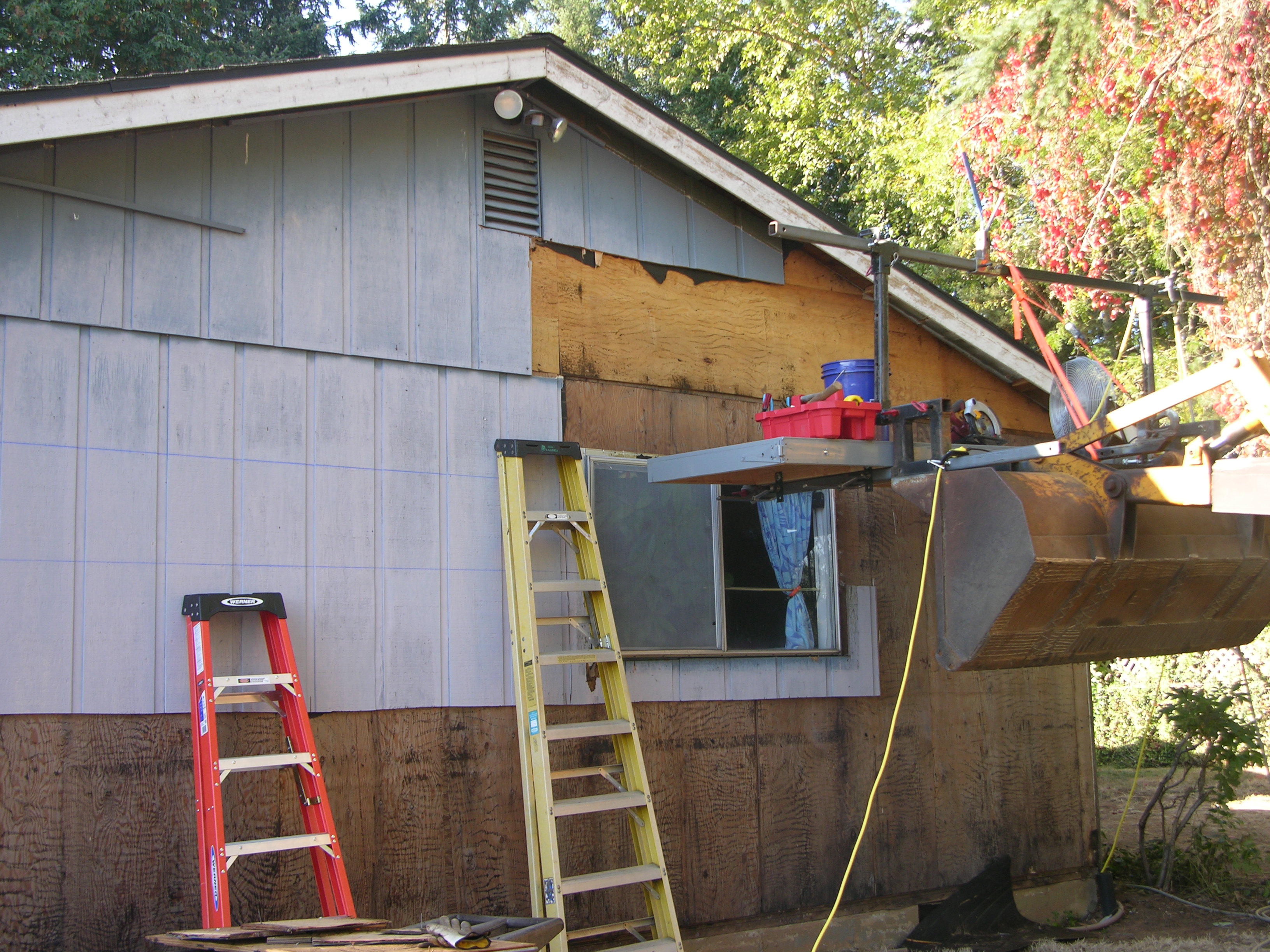

and James, (since my old 580B isn't gonna see a "full restoration" in MY lifetime) my solution to the backward/forward conundrum was to develop my own set of "tinker toys" (eventually I'm planning on starting a thread showing ALL of 'em together) - the heart of the system is the 7 2" recievers I welded to the loader bucket (yes, seven; over/under pairs at each outside corner, 2 more inline with loader arms, and one centered on a piece of 10" channel that bridges between the mounts.

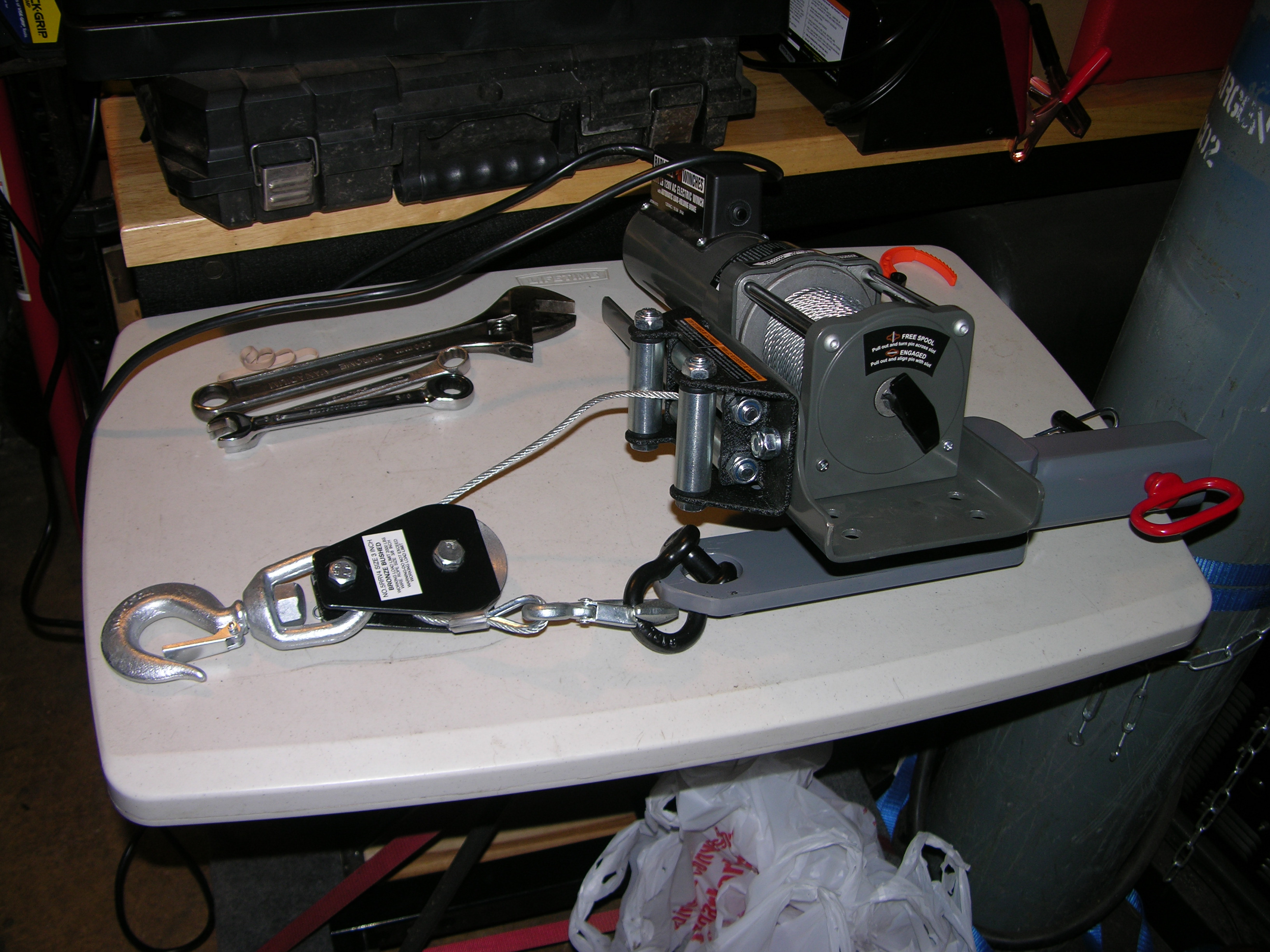

All but the two inline with the arms can be used front, back, or both. The "system" so far includes various male and/or female adapters in straight, tee, 90 and 45 degree, etc, plus a pair of 1/4" wall extenders in 30", 48" and 72". Also a small winch, various hooks, shackles, chains and straps. A few pics -
Moving 1000 lb. mill DSCN1356.JPG Couple of grab hooks DSCN1994.JPG a batch welded DSCN2221.JPG
Work platform for roof DSCN2801.JPG Pre-rig for tree move DSCN2810.JPG DSCN2811.JPG Mostly on shelf DSCN2875.JPG small winch DSCN3135.JPG Pole light replacement DSCN3142.JPG 3x10 work platform DSCN3439.JPG
Sorry I got a bit OT, I REALLY need to do a tinker toy thread :rolleyes: ... Steve

Cool platform Bukitcase:thumbsup:Kinda reminds me of my house frameing days when a work platform was a skid of plywood on a lull . Not for nothing , but isn't that a scissor lift in the picture of the bucket . Just saying.:drink:
   / which forged 3/8 hooks? #38
"scissor lift in the picture of the bucket . Just saying"
I wondered how long it'd take for that to come up :D
Yup, and just behind where the camera was for that pic, there's also a 50' boom lift - BOTH are just "projects" til I get around to doing some work on 'em. On the scissor lift, even if it was a runner it's definitely NOT as "off-roady" as the backhoe, and there's more than a couple "un-level" areas I need altitude. the scissor WILL get used when I build my next shop, a 48x60x16 - IME, there's good, better, best and crappy tools for ANY job. Eventually, I'll figure it all out (maybe)
Meantime, my "tinker toy set" lets me figure out ways of surviving a BUNCH more tasks than I would without 'em, so def. worth the time... Steve
