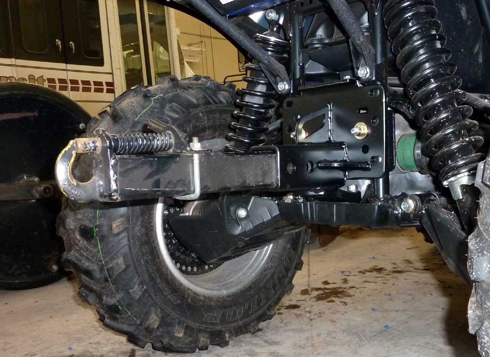

Silly question for you smart guys. I ordered some 3/8 forged weld-on hooks and used them on the black painted part seen in the below photo. I subsequently needed more and ordered the same off of Amazonie and got the straight style of hooks that are for holding chain, but they don't work in this application. What are the black painted type of hook called?? I can't seem to find them now!

Its a normal 3/8 hook, only difference is the chain might slide through it since its more open at the top. Nonetheless, this style worked perfectly in the application I'm using them in. I purchased three like this and now I can't find them. They were welded on without any modification. Should have got more! Thanks to all who looked.

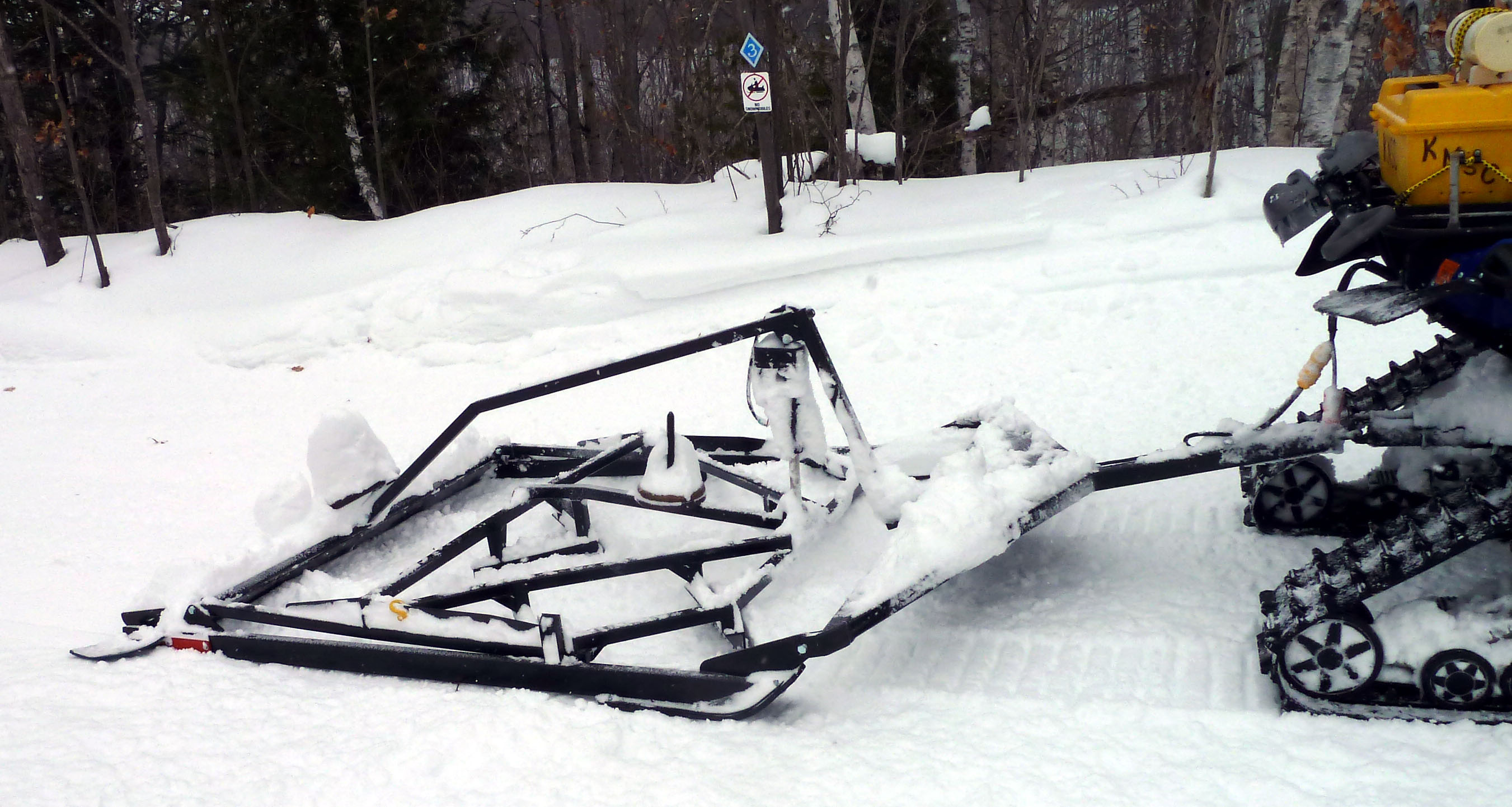

A extended length mini pintle hitch which are only used within the XC grooming world. I'll try find a photo of it in use... Found one!

The need to be wider for the implement ring, than these chain hooks are. Here is what the original hitches looked like made from a slip hooks, but they took much more time to assemble.

Any old 3/8 forged hook with work, but I'm trying to find one that requires the least amount of modification, ak cutting and grinding. The one I showed in my 1st post required no adjustment at all.

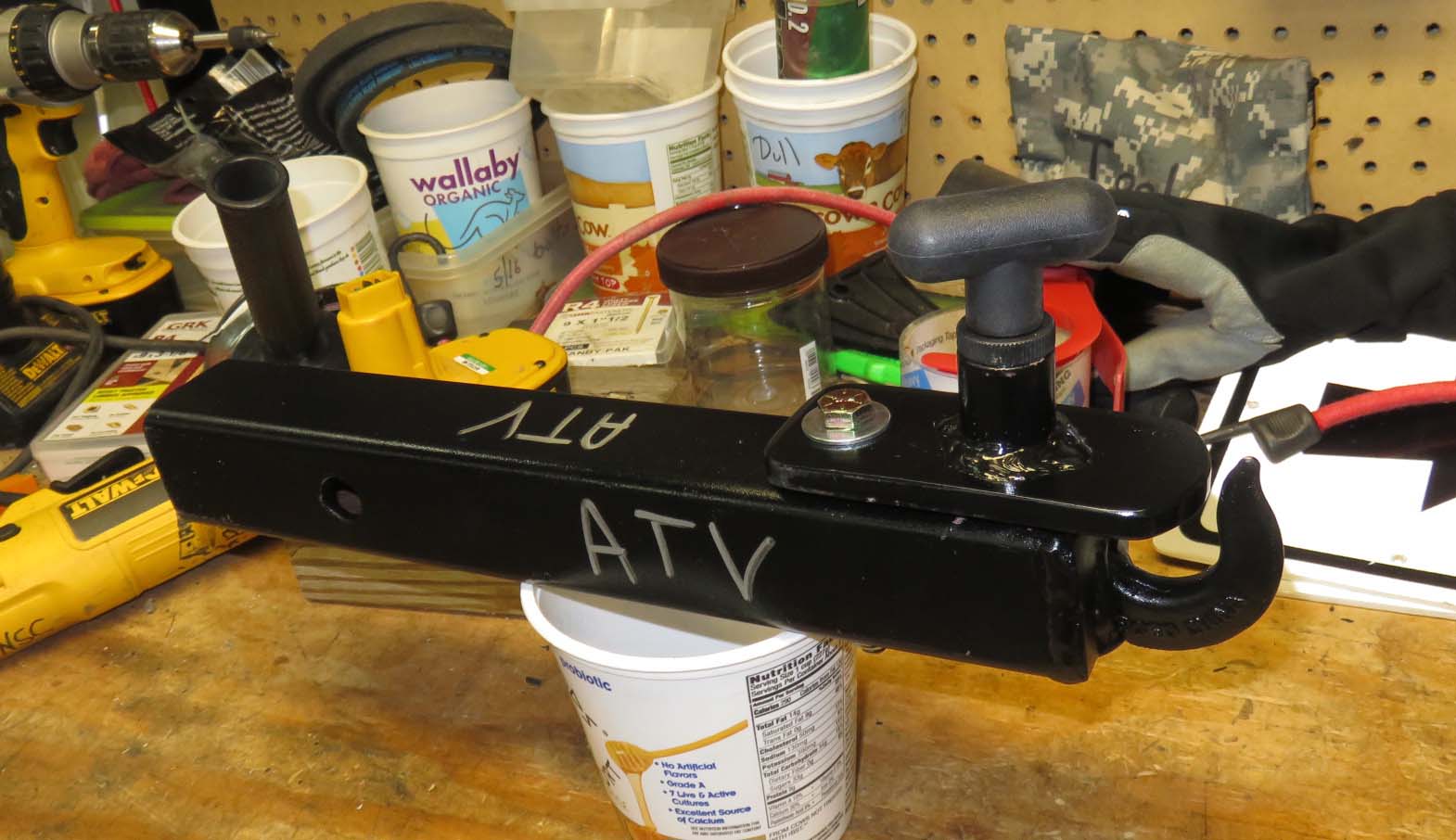

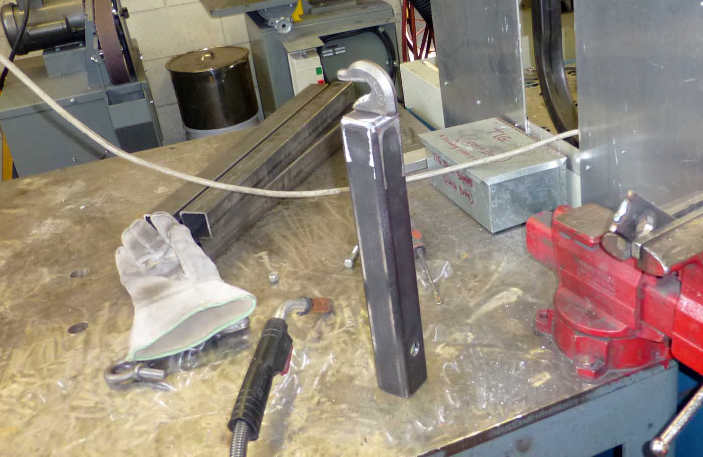

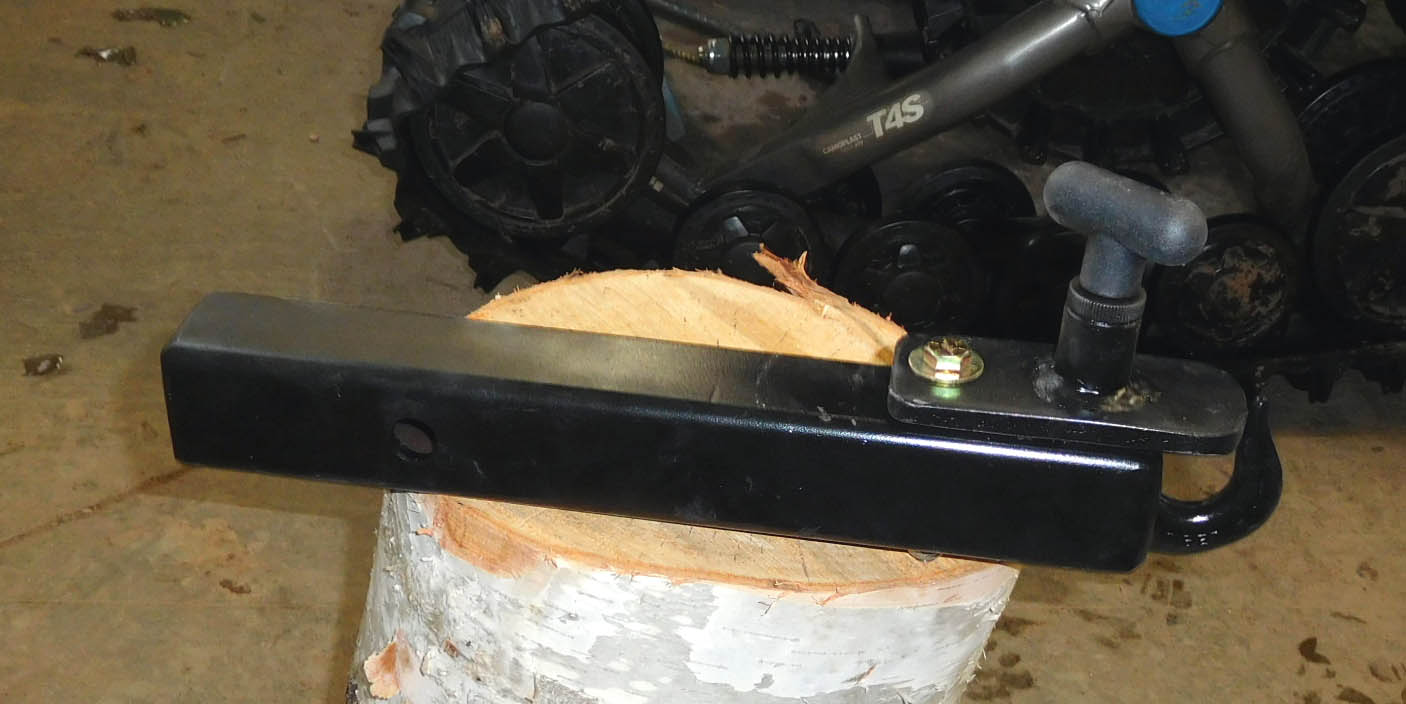

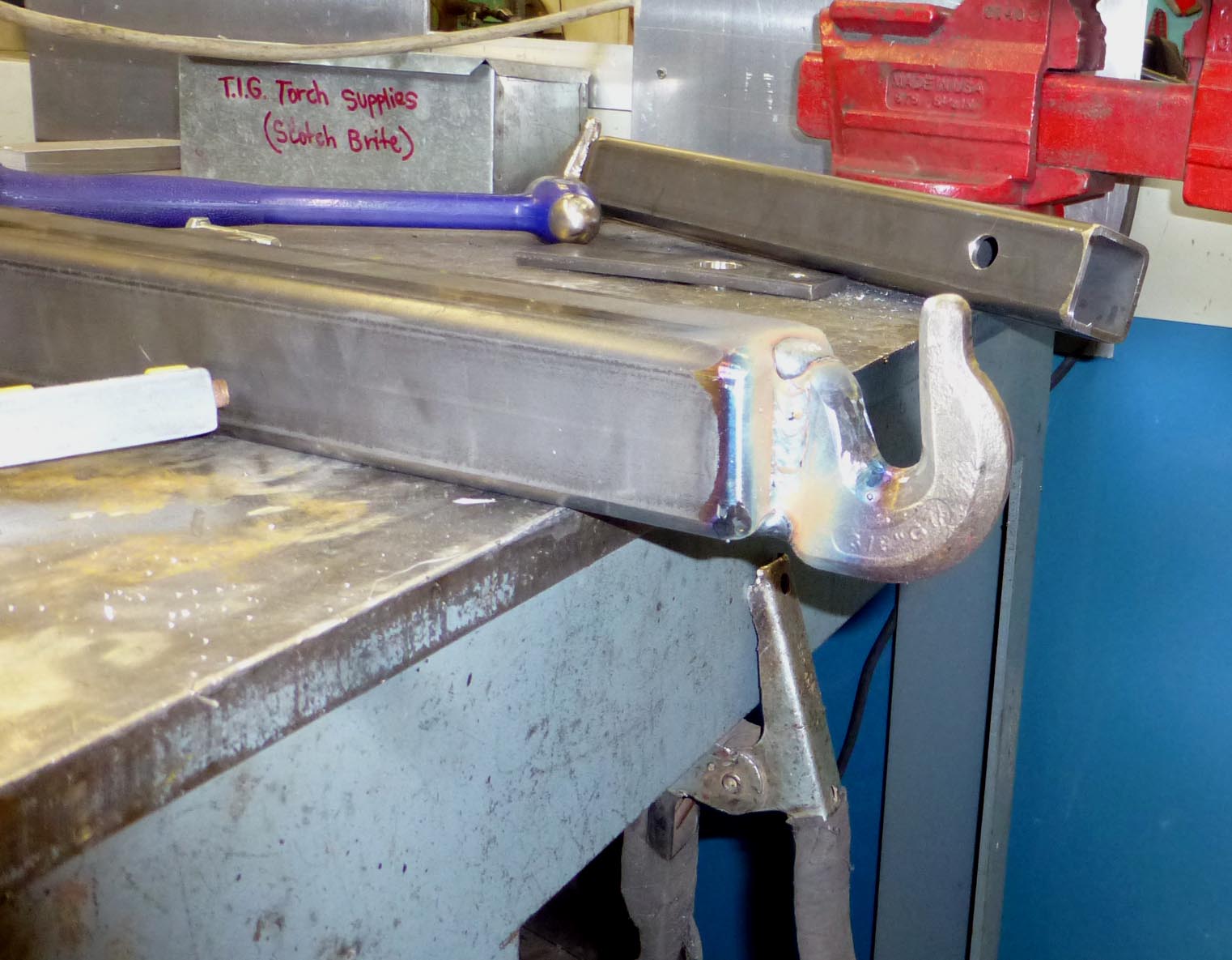

Here is the hitches I worked on today. 1st one shows the hooks I need to cut twice, then grind down so they properly work. Then is photos after they are welded.
Bonus question, Can anyone see what wrong on the hitch, in the 3rd one? :laughing: These are you basic 2" receiver type of hitches.
