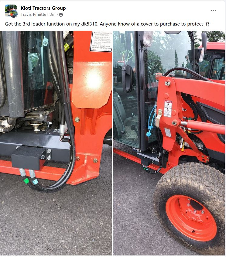

For example, this is a factory Kioti kit. I have heard many displeased with the valve location/hose routing on those..
Travis
/ Which 3rd Function Kit to buy for Kioti DK6010SE?
#9
Travis
I have to watch it again but I think the guy in the YouTube video I posted swung the hoses upwards and installed the shield upside down. Still needed a cover to protect the top and keep debris from falling in.
/ Which 3rd Function Kit to buy for Kioti DK6010SE? #10
Travis
Sure looks like an easy fix would be simply flip the cover 180 degrees and run the hoses up instead of down. The point of the cover is to protect from stuff coming the ground, like sticks, branches. Not from an hail storm coming from above.

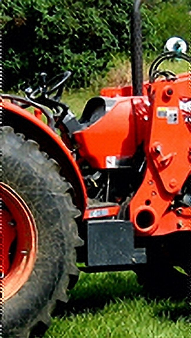

Well - POO. I'll post a pic to show where the dealer installed the WR Long on my tractor. It's attached to the vertical post on the FEL. It's on the inside and up high and safe. For this pic - I'm sitting in the tractor seat - looking forward.

The OEM 3rd function kit as shown in the picture referenced has the hoses and protection plate mounted upside down. When installed in the correct orientation, the lines come up and immediately out of the way. In addition, the included protection plate is also upside down and once flipped, will protect the connections at the new valve. Kioti dealers have a large margin on the 3rd function kit - so it pays to have a good relationship.
/ Which 3rd Function Kit to buy for Kioti DK6010SE? #13
Different tractor - different mounting methods. The " top protection plate" on mine is the floor plate. All connections are well under this plate. There is also a large metal "box" under the floor plate that protects the connections from anything below and to the side. Here you can see that box. This "box" extends well beyond the hydraulic connections - almost to the center line of the tractor. Sorry - all my resizing and cropping has made this a rather cobby image.

/ Which 3rd Function Kit to buy for Kioti DK6010SE? #19
I'd recommend the Kioti DK 3rd function kit. I just picked one up for my DK4210SE Cab model and it is the same one that you will need. If you watch that video at the beginning of this thread, you will see how easy it is to install and how integrated it is. Shame on the EA guys for purposely posting a pic of an incorrect install with the lines going down. Watch the video as he almost makes that same mistake. When installed properly, the OEM Kioti kit is easily the most integrated/protected kit and IMO has the best (OEM) loader handle with the integrated open/close buttons. I picked up my kit for $864 and I'm sure the dealer was still making a profit.
