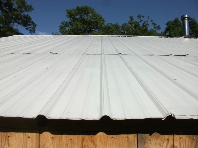

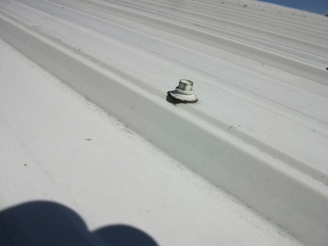

This is the most important difference between using screws or nails in the flat:
When you nail in the flat the nail bends the metal down around the hole creating a funnel shape that will direct water down the hole if the nail becomes loose.
When you screw down the flat, the screw pulls the metal up around the screw making a dam around the hole and if the screw becomes loose much less water will be diverted into the hole.
If you ever pre-drill holes, make sure that the drill bit is a couple of sizes smaller than the screw so that it will pull the metal up around the hole.

So we have a consensus, screws are better than nails. :thumbsup: Just to clarify my comments on fastening through the rib I have attached a few pics to make sure we are all talking about the same thing. Since I have had no failures in the 20 years I have been using this method I will stick to it. I do tend to use a minimum of fasteners when doing a roof as you may notice just to minimize the penetrations but I would fasten on the flat if I was doing siding. Bottom line is that if your roof don't leak you must have done something right, :D however you fastened it................
