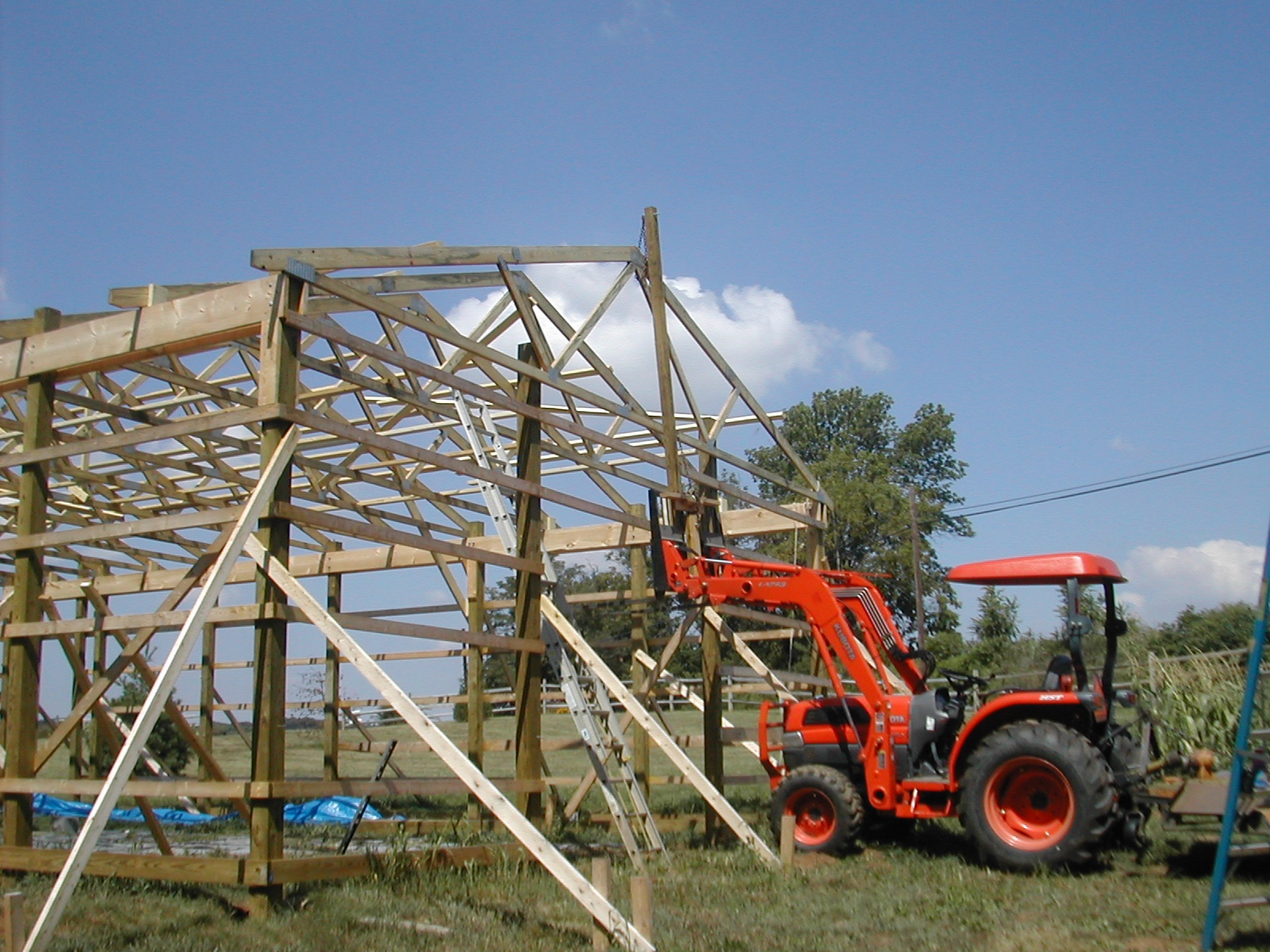

Similar to Buckeye's post but I had to reach over an 8' porch to set 24' trusses at 10' up. The trusses were only about 150# so not that heavy, but awkward and pretty high up. It's a 20' H beam attached to a set of forks.

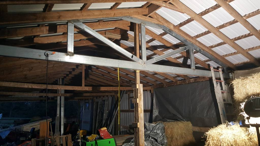

The 25 yr old 2x6 King trusses on my pole barn were sagging and carpenter bee infested. Replaced with built in place CFS Howe truss. I would have preferred a bar joist truss, but that required removing and replacing the entire roof. These should last the remainder of my lifetime. I am in TN, so no appreciable snow load, we occassionally get ice, though. Jacked the ridge beam up about 3" and inserted truss members. Welding next to the hay bales was interesting.
