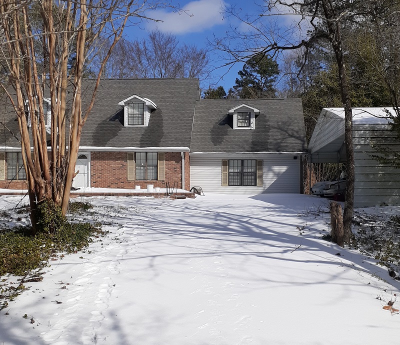

   / Pre-fab trusses for shed style shop? #34

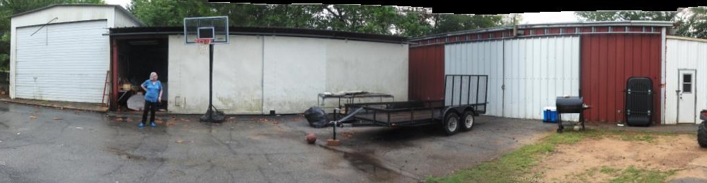

<snip> Be aware that shop meters are charged at a different rate than a residence.
They tried to do that to me. I've a house on a small hill
and about 100 yards away the "shops".
Both have their own meter. One of the buildings in the "shops" has a kitchen, bedroom, and bathroom w/ toilet sink and shower etc. They started to charge us at a higher rate for the shops but I argued it was a residence and the power company agreed.
