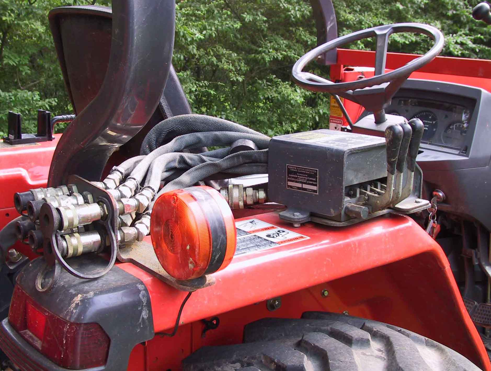

I've never used them, but here they are, on the right fender of my L35.
-Dave
   / Where to Put Rear Hydraulics Levers #4
Heres the same image for those without the bigscreen monitors!
