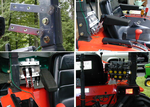

   / Where to Put Rear Hydraulics Levers #45
I finally settled on a placement for my TnT controls. After investigating the electric operated controls, I decided to stay with the manual valves and placed them between the ROPS bar and seat. They are on an angle to improve the position of the control handles (it actually came out quite well from what I can tell so far despite no real experience using them yet). The hoses going to the cylinders all have quick disconnects and the couplers are attached directly to the valve body. This eliminates 4 hoses and a mounting block of some sort that would otherwise be required if the couplers were mounted separately from the valve body. The valve positioning results in the couplers pointing out the back of the tractor and down at an angle to shed water. The whole assembly is on the inside of the ROPS bar so hopefully it will be reasonably protected from attacking branches while bushwacking. The valve control handles are still susceptable, but I can't see any way to improve it sort of using electric valves or having pre-configured slots like on the grand L's.
The actual attachment to the ROPS is using straight bars that I got at the local HW store. I cut them to length and welded them to the ROPS bar. This position for the valve required moving my flasher light from the fender mount holes on the inboard side of the ROPS bar to the outboard side using mounting brackets. The 2710/2910 can be built up either way and my dealer happened to go the fender mount route. I visited the guy who assembles the machines and as suspected he had a box of the brackets and gladly gave me two along with the plastic plugs to fill the fender holes. The flashers will be more vulnerable to branch attacks, but what else is a tractor nut to do?
So far so good, but I still have to connect the hoses and figure out how to tap into the return line to the tank.
Photos attached in collage format inspired by Harv,
Peter
