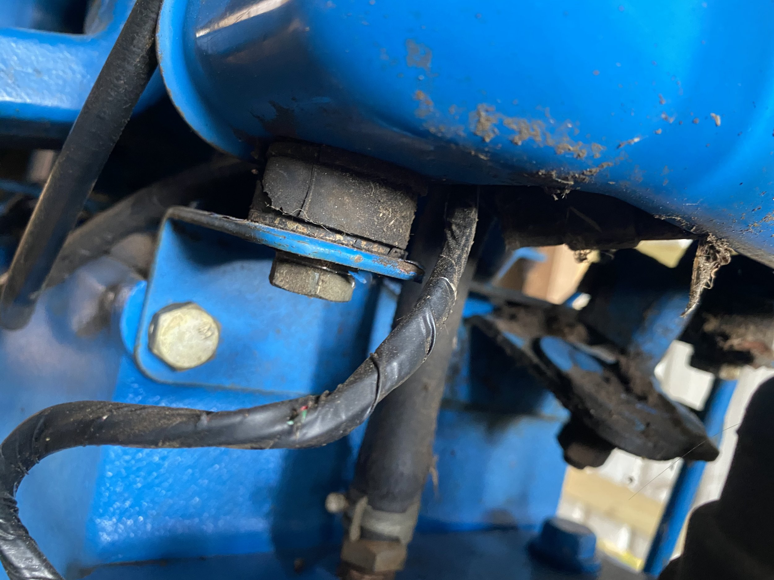

Does anyone know where to find a washer like this

Better picture about the size of the washer.
Good hardware store or machine shop might help.

A washer like what, exactly? The easy answer is any hardware store. Take the old one with you for comparison. If you need more information you should state the diameter of the hole in the center and the outer diameter of the washer. Thickness may be helpful, too. Is it a plain round flat washer or is it bent in some special way? Do you want just a flat washer or a lock washer?

I’ve been to all of my local hardware stores but they don’t have them I believe I’ll have to special order them

Try shock bushings or track bar bushings

I just replaced those mounts on my 1710, dealer wanted near 50 bucks each! I found rubber isolation bushing that work for that purpose on e-bay. Only difference is they have studs and are a slightly taller.

Thanks man that’s actually very helpful I’ve been looking everywhere are you able to remove the studs

No, you can't remove the studs. I couldn't find any mounts similar to the originals especially in metric.
I used them and installed a lock washer and 3/8-16 hex nut. When tightening them up, try to hold the metal part of the mount to avoid damaging the mount.

durometer 40A is a softer rubber than 50A

Just use a shock bushing and cut it if you need to. Any parts store should be able to source one. Tell them you need upper shuck bushings for a 2014 Wrangler if they need a make/model/year.
Go to Amazon and type in "front shock bushing" and you'll see lots of options that can easily be cut down.

I’ll try that
