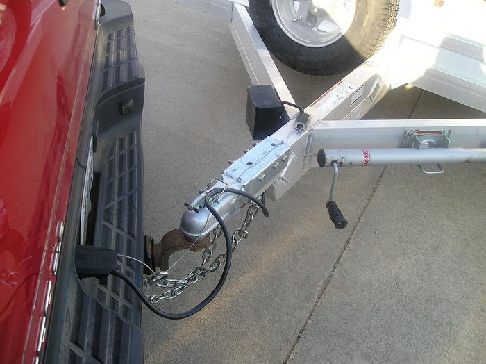

/ Where do you attach the break away cable? #8
I wrap the cable around the bumper and hook it back on its self with a carabiner.
I bought my trailer new and the pic shows how the dealer did it. But I don't like the way he ran the power cable so I just let it hang. I think he was afraid it was to long.

/ Where do you attach the break away cable? #10
I think the way it is in your picture looks good, that's what I do with my break away cable as mentioned in prev post. I don't put my electric cable in there, but in your pic it looks nice and neat and less chance of snagging it. I would do as your dealer did as long as it's not binding and pulling out or chaffing etc.

/ Where do you attach the break away cable? #17
The error in that is I have seen 3 hitches totally fail. All 3 broke at the receiver tube welds. Mine was due to me overloading it, my fault. The other 2 were due to internal rust and they simply broke.
I would attach it somewhere totally independent of the hitch itself.
Chris
That is why I do it like I showed in the picture above. If the trailer hitch totally fails I want it to hurt me and NOT your family because it was more than likely my falt and not yours.
