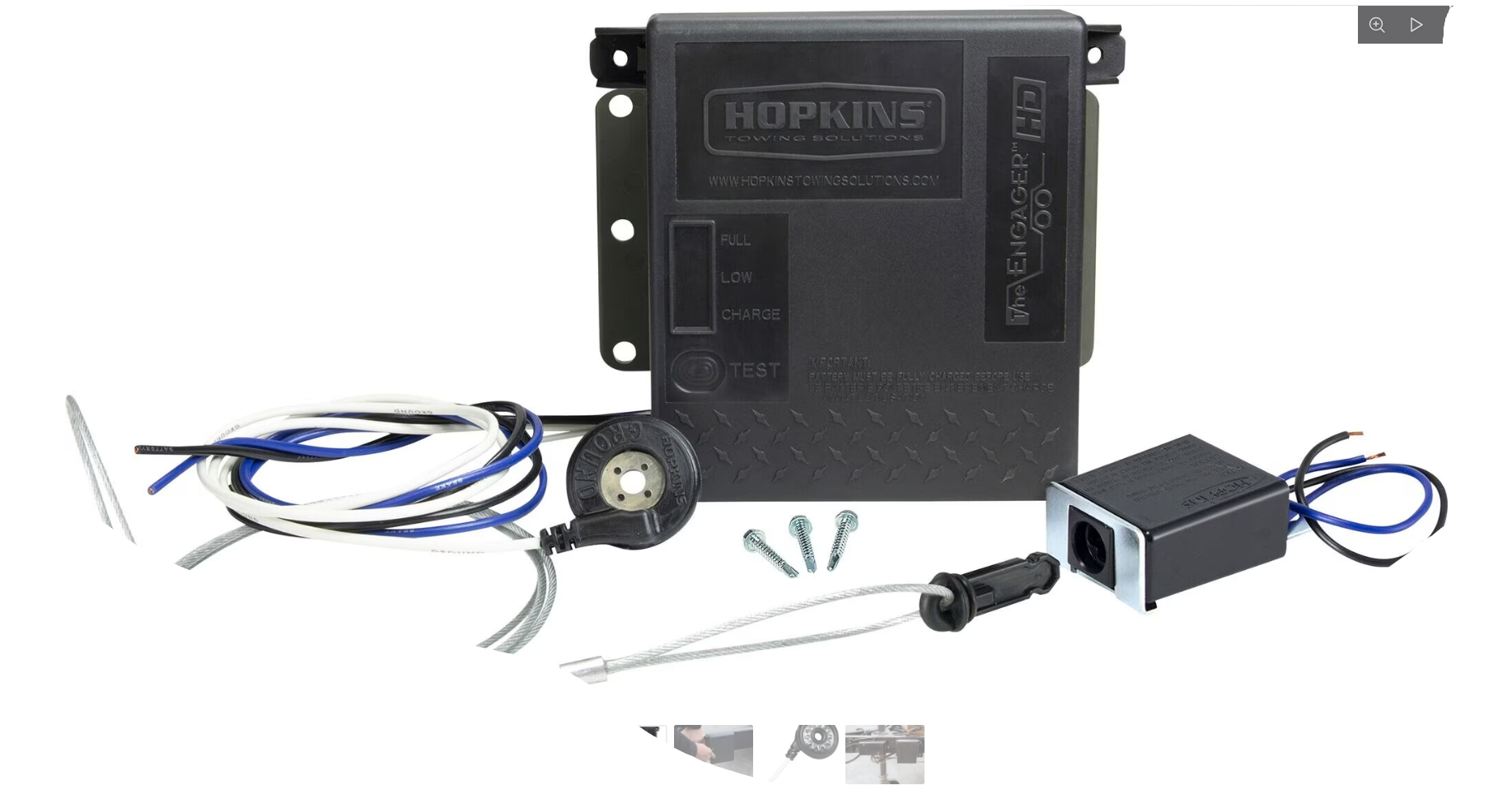

The LED display on my break away box is getting pretty rough from exposure to the weather. When I used it last week or so, one of the wires broke off of the sealed charging circuit. So, I think I will just replace the whole box. The trailer mostly sits so I remove the 5 AH battery and put it on a trickle charger in my shop so it is always charged. My current box is a top loader and it is tight to remove and replace the battery. That likely contributed to the wires breaking off of the charging circuit. I am thinking a side loader may be work better? The four year old battery is still good but I can give that to a neighbor that tows a lot. I would like the replacement to have the LED's on the side also.
What brand would everyone recommend?

I've got a Hopkins on mine, never had a lick of problems, comes with the battery and has the LED's on the face of it. Trailer can sit for a month or more at a time in the summer as it's main use is hauling a 1100L water tank for my daughter. Battery's 4 years old and still going, mind you I take it off in the winter when I'm not using the trailer and put it on a maintainer. CAN$100 here at Princess Auto

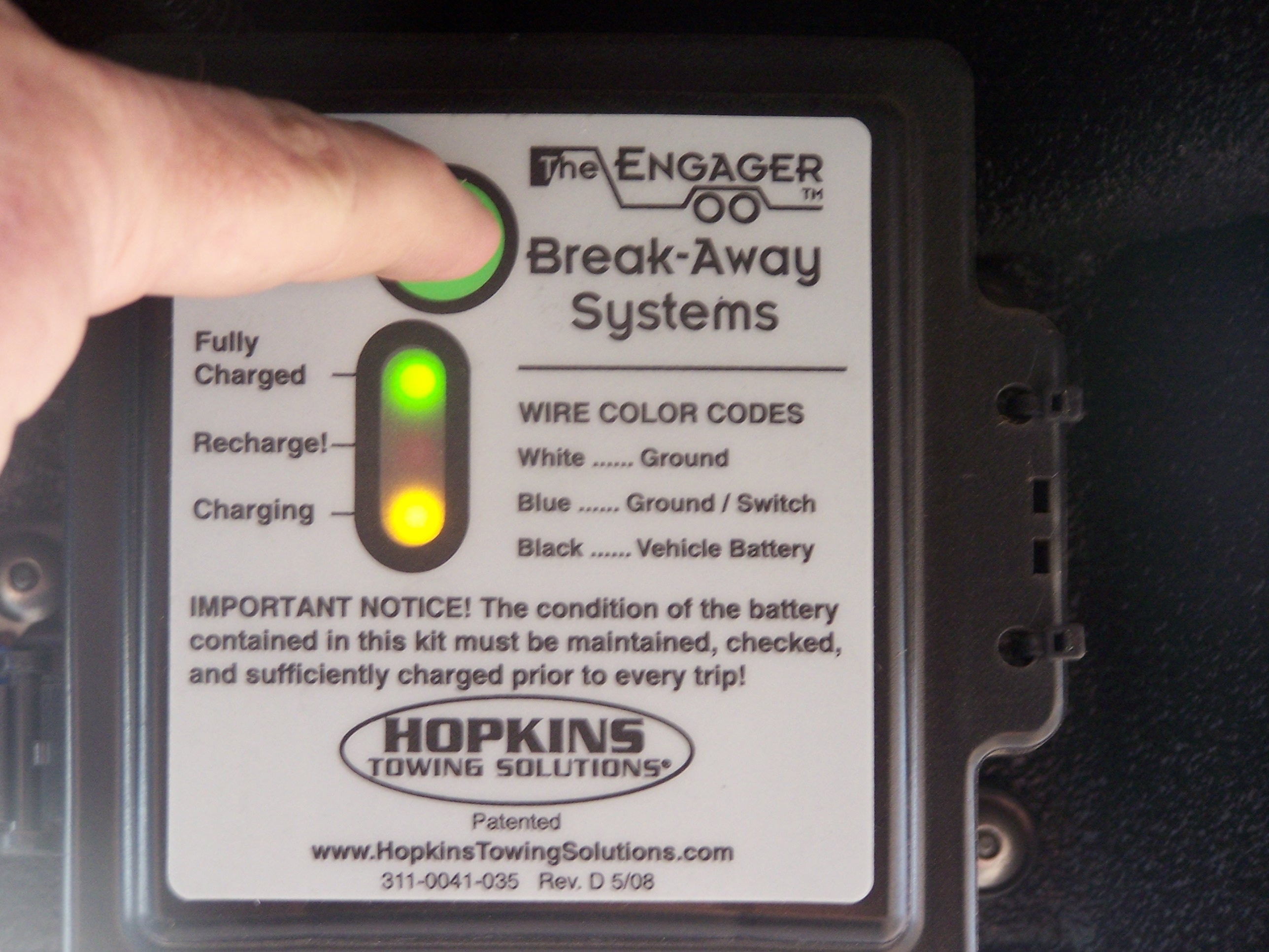

I second the Hopkins brand. Here is one of mine. I like the push to test feature. It is easy to change out the side load battery. All 4 of my trailers that have break-away systems also have batteries for either hydraulic pumps, a winch, or interior lights that keep the small battery charged.

Hoping the group will indulge me for a dumb question. If you look at the "important notice" on the unit shown in the above pic, it says to make sure the battery is charged PRIOR to every trip. Given that most trailers sit around a lot, does anyone know of a way to charge this battery while it is inside the unit?
Does anyone make a trickle charger (something like a Battery Tender) that you just plug into the trailer plug to maintain this battery while not in use?
If the trailer has been sitting for a while, I would have to imagine that charging from the vehicle would take some time and that the breakaway system would not be functional until fully charged.

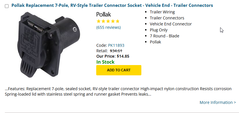

Get a vehicle end connector socket that fits your plug and wire it to your charger.
Sounds like a good plan. I guess just wire the red from the maintainer to the blue (I think that's what trailer connectors use for power) and white to white (ground).

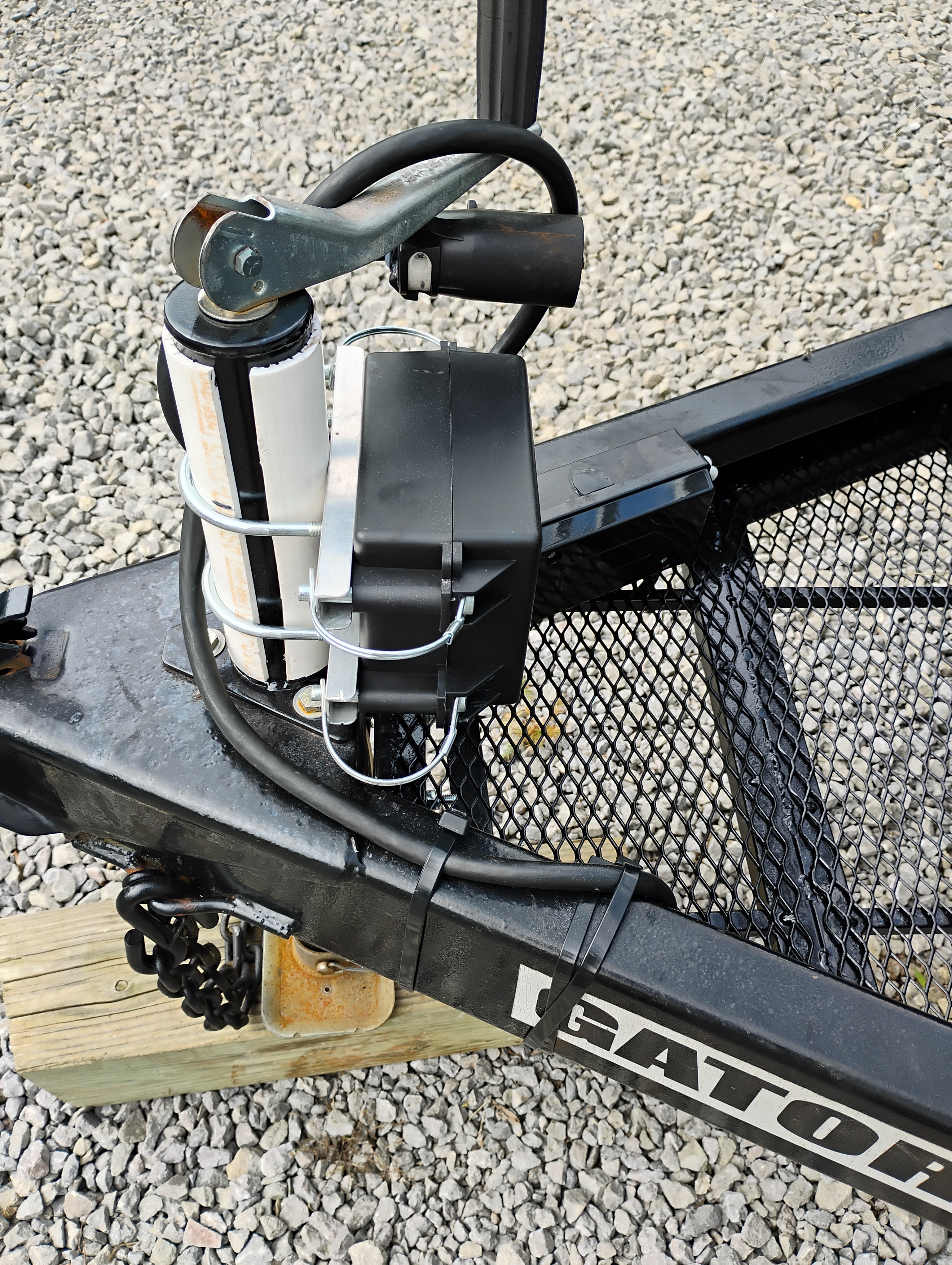

I replaced my battery box/charger with a Hopkins HM20001. I also added a junction box for easily organizing the wiring and to keep from stuffing all of the connections in the battery box.
Because I do not use my trailer much, I keep the battery in my shop on a trickle charger. To make removal/insertion easy, I used the u-bolts that come with the box on a some aluminum U channel then used quick disconnect spring clips to hold everything securely.
