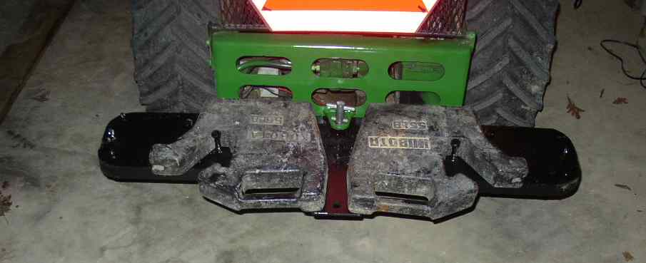

Here is a picture of the bumper with weights on it. I purchased two 55 pound Kabota weights. It makes a big improvement in handling when the bucket is loaded. No PT pucker either.

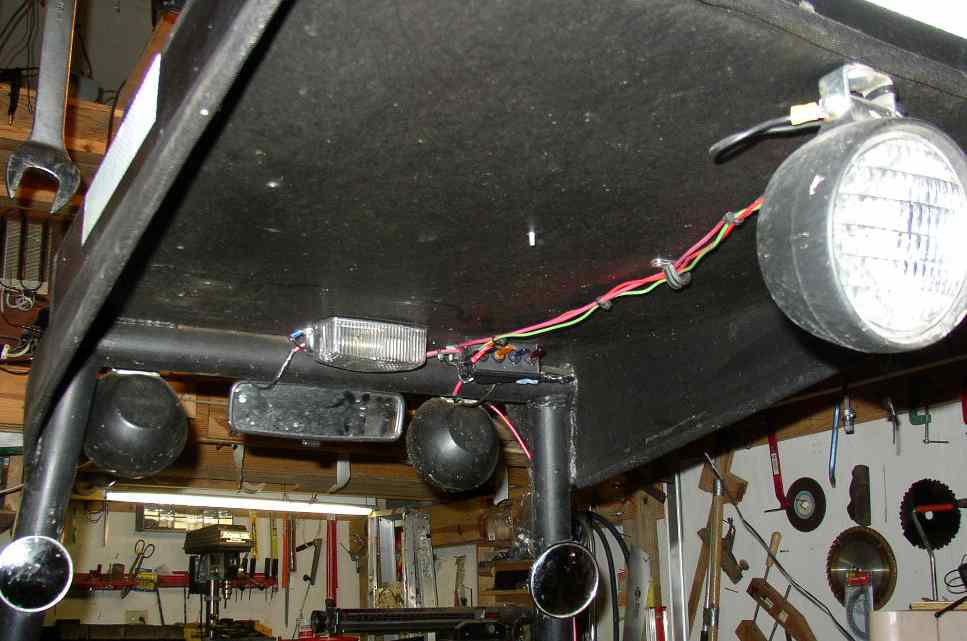

Just a few more mods. This is a picture under the ROPS. It shows the three mirrors, the back up light and in the upper right hand corner are four switches mounted just under the ROP. These control the two front lights (separately), the backup light, and a strobe light on the back of the ROP Rack. There is also a dome light with its own switch built in. I have used this one very little.

What PSI are you using in your tires? With the extra weight in the back to counter the higher lift weight in front you might be exceeding the tire pressure.

I am using 11 PSI
