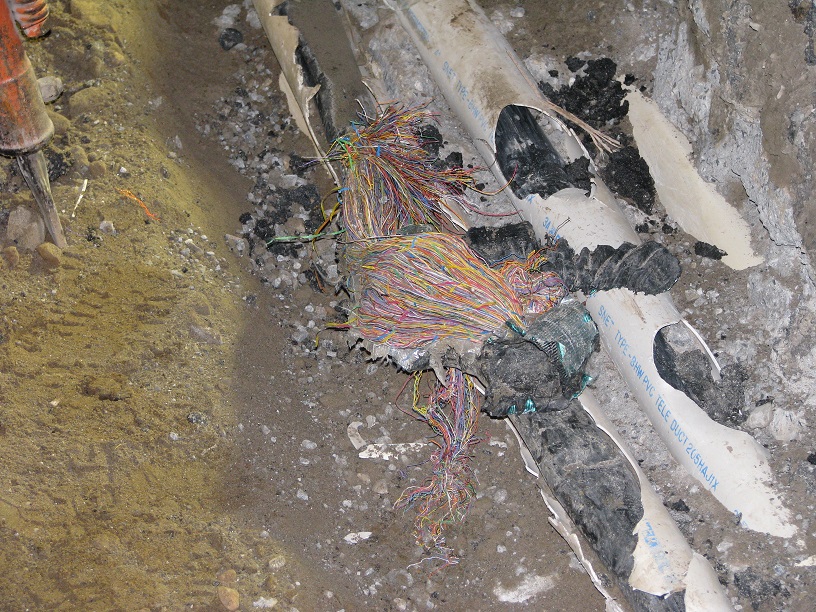

Here's an expensive example of what can go wrong.
