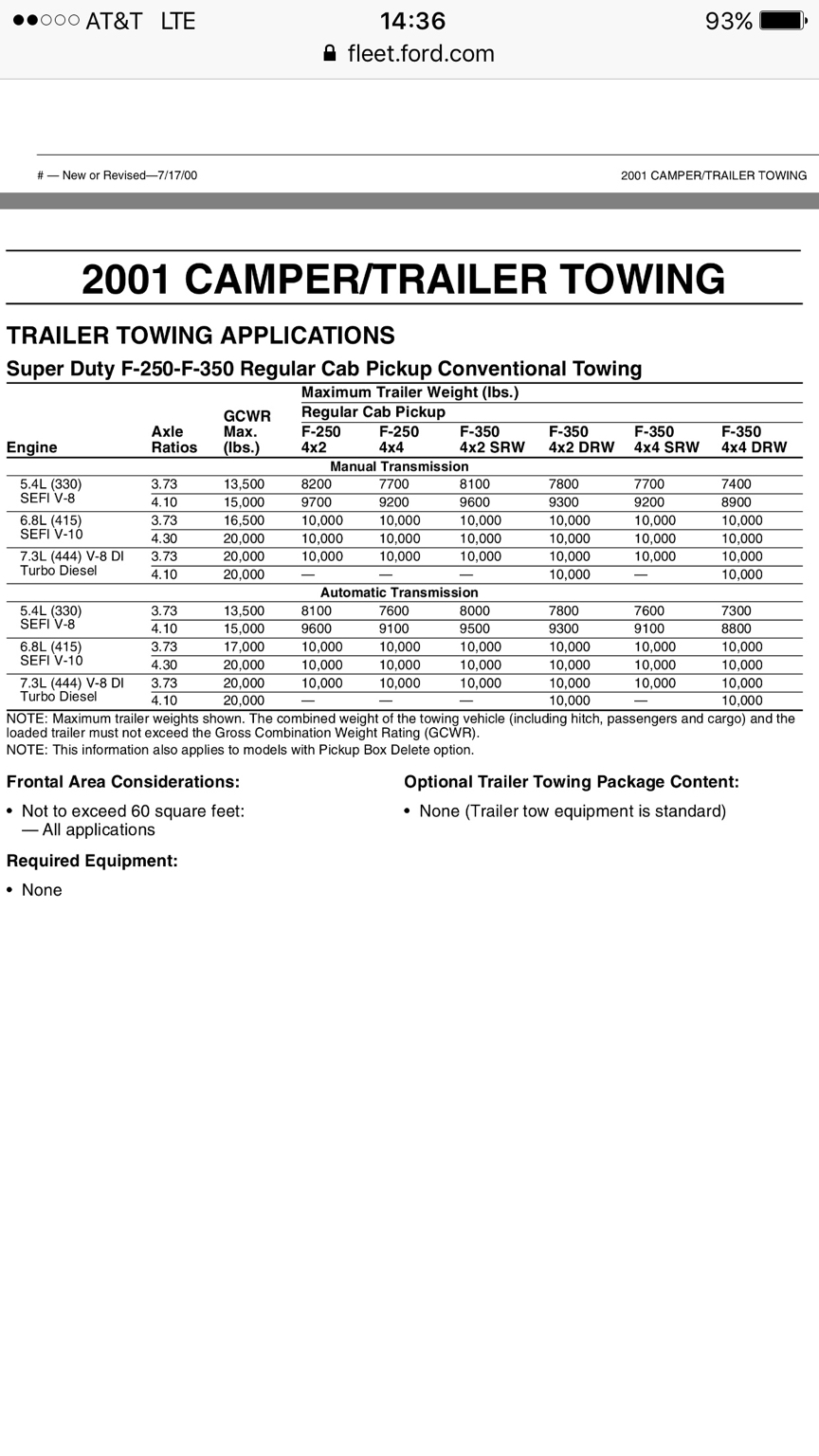

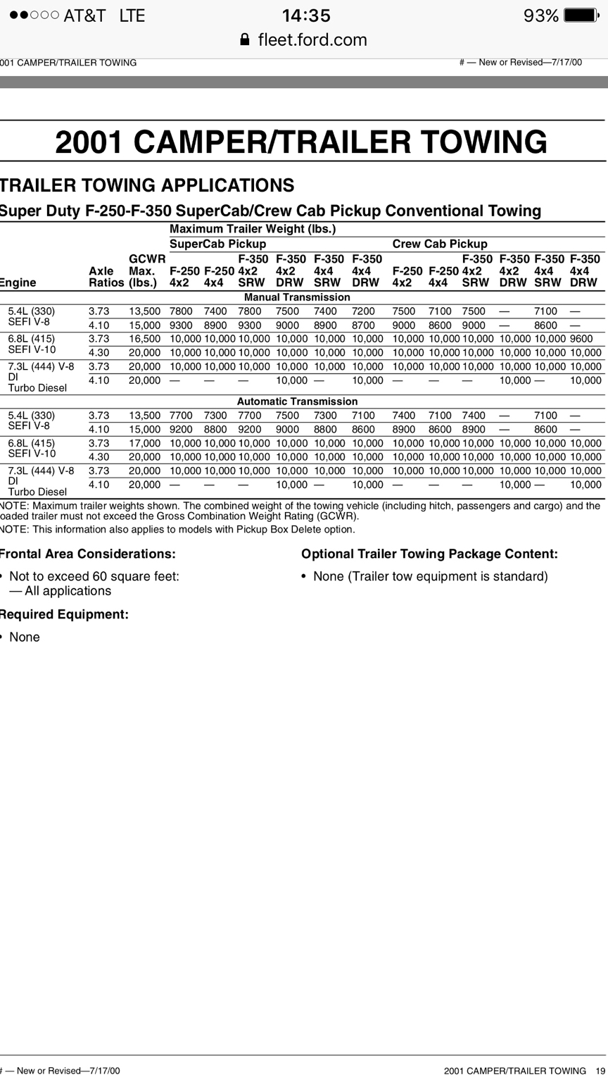

... but out came the portable scales. He had me unhook and put the scale under the jack, then weighed the axles and came up with under 4000...Like I said he check the towing capacity of the truck and capacity of the trailer and me a retired person just hobby farming and needed a few bales of hay. ..
It's good you point this out, I have some friends who think they will only weigh the trailer axles and so long as the axle and tire ratings ard not exceeded you are OK to go.
Like you say, DOT/police can look at the tag on the trailer for ratings but where do they look on the truck to find its trailer towing capacity? On pickups I've only seen tow ratings in the back of some owner's manuals, and it's dependent on things like axle ratios and engine options.
