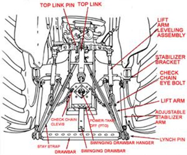

I don't think my hitch has all the features or parts you are talking about and
I think the 3PH in this photo is from a 8N or something old and may not reflect what we have today but I hope it can help clear up terminology.

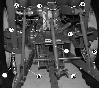

My 3-Point Hitch system
A - Lift Arms
B - Center Link Storage Hook
C - Non-Adjustable Lift Link
D - Sway Link
E - Draft Link
F - Center Link
G - Adjustable Lift Link

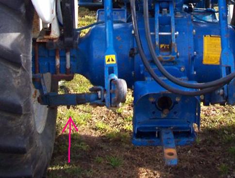

Arrow pointing to mine...

charlesw said:
Did you just run and make that image? :)
No - I got this picture out of the Owner's manual for my JD990

I figured :) Anyway... It doesn't look like you can let that slide. Hmm. Unless you unhook it altogether, or something like that. So JD is voting for leaving the pins in!

From the images posted, sway links = adjustable stabilizers (bars).
Some are chains, some are turnbuckle style, some are bars that slide into each other adjustable with holes and pins. Mine are like the last kind but on the other end of the bar (connected to the tractor axle) there is another pin that goes into a slot that lets that part slide about 1".
So no matter how tight I set the sway bars or stabilizer bars, there is always a little play from side to side. Therefore, I suppose this is important not only when using (working) the implement, but also when lifting or tilting the implement by the 3pt and tilting side links. So nothing breaks off if it is too tight. I say this because during those movements, there's got to be some play to allow it to move or tilt since all the connections are not from the same pivot point.
