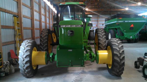

I noticed this on craigslist today. It's a 4560 with wheels spaced at 120". Just try rolling that thing.:)

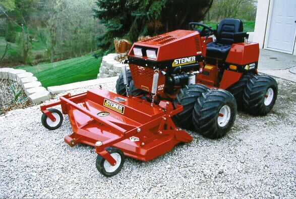

Look into Ventrac and Steiner articulated tractor-mowers, both manufactured in USA. Their primary market is golf courses. They excel at mowing slopes.
https://www.google.com/search?clien...d=ssl#rls=en&q=ventrac+mower&revid=1075671525
https://www.google.com/search?clien...tractorbynet.com&ie=UTF-8&oe=UTF-8&gws_rd=ssl
https://www.google.com/search?client=safari&rls=en&q=Steiner+mower&ie=UTF-8&oe=UTF-8&gws_rd=ssl
If one is going to obsess over mowing slopes, a Ventrac or Steiner is the right tool.

Sat on one once and could not see the front edge of the deck over the hood. Our f932 is great on slopes also. It slides way before it would tip.
Holy wheel bearing stress batman... that's taking things a bit overboard for regular use. I can only assume they are spaced out so far for crop clearance reasons.
