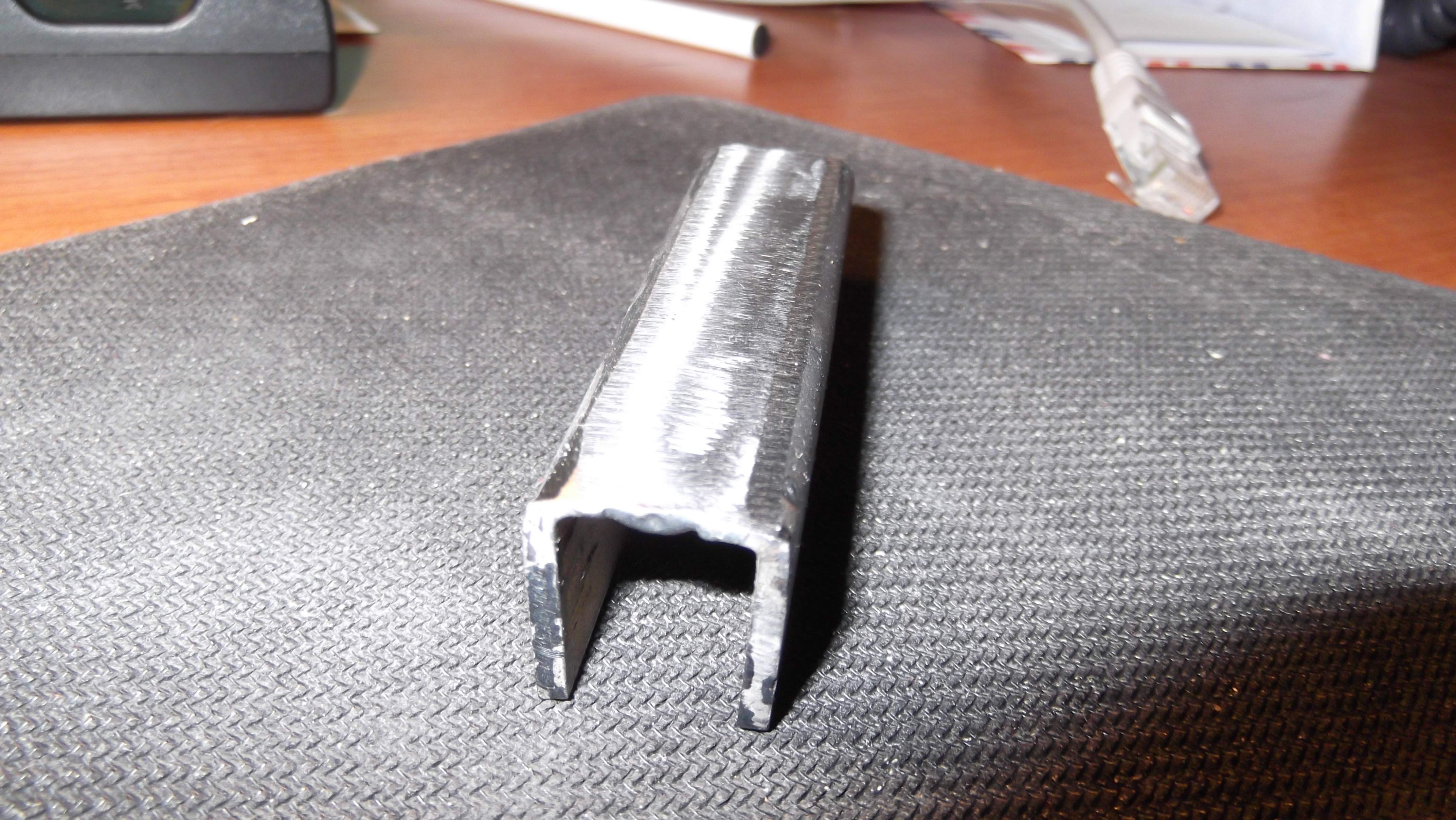

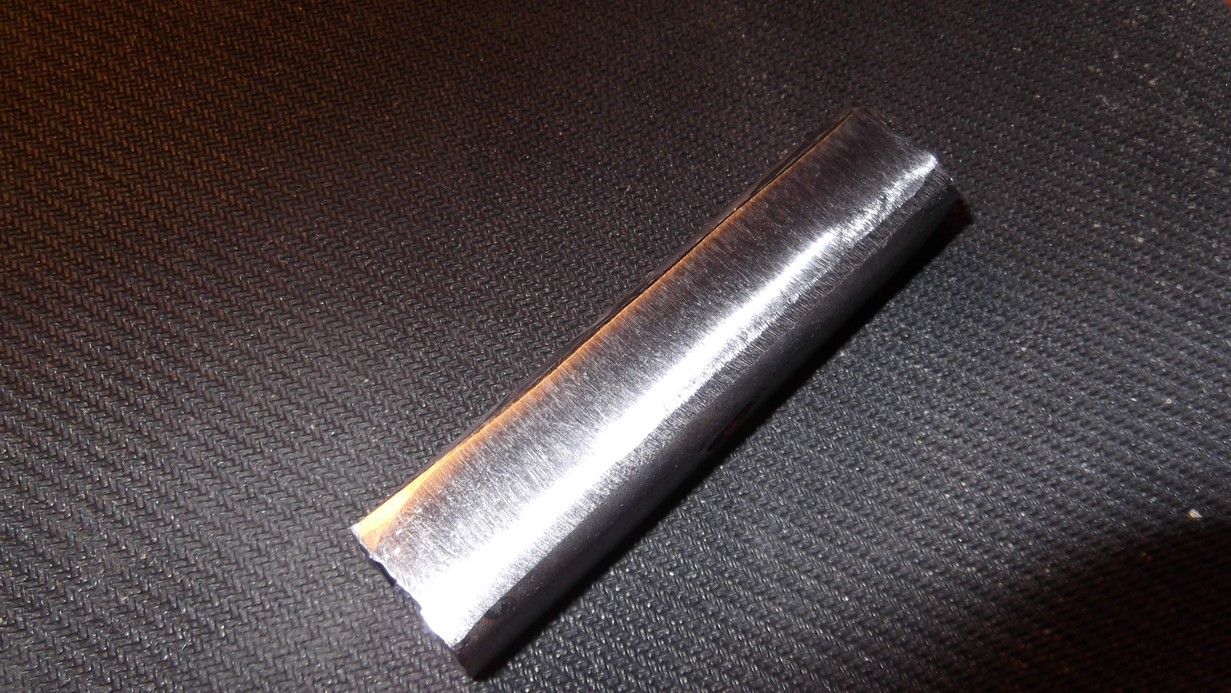

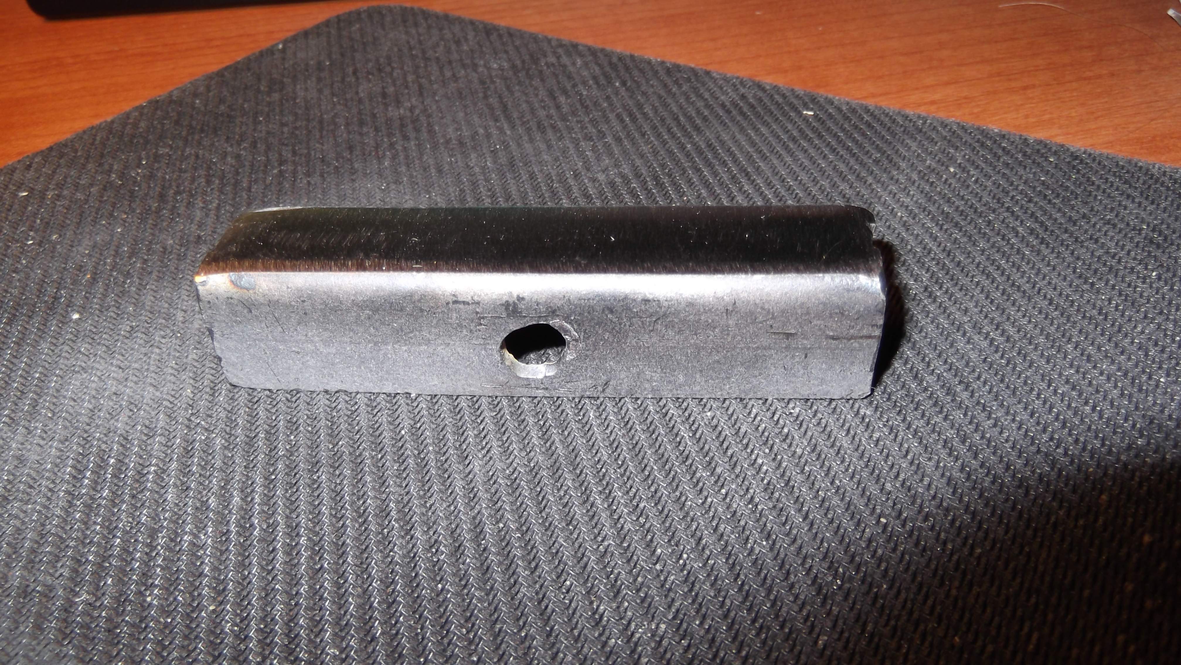

Here are 2 pieces of metal I welded together, yes I did grind off the weld but you can see it is not porous. It is about 14 maybe 16 guage metal. It was Tigged with a 1/16 Lanthanated tungsten at about 45 amps If I remember correctly. the red line shows where the weld seam was.

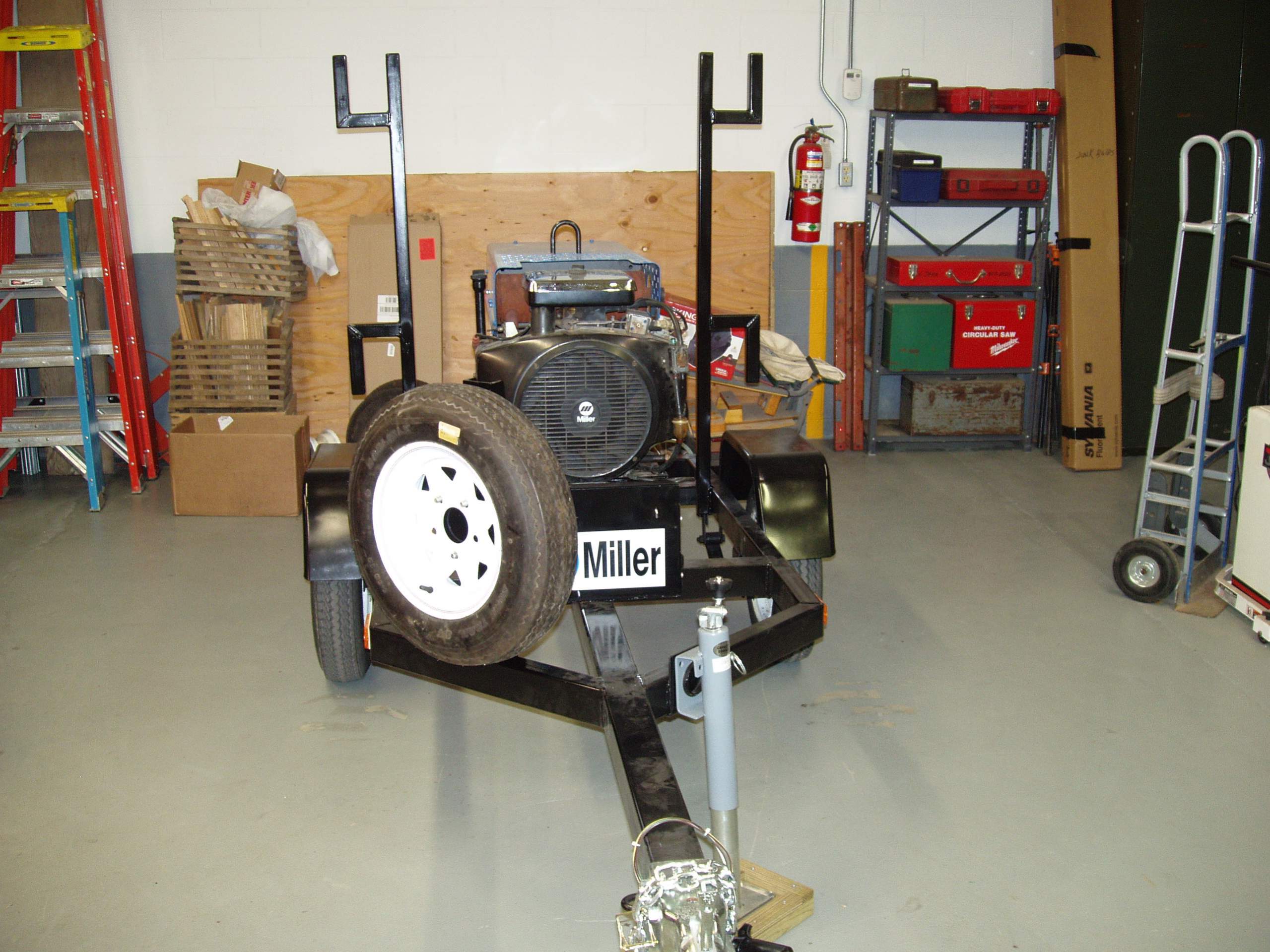

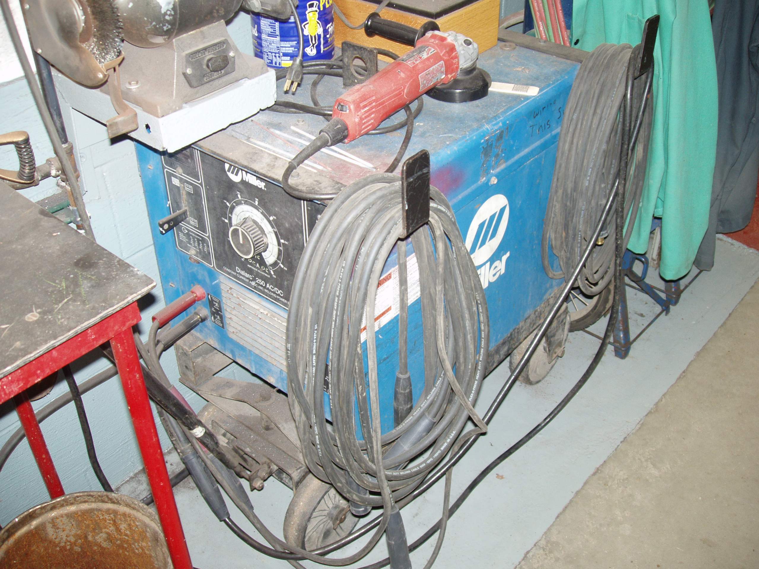

Maybe pics should be included too.

Nice dialarc and engine drive. Love the unisaw in the background.
The Uni is a 1950 I got out of a school and then went all the way thru it, it needed some TLC.
The engine drive was on its way to the scrap yard because the engine would not run right and the shop could not fix it. Had to do a bit of work on it also.
