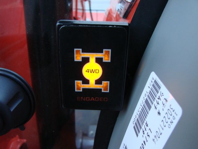

Four wheel drive indicator light;at least on Kubotas ,others may offer this already.
I've already done that along with a few other things :D

- Designed and built an LED 4X4 display indicator for the cab.
