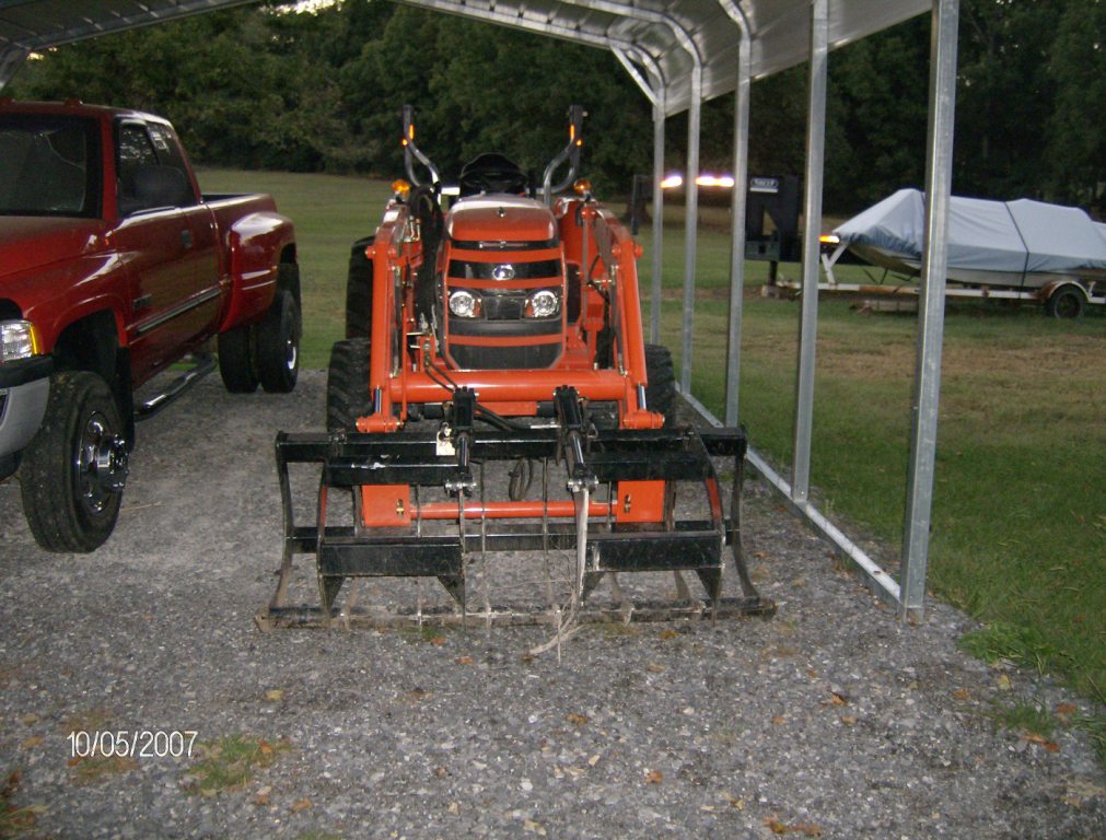

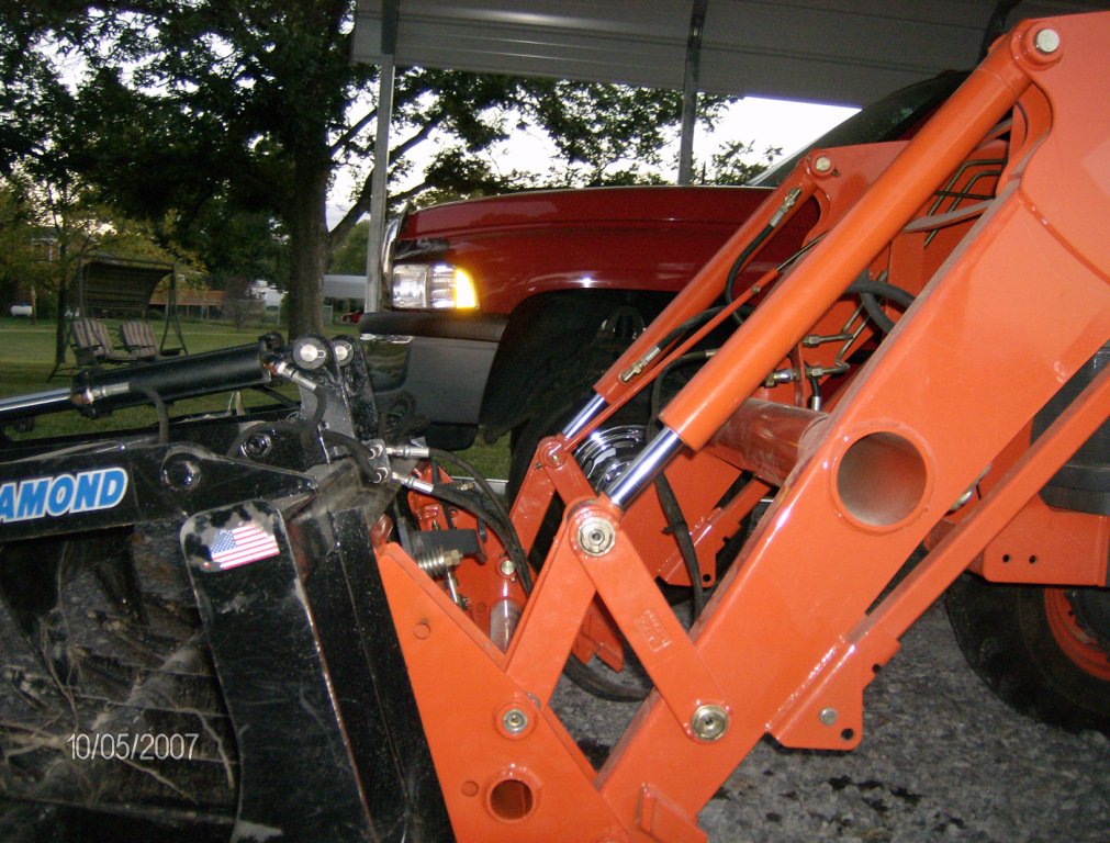

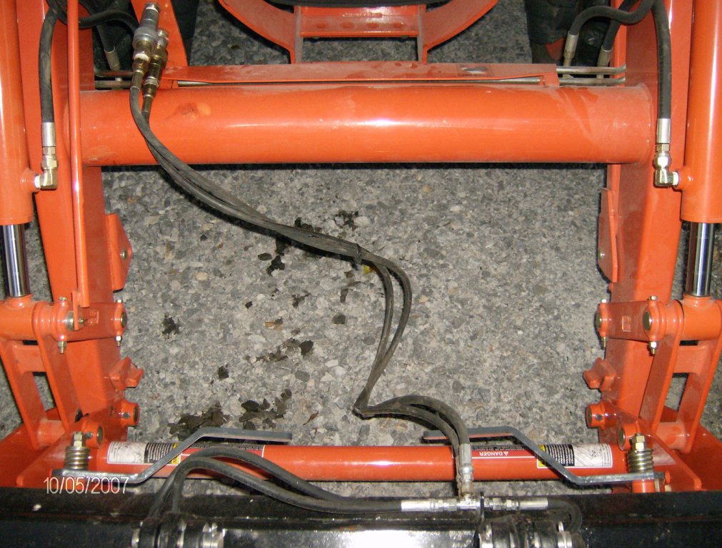

The dealership returned my tractor this evening after replacing the Quick Attach and the Third Function Joystick. They covered everything under warranty, for which I am very thankful and appreciative.
Everything appears to be working correctly at this point. My only frustration comes from the fact that there is still leakage around the third function valve even though they supposedly replaced all of the O-rings while they had it. I plan to see where that is coming from in the morning. Since they knew it was an issue and we discussed it a couple of times while they had it, I am somewhat annoyed that it isn't resolved at this point. I will contact them on Monday if I cannot resolve it myself. I hate to be a pest, but if it is leaking when it is brand new, it will only get worse! Arrghhhhh.....!

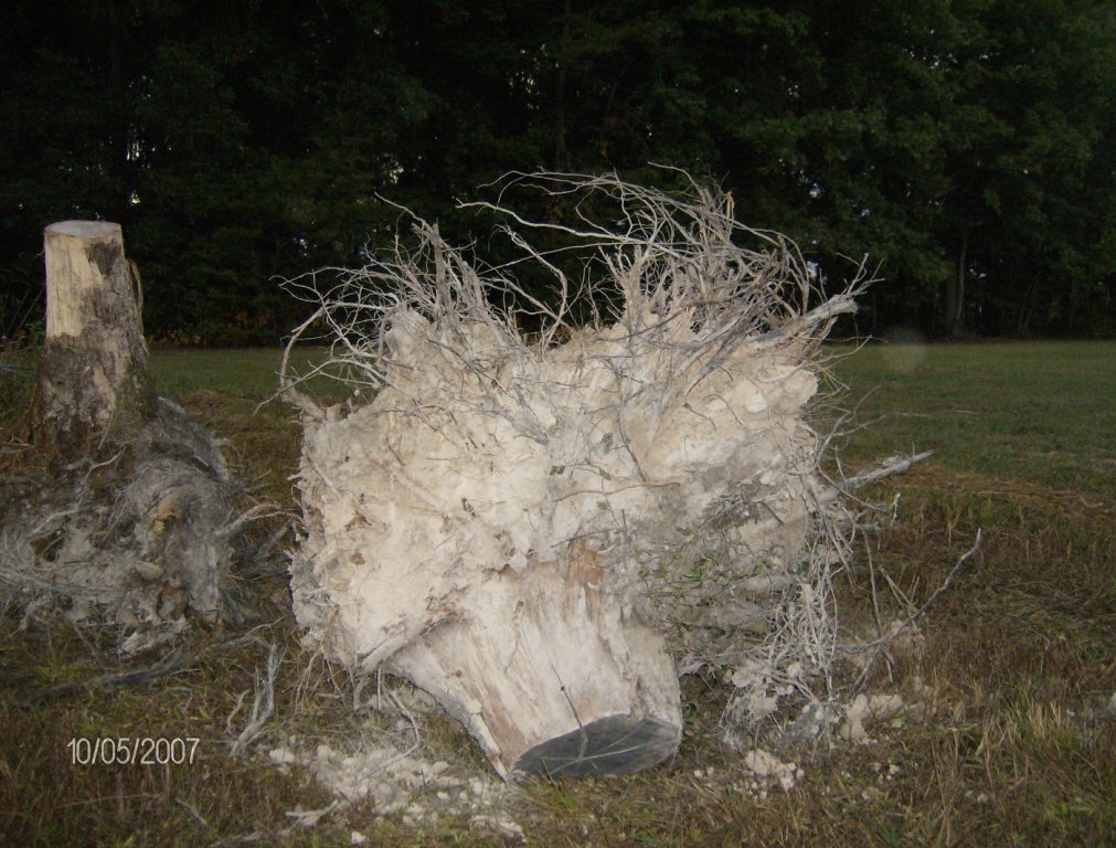

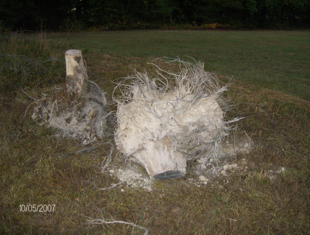

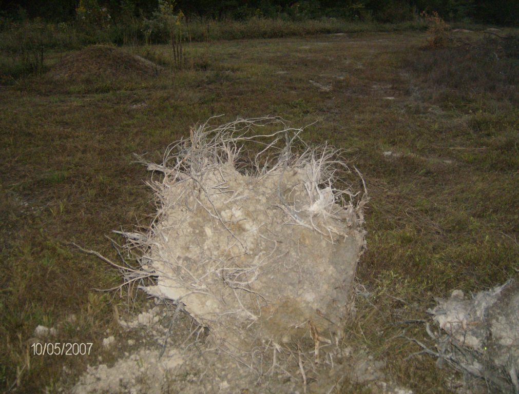

I am also attaching pictures of the stump I was lifting when the problem occured. I lifted it from where it fell and took it to where I was originally headed. I didn't have any problems.
Unfortunately, they never offered any ideas about the cause.

Well, you are making progress... and under warranty.
My opinion, the stump is well under the weight that you should be able to pickup... totally.
Try cleaning up all the oil... maybe it is just some residual... we can hope. Else, let them work on it again.. shouldn't leak.

I agree. Wait a day or two. I recently replaced four o-rings on my FEL control valve and it still "leaked" droplets for a full day before the "leakage" fully disappeared.

Thanks for the feedback. I tightened up all of the fittings and found one going into the valve that was leaking. I tightened it up and tested it without putting any tape or paste on it. I ran through several cycles with no apparent leaks. Then I sprayed it with degreaser, wiped it all down, and ran through several more cycles. There doesn't appear to be anything leaking at this point. I will just keep an eye on it for a while and we shall see what happens.
