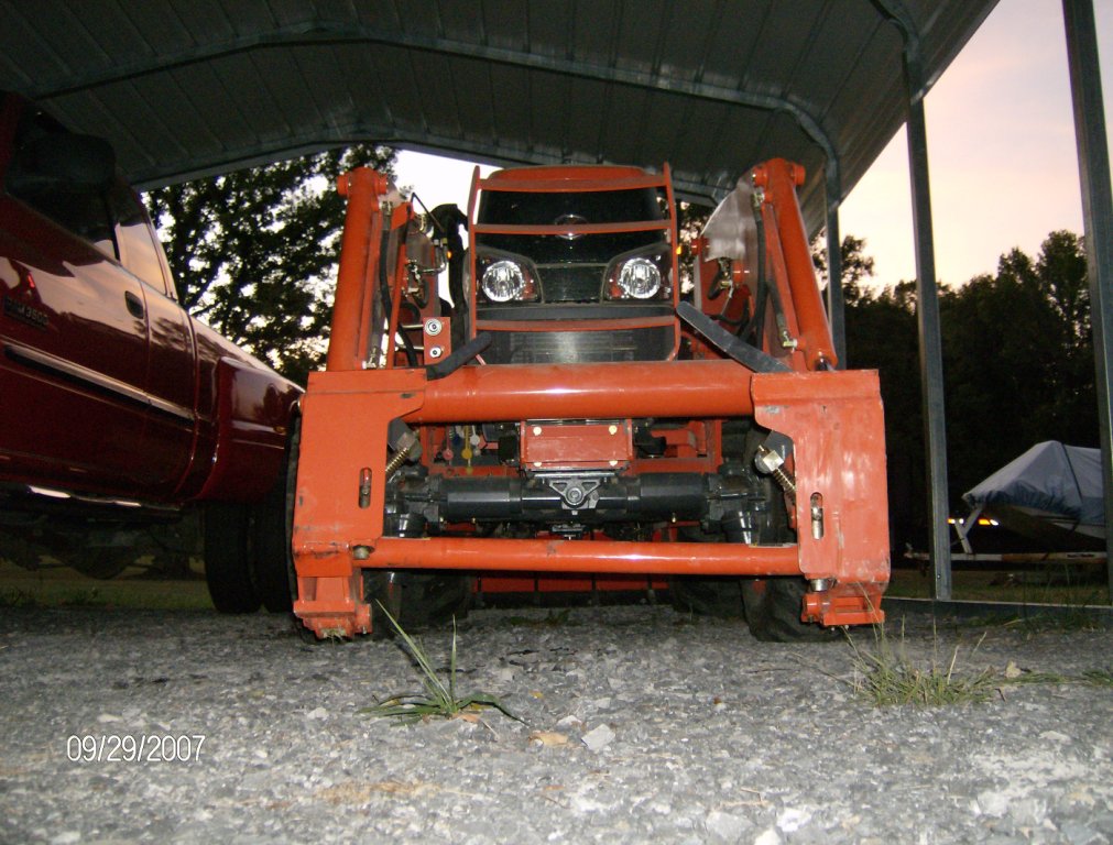

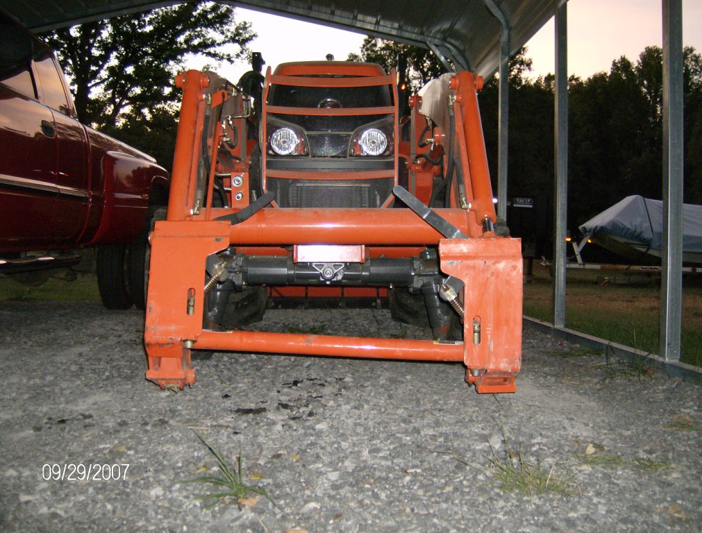

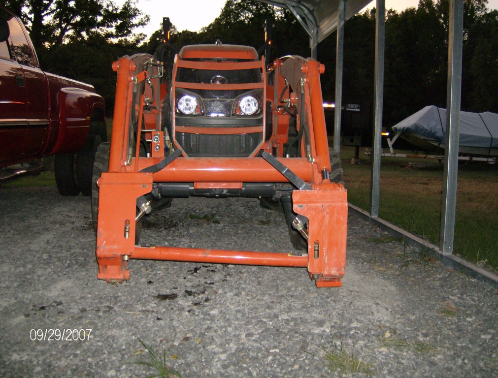

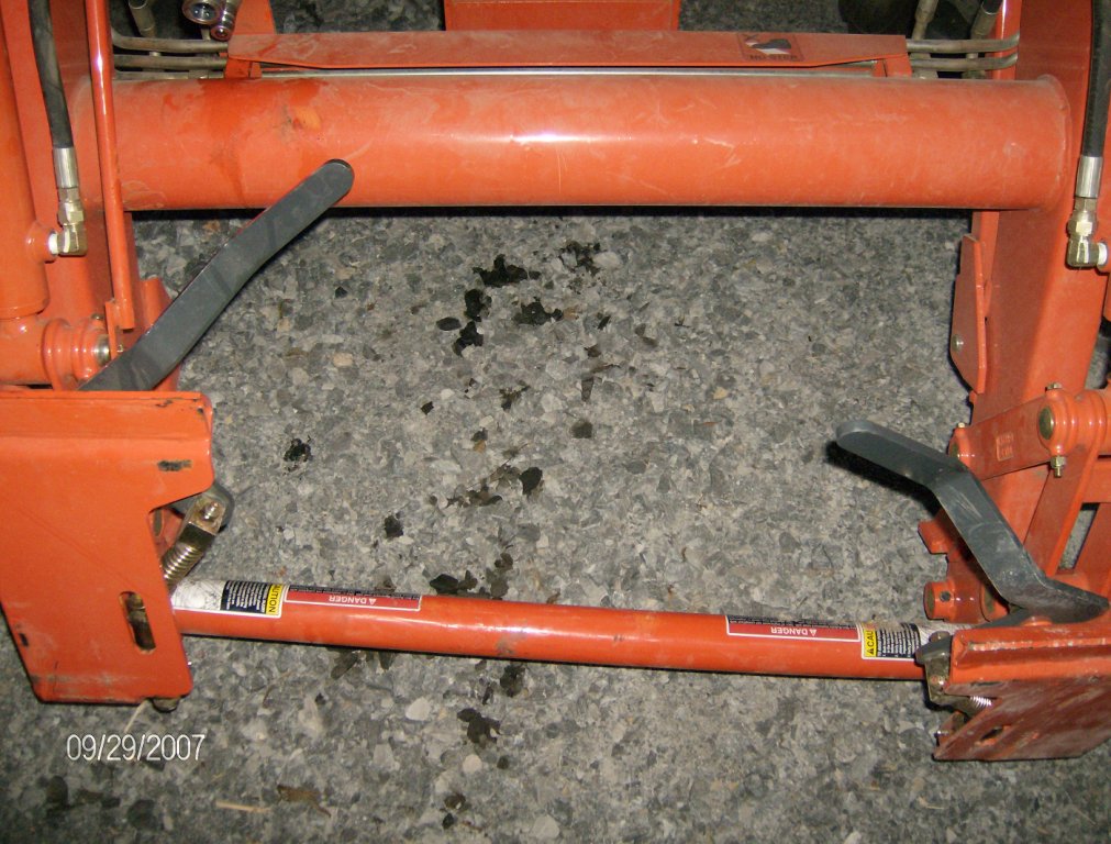

This afternoon, I was working with the grapple attached to my FEL. I was simply lifting a small stump that was loose on top of the ground (it had been pushed out by a dozer a year ago). For whatever reason--and it wasn't a blown hose or hydraulic failure--the entire FEL suddenly dropped. (I wasn't maxing out because it was slightly above hood level and the grapple was already clamped on the stump.) I should also mention that I had already moved a few stumps prior to the problem.
When I got down to check things out, I saw that the part pictured was bent. Obviously, it was putting things in a bind, so I disconnected the grapple. When I tried the loader, it would lift up and down fine, but it wouldn't roll completely because of the bent piece. Additionally, I noticed that the third function button wasn't lit up and it wouldn't light up even after pushing it as you are supposed to. I reconnected the hydraulics from the grapple to see if that had anything to do with it, but it didn't matter. It is no longer working.
Since this tractor has all of 14 hours on it and I have had it all of 7 days, this seems very strange to me. What would cause this? Can the part pictured be repaired or will it have to be replaced? Obviously, the malfunction in the joy stick will have to be dealt with also.
Any ideas? Thanks!

It looks like the bucket was not latched properly allowing one side to pop off and bend the QA mount.
/ What would cause this? Can it be fixed? #3
I looked at the photos carefully and came to the same conclusion that kevinj did..... Quick Attach improperly latched.
It is possible to force the latching handle down against the spring, even tho it is not properly inserted into the mating slot. I have a habit of hooking onto an implement, raising it slightly, then "flipping" the FEL so that the implement settles well into the upper cradle of the QA, THEN getting down and closing the handle for the pins to mate into the slots and visually making sure that they are physically thru the slots.
I'd take it back to your dealer and see what he can to to help, however, he may want some more $$ since it appears to be a case of "operator error."

I did get underneath and look all around that area to see if anything looked suspicious. There was a slight bit of hydraulic fluid, but that could have been from a relief valve or a loose fitting.
Hydraulic reflief valves don't vent externally. The very high pressure in hydraulic lines usually makes loose fittings immediately apparent. Unless you are speaking of the dribble from a quick disconnect, there should be no hydraulic fluid on the outside of your tractor.

Snowridge, you are correct regarding the relief...I should have remebered that. It looks like one of the hoses that is screwed into the spool valve had just a slight drip. I suspect it isn't as tight as it needs to be, but I didn't touch it at this point. In any case, I don't believe that is the culprit here.

Looking at the pictures and based on my experience with a Kubota QA I believe the right side of the QA from the operators view was not properly latched. Might not have been noticed ( I didn't the first few times) until it was loaded when it popped out. This would have caused the twist but I can't figure how it would have caused the hydraulic failure.
I have the most problem latching up my Kubota bucket since the angle of the lip at the top of the bucket does not match that of the QA hook. The bucket usually ends up hanging away at the bottom. Latching then is ineffective. Coincidently I have the most problem on the right side. I always curl the bucket vigorously until the plates of the QA lie tight against the bucket then latch. I also put washers under the springs to get a tighter latch.
I also noticed that from your photos the the cross tube of the QA seems to be smaller diameter than the one on my L3130. Weaker? I don't know.
I have thought about running a bead of weld metal under the outer edge of the bucket lip to force the bucket to hang tighter to the QA.

Will the bent piece have to be replaced or will they try to repair it?
