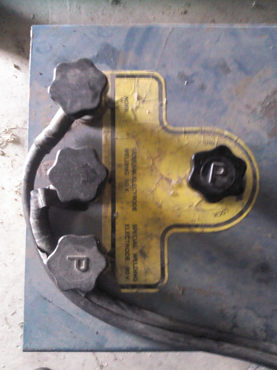

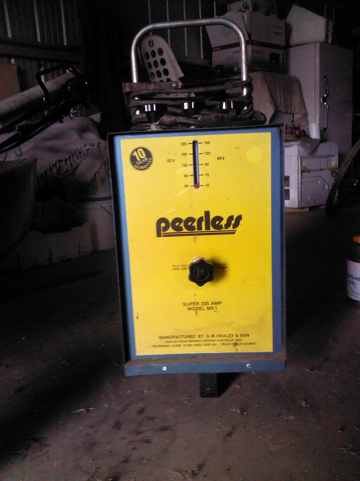

Here are some photos of my welder, it australian made so I don't know if you can help.
The picture of the face looks like 225 amps AC/160 amps DC.
Edit: never mind, it's 50 volts 225 amp or 160 amps at 80 volts... so I am over my head, sorry; looks AC only to me, with 2 different voltages; no idea what that's for;
   / What welder would be best?? #37
It's pretty normal, on a standard AC buzz box you'll often see a high and low tap.
The low tap has the higher Open Circuit Voltage (OCV) and tends to run rod smoother and start easier.
