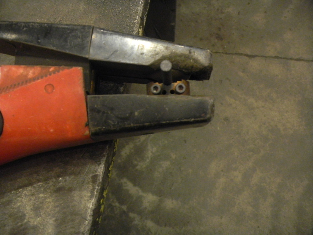

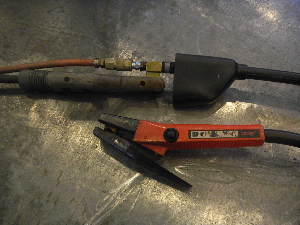

   / What welder would be best?? #58
That would take awhile to grind out.
Anybody who has a clue with welding would never grind out a weld of that size. They would use one of these.
