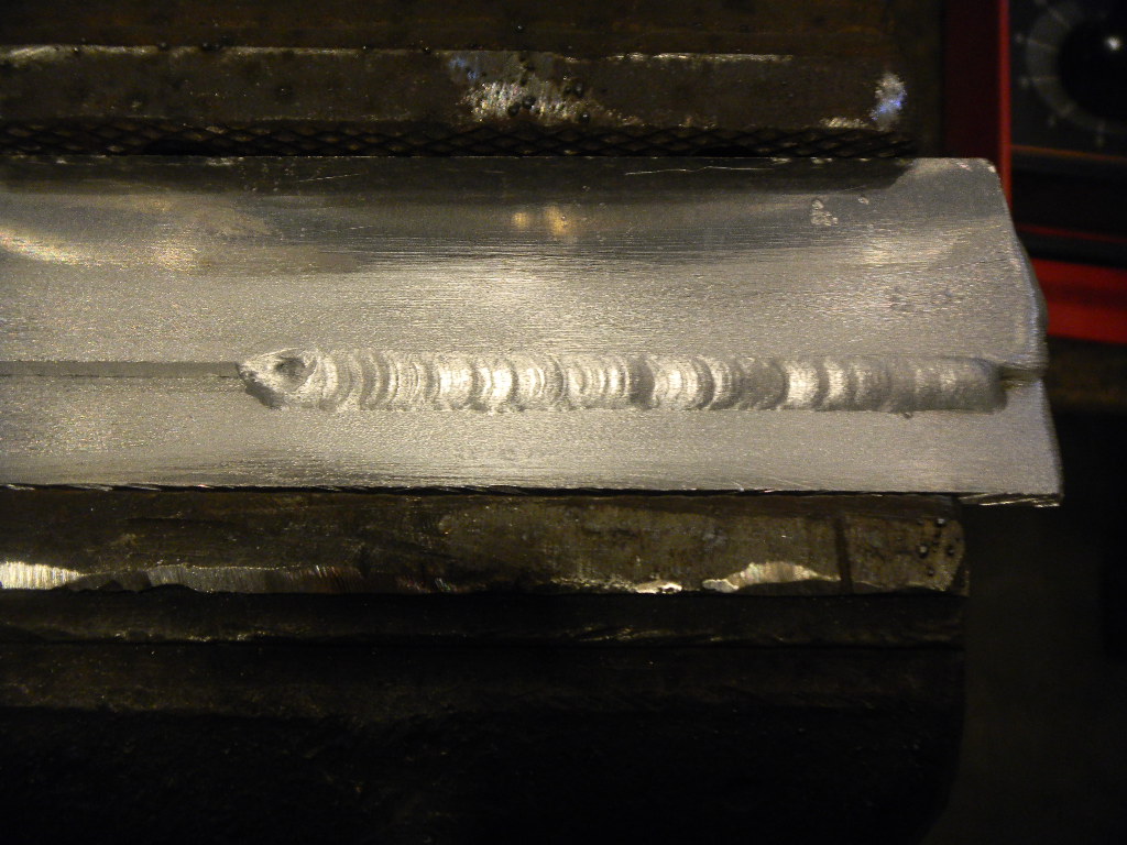

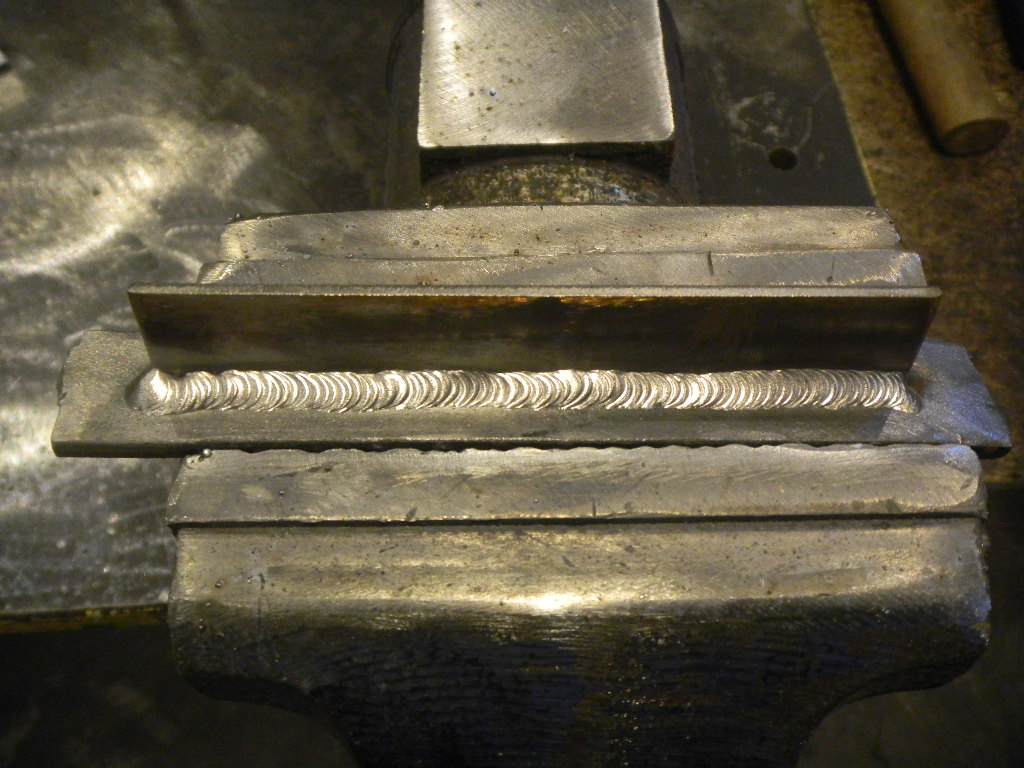

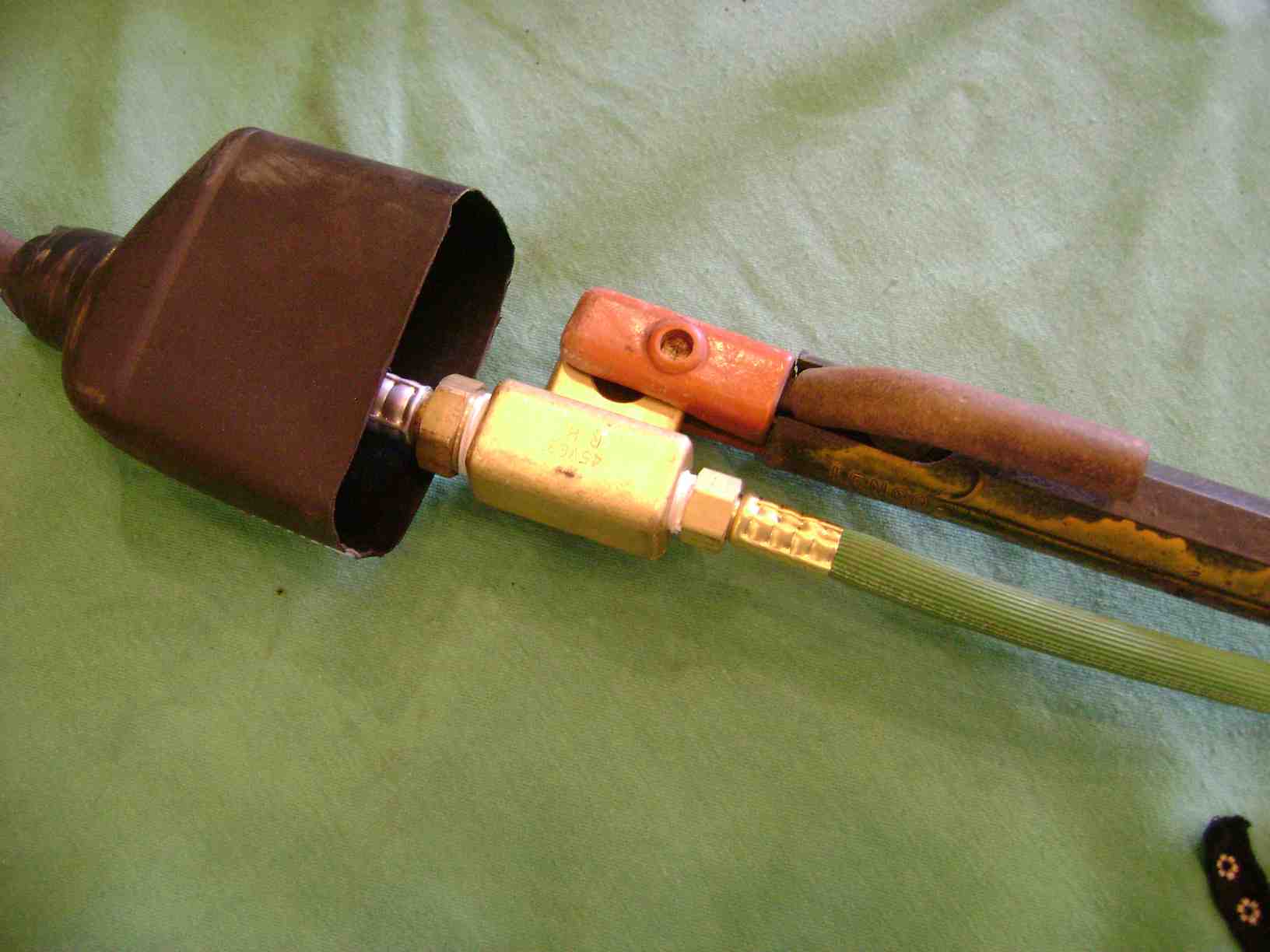

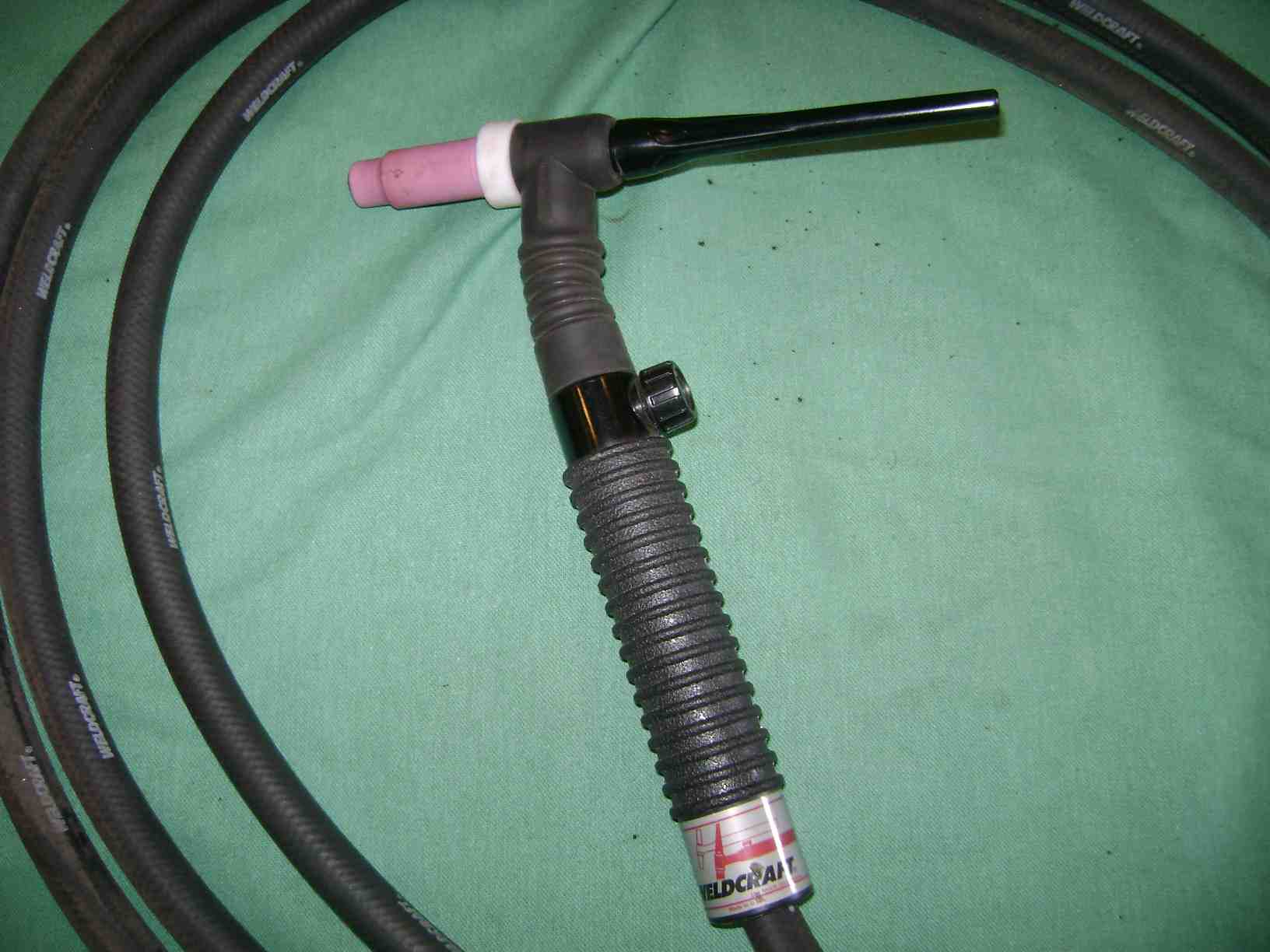

Scratch start Tig is a cheap and easy way to weld thin steel, stainless steel, and even aluminum if you have a bottle of helium.;)

If your existing machine is DC or AC/DC how about getting scratch start TIG. Think you could be in business for $125 for torch, hose, power cable; $35 regulator; $100-200 for argon tank (or lease one). I'm only offering it as an option if your current arc welder is DC. I've not yet tried scratch start tig, so one oof these guys can give much more specific detailed info. If you really hunt Ebay I bet you can hunt down a torch and hose/power cable for $60, and a gas flow meter for $25; then lease the tank, you'd be up and running for right at $100.
Scratch start TIG is cheap and easy, and can replace the need for a MIG for light materiels. I have been doing it for a couple of years, and is a good way to go when you need to weld something thin or too small for a stick. Yes you are out the price for a tank of argon, but they can be leased in many places. Is there a learning curve?, yes there is, a big one. But it is worth it. If you have a good DC stick welder, you are halfway there.
