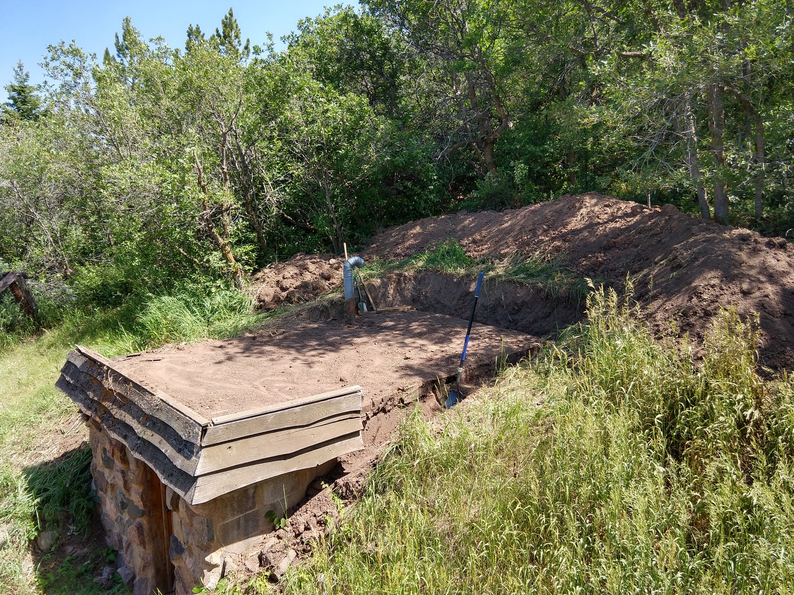

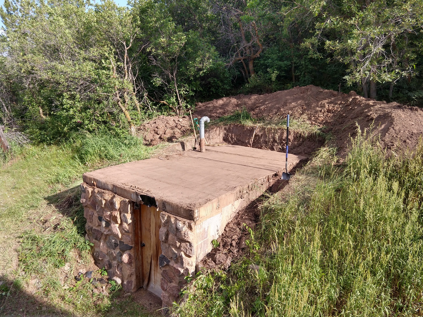

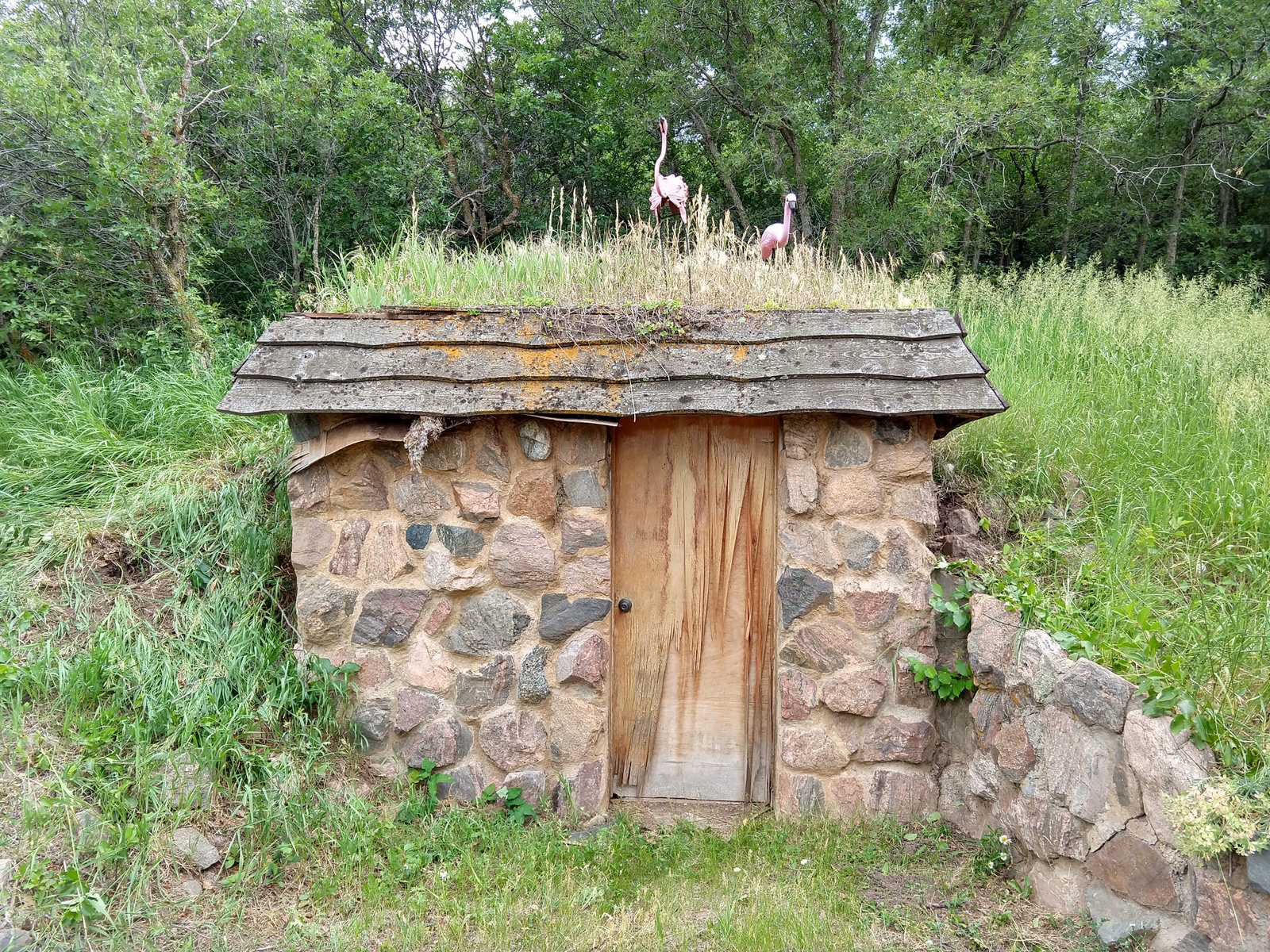

This is an old root cellar that the wife and I have been using as a wine cellar for our wine making hobby. Last fall we noticed that the roof was collapsing so we shored it up as best we could and deemed it a high priority project for this summer. Well I got the dirt off the roof now and need to start thinking about how to rebuild this. The cellar is 10' x 16' with the interior divided into two rooms. The current roof is 6"x12" beams laid flat with a few layers of roofing felt, tar and roll roofing providing the water proofing. The soil depth on the roof was 18"
I was thing of using 2" x 10" x 10' joists on 12" centers along with 2 layers of 3/4" plywood sheathing, all wood will be ground contact pressure treated, think that will work?
I haven't given too much thought on the roofing membrane, so any guidance will be welcome.

The system you had is probably the cheapest and will work . I would go back with a single ply tpo or epdm after you rebuild the roof a single ply will only need to be attached around the perimeter walls because the soil will hold the membrane down.

From your last picture it appears as if a concrete cap was poured? I agree, a torch down EDM membrane would be a good waterproofing choice.

If you go with your idea of 2 x 10’s and plywood sheeting, I would use Advantec sheeting. It will hold up much better than plywood. That is a cool looking root cellar...

Did you consider using a single 3/4" sheet each, above and below the joists? The resulting dead air space would provide more insulation. The joists couldn't splay under load. The question would be how much dirt 3/4" spanning 10 1/2 inches would support without sagging.

x2 on the concrete.. we did a root cellar roof years ago at great uncles place, still there 40 years later.

Thanks for all the responses. If I were to go with a cast in place concrete roof how thick and how much rebar so I know it is strong enough? Is there an online calculator to use?
I'm leaning toward a wood roof because I am most comfortable working in that medium plus the original roof was wood and it lasted 50 years even though is was underbuilt and wasn't waterproofed very well. If my new roof lasts that long I'll be dust in the wind when it fails and will not care.
I am figuring a load of about 160 lbs per square foot, so if I double up my 2x10 joists that will be plenty strong. I've been reading up on epdm membrane, that sounds like something I can install easily so will probably go with that. I am second guessing the need for two layers of plywood, the load tables I'm looking at show that 3/4 ply can handle over 800 psf on 12" centers as long the face grain is across the supports. I'll look into the Advantec sheathing.

4 inches of concrete sitting on the ground will support a vehicle, because that 4000# car is really only 1000# in 4 different places (the tires). 4" of concrete with just wire mesh supported only on the edges with no compacted soil under it probably won't support a foot or two of water-soaked soil sitting over air. It's a big difference. ;)
The OP mentioned it's two rooms in the cellar. I'd build up that divider wall so the roof is supported in the middle.
And, since the OP said wood is his thing, and the original was wood, and lasted 50 years, why not just rebuild it exactly the same way, only put a waterproof membrane over it? It'll last even longer that way.
