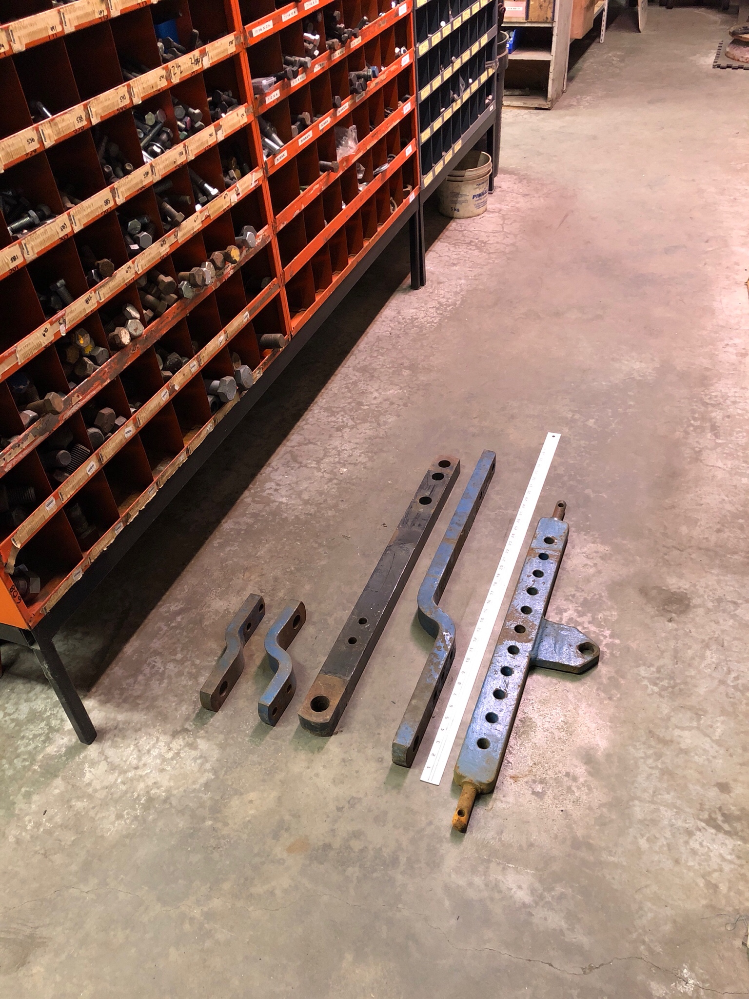

This thread got me thinking so I just checked my parts room to see what I had left:
The blue 3 pt hitch type on the right was used when I was a kid in the 50’s. I only have two Ford tractors left in the yard but I still remember when we literally had a wall full of top links, drawbars, stabilizer bars and stay bars hanging.
