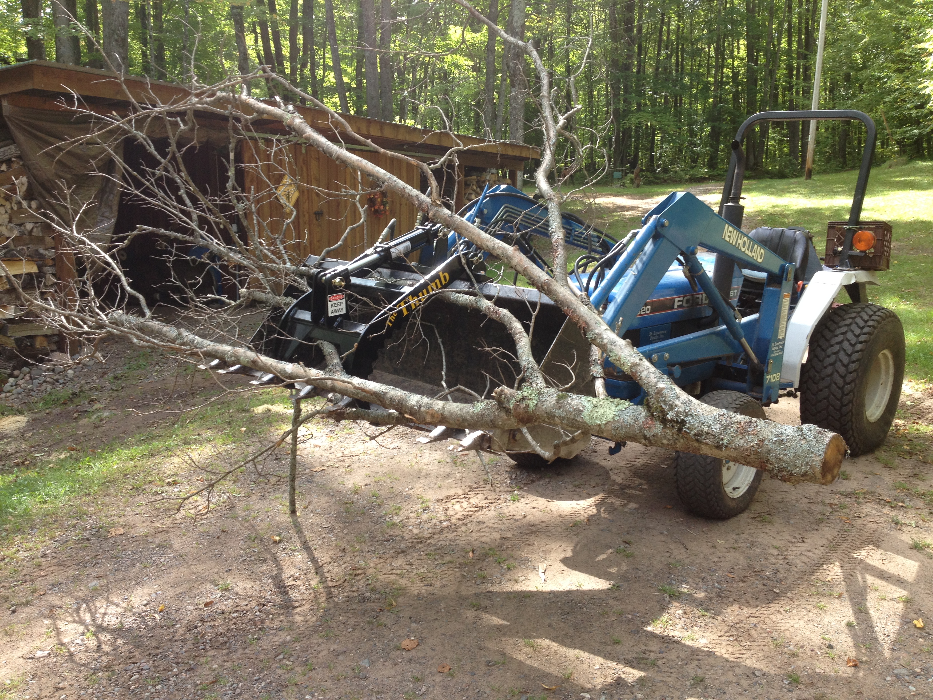

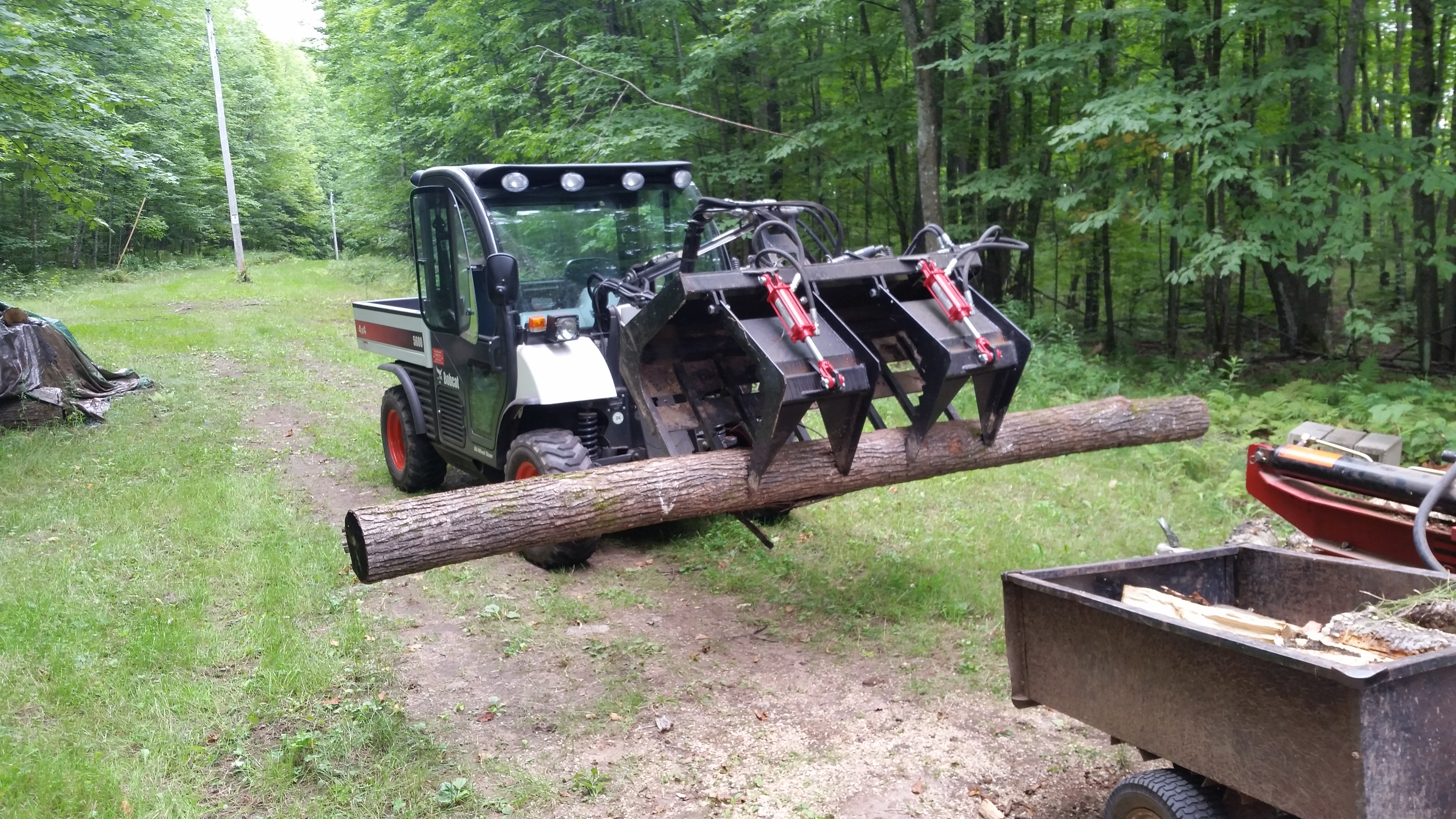

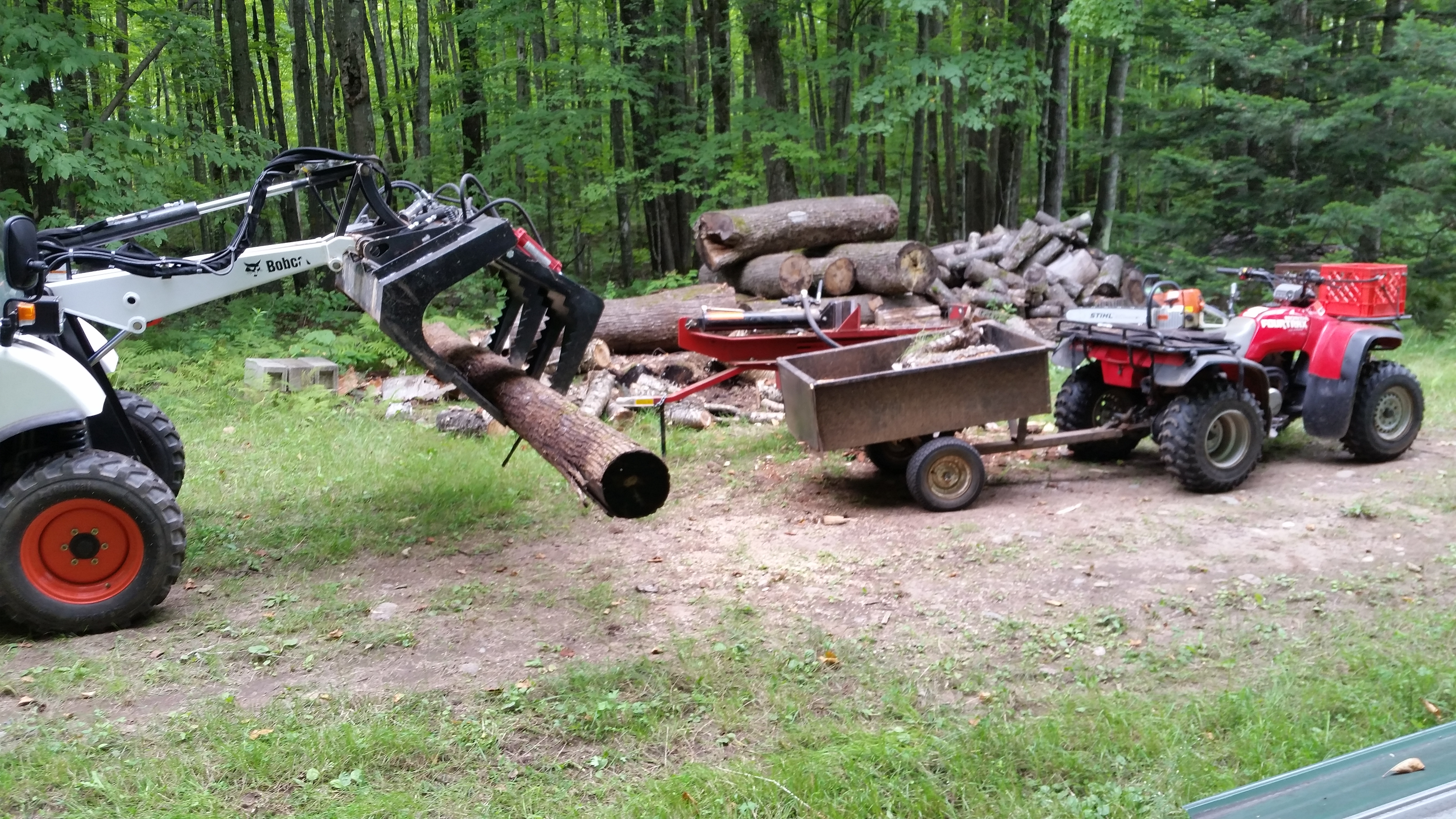

I have a "thumb" for my tractor and a grapple for my toolcat.. sometimes a picture is worth part of the explaining.. I got the thumb for the tractor as it didn't add much weight but you can see the amount of brush it can handle, works much better for smaller stuff and holding logs to cut but then you have to watch out not to hit the thumb or the bucket in the center areas with the saw.. the "L" grapple with two clams works much better for holding logs to cut (only have to watch out for the top clams and also can stuff way more brush into it (go vertical into pile and clamp down grabbing about everything). the double clams is the way to go you can grab one big rock, uneven Y branched logs, root balls you name it.. 20130914_174916945_iOS.jpg20160827_111118.jpg20160827_111128.jpg

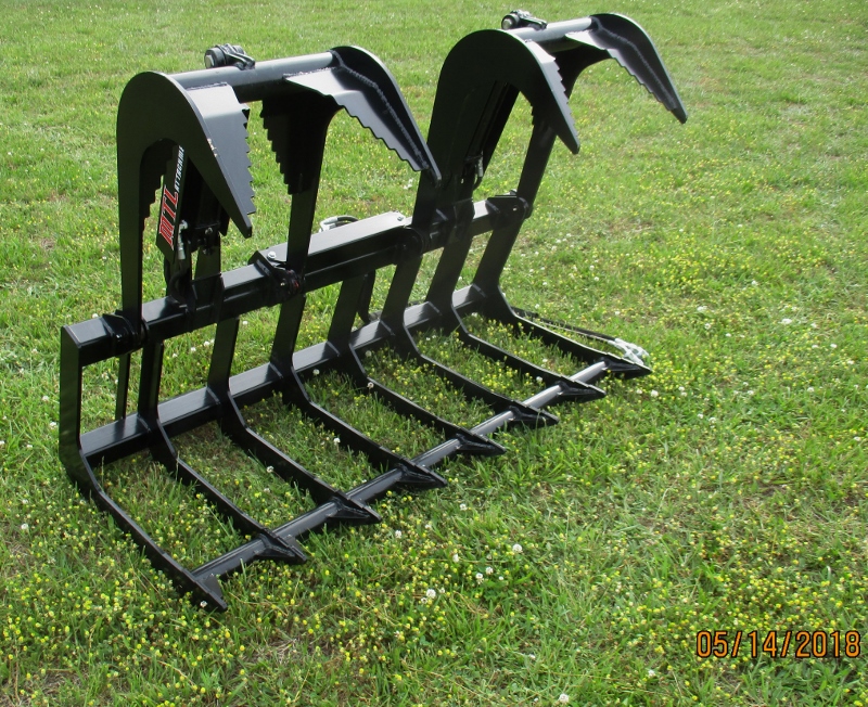

My tractor has taken longer to get in than expected (new ETA is 2nd week of July), which has given me the chance to continue to research grapples. That's both a blessing and a curse, considering my OCD analysis paralysis. :D
I'm using the grapple for brush, logs and firewood much more than for digging roots. As such, i have been concerned with tine spacing and the stuff I'm grabbing 'dropping through' the bottom.
In looking at what most people went with for my type needs, it seems that they like the flat bottom style. However, I'm trying to figure out why you guys have gone with a brush grapple vs. a rock (closer tine) grapple. I'm coming from a place of ignorance, so please help to educate me before I purchase.

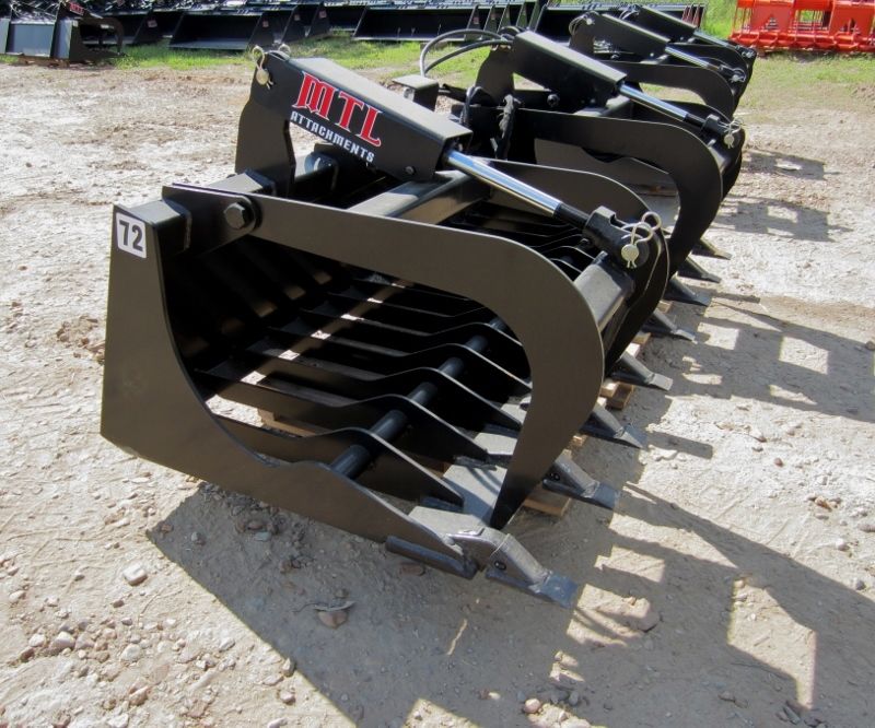

What are the benefits/problems of these two models:
The 'close tine' version - a 'rock' grapple
...and a ~8 inch width between tines

I find that small < 9" firewood rounds are not easy to handle with my EA wicked grapple. They wedge in the tines or fall through or fall out. Logs are no problem, it's when cut to firewood length that they become more difficult.

The close tine version would be a little heavier, that may not matter depending on your lifting capacity.
My L bottom grapple tines are 9 inches apart, usually not a problem, but I have considered removable inserts like EA uses so that I could pick up smaller rocks when needed.
That's the concern, exactly. I appreciate your experienced feedback.
The weight is about 75 lbs greater, but I'm trying to see what else I may be missing. My lifting capacity is about 2,500#, so I{'m thinking I should be OK.
