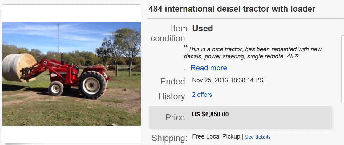

Round bales can weigh 1500 lb or more. You'll want a tractor that weighs at least 5000 lb including the front end loader (FEL) with at least 50 hp (engine). $10K is a tight budget. Check local dealers who will usually have trade-ins for sale. Also check eBAy and Craigslist.
Here's one you could use that sold a few months ago on eBay that fits your budget.
Good luck

If 10k is your budget, you're looking at a big old 2wd. I think something 50-80hp will have the weight to do your tasks and keep the price where you want it. Unfortunately, they will use fuel liberally and require maintenance. Also, they aren't nearly as user friendly as new models. 4wd is really nice, and means you could use a smaller tractor, 40-60hp. Unfortunately, even used, you'll be hard pressed to buy something under 15k.
