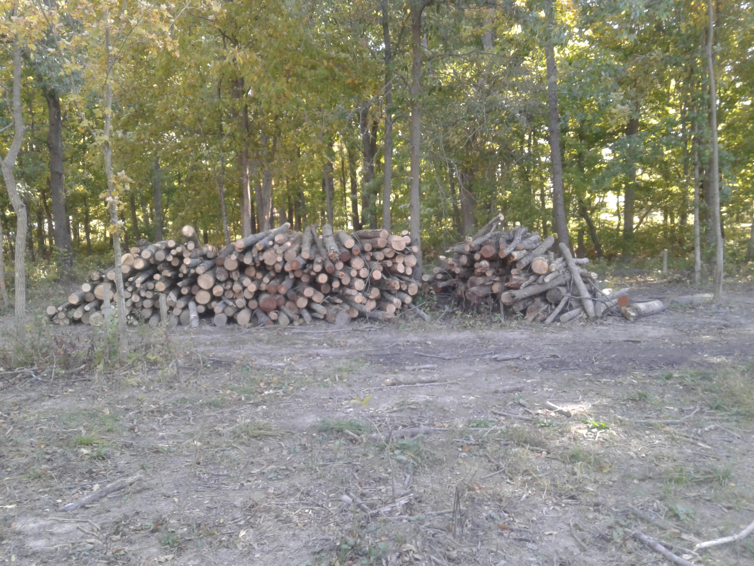

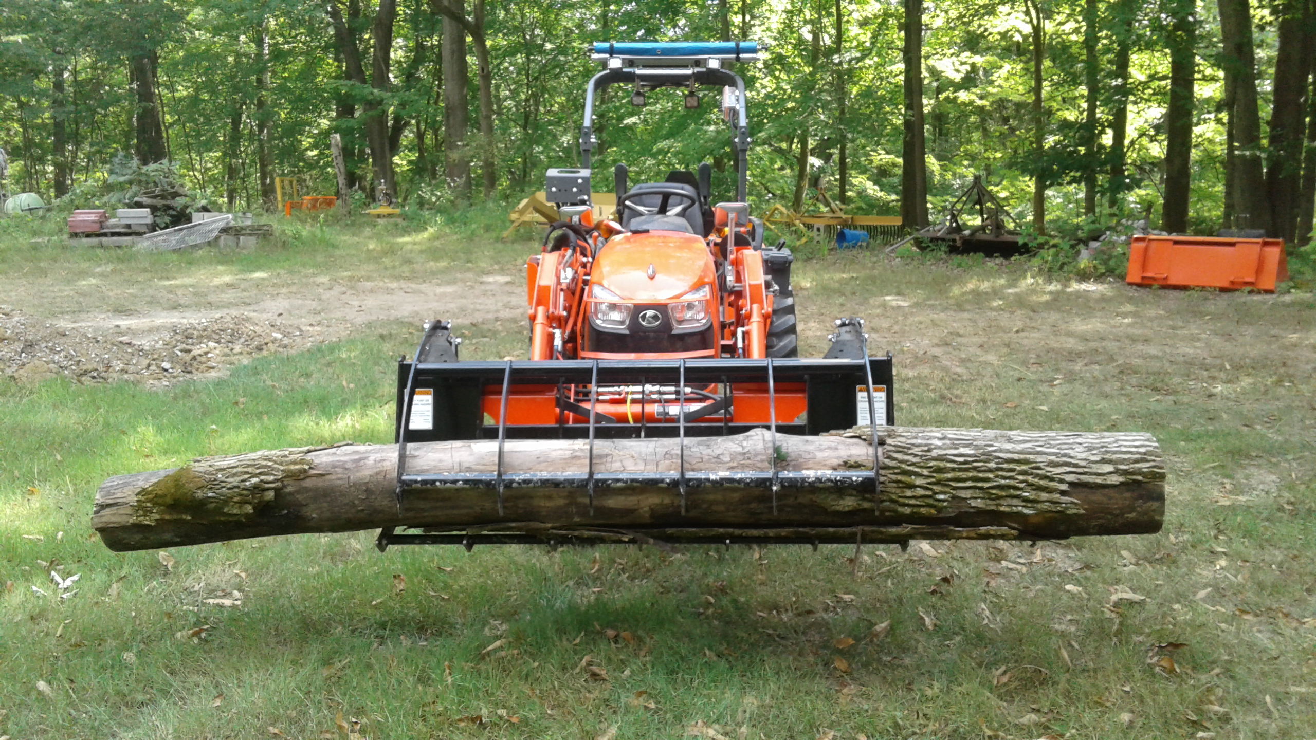

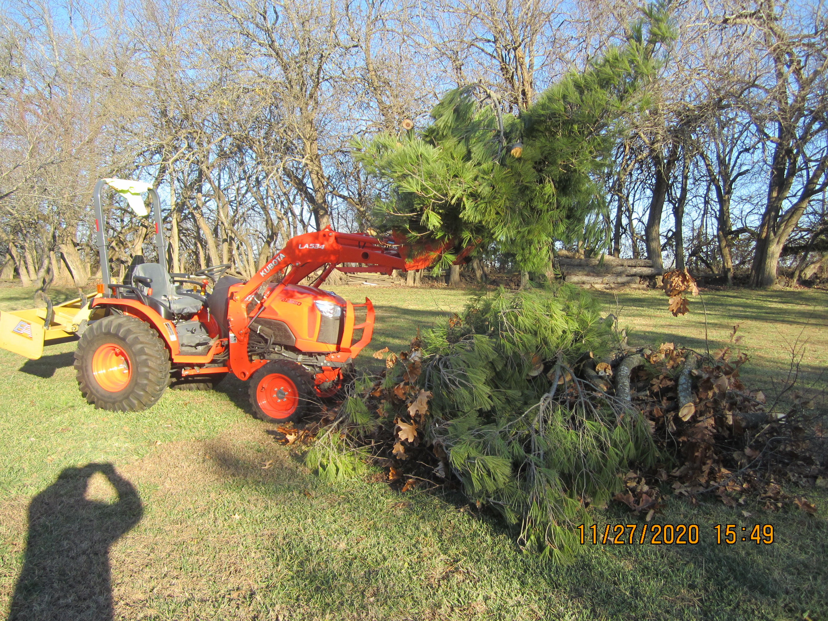

jodebg,
I have done and still use both my B2620 and B2650 to do what you plan.....using clamp on forks ....working by myself....over the past 10 years. I hand load the smaller limbs/brush for hauling to the burn pile stack. The longer logs I have stacked....some of them I cut into shorter lengths to burn more readily.
Cheers,
Mike002.JPG003.JPG006.JPG...just a few pics
In the background you can see some longs that are stacked...pic #3

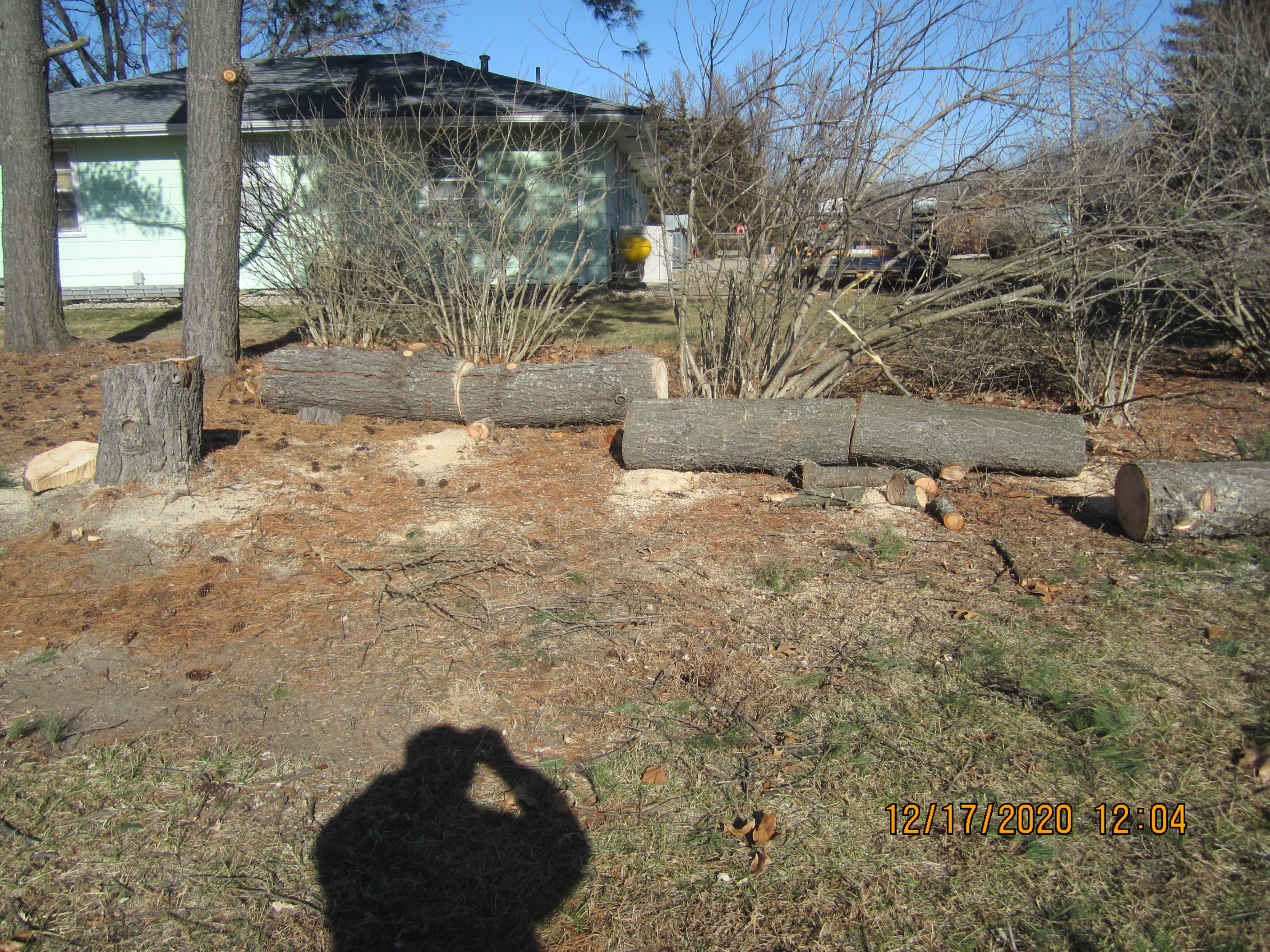

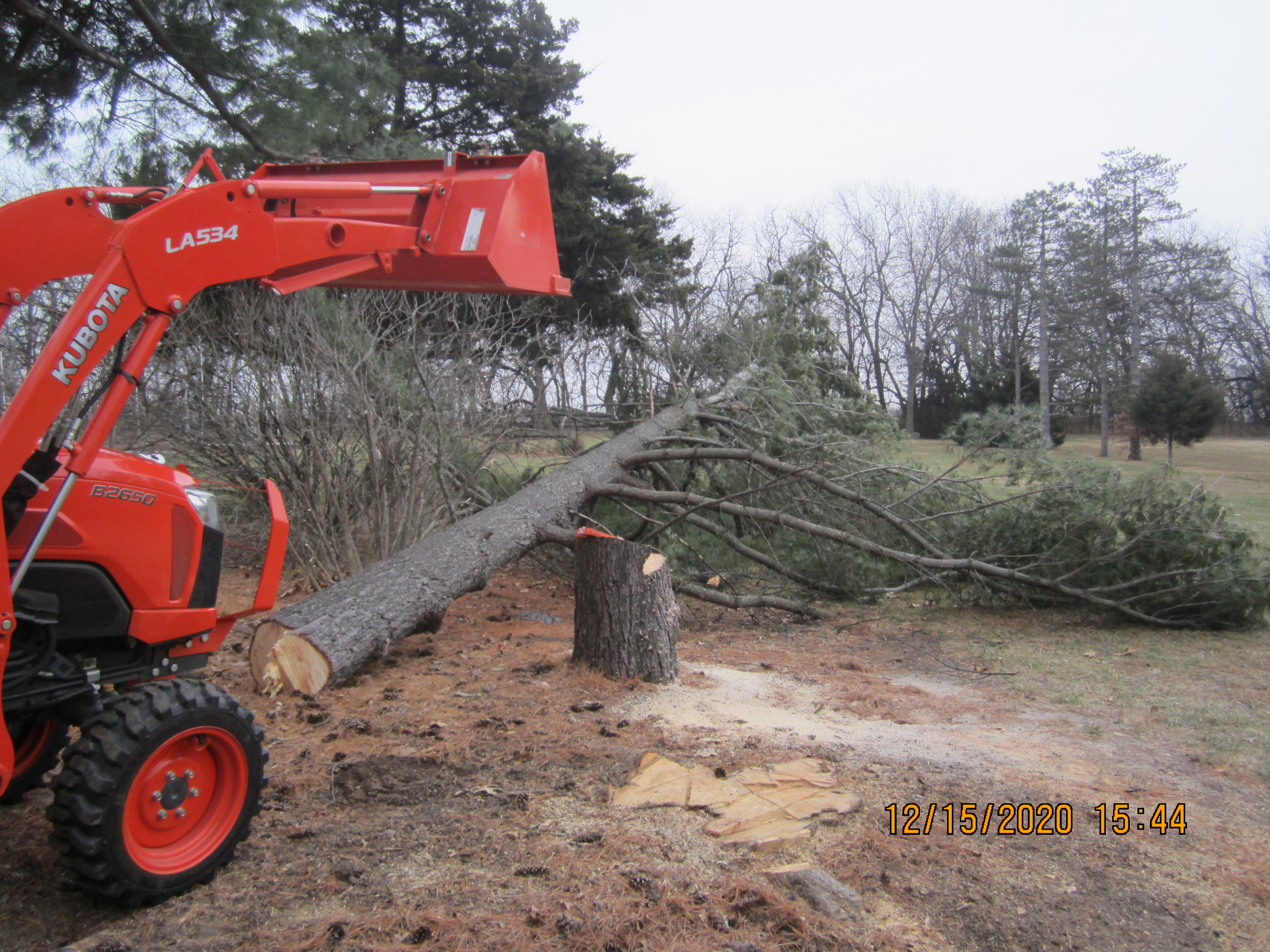

^^^^ Agree totally - I can carry on the forks a 18"x16' white pine log but oak maybe 10-12" x 16'. I just get the forks under, curl back and lift and go. Also I use the BH and thumb to grab the branches and drag to chipper.
/ What tractor attachment do I need? #17
And with Pallet forks you can also move other items like a bar.bar20200530_104756.jpg
