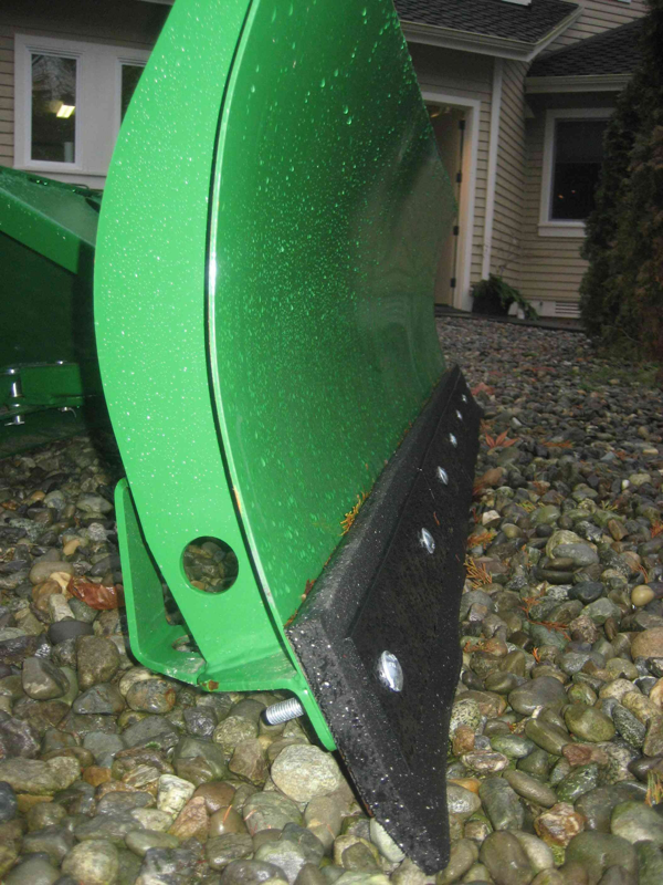

I use a rubber edge but on my front blade. I am sure that you could do the same although on you back blade. I made my rubber edge out of a barn mat - very heavy rubber material about 1" thick. I left the steel cutting edge on, extended the rubber about 1.5" below the steel blade then added a 1/8 " plate on top to hold it tight.
I would guess that a polyurethane edge may be a bit too stiff and pull up some of your brick edges.
I think that JD 4520 has hit upon it for this particular poster, especially since, in his own word he doesn't want the brick "scratched".
Power broom may be another good idea, but a large expense that probably won't handle big snow as others have mentioned.
