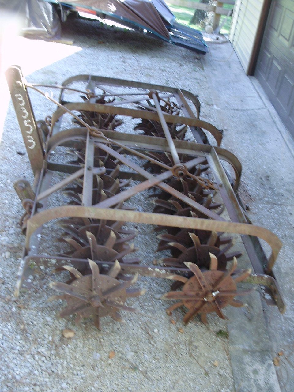

Definitely mow or brush hog it first. You could disc it then and get decent results. I use a chain harrow on mine after discing. It is like giant chain link 1/2'' material with 2'' points that rough up the ground. Its about 8 foot wide and 12 feet long and mounted to a three point frame so that it can be picked up and transported- some are just dragged on the ground. I got mine used at an auction for $325 and it needed some welding and torching but was a good buy considering a new one similar size without the 3 point frame is 12-1500 bucks.
I actually own one as well. Mine is a Feurst Tine Harrow and I pull it with either the drawbar or my side by side and the how aggressive the teeth are depends in which way you pull it or flip it over. Mine hangs on the barn wall when not in use as well. Bought mine used at a farm auction a long while ago. You really cannot wear them out and the teeth are self sharpening. Mine reminds me of a bed spring with teeth. Use mine for setting alfalfa seed when over seeding my hayfields mostly but it's also good for levelling and renewing a gravel driveway, Very simple and easy tool to use. zero upkeep as well.

Eddie, I've had that about 5 years. It's made by Armstrong Ag here in Texas.
Not only do I use it for leveling plowed ground, but I use it in pastures to knock down gopher mounds and fire ants, and repair hog damage in some cases. You can set the height to whatever you want, or deep as you want. I use it a bunch.
Thanks for the link and pictures. This looks really good. 12 feet is too wide to get through my gates, so I'm looking to see if they have a ten foot one.
