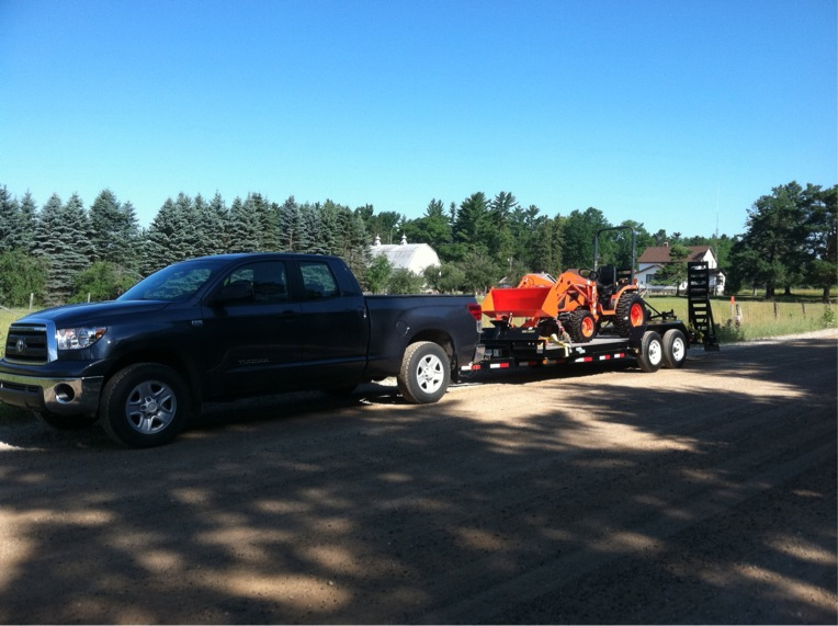

Researched this insanely here when buying a tractor, B2320 with 4' hog, FEL, rear blade. I wanted smallest trailer possible but listened & got a 18' dovetail. It is none to big & hauls easy. I now believe these guys e.g. 'get big as you'll need in future' at least as much as that works for yer situation.
Sounds like a load for your truck. Figure I'm pushing +5500# easy with rig + trailer w/o loaded tires.
   / What size trailer do I need to haul my B2920 #17
18 footer, 7,000lb or 10,000lb depending on your budget. Brakes on both axles.
I pull my B3030 around with FEL and BH attached on an 18 foot dove tail (AKA: car hauler) 7000 lbs with brakes on both axles. The tractor fits fine with no over-hang and I can pack an extra implement under the FEL (bush hog) if needed.
The trailer pulls nicely behind a 1/2 ton Tahoe.
