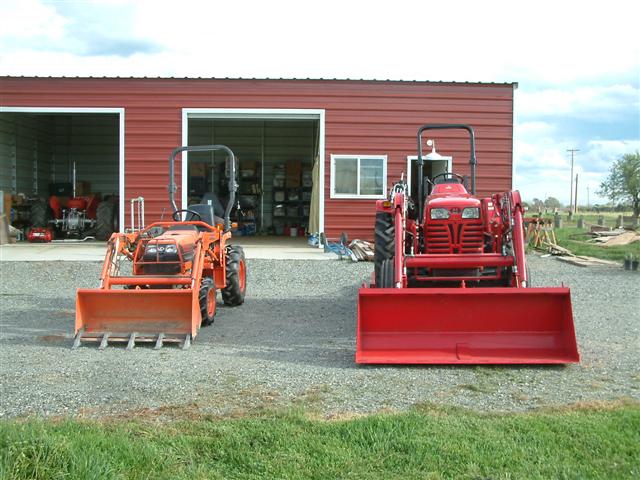

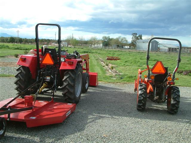

OK, you want to move 50x50x8=20,000 cubic feet of earth.
I have a 2008 Mahindra 5525 (54 hp engine, 45 hp pto, 2WD, gear tranny, power steering) with the ML-250 6-ft wide bucket on the front end loader. That bucket has 18.8 cubic feet capacity.
(The little tractor is a 2005 Kubota B7510HST (21 hp engine, 17 hp pto, 4WD, hydrostatic tranny, power steering) with a 4-ft wide bucket.)
That's 1063 bucket-fulls to dig your pond.
If you can load, transport, dump and return in 3 minutes, that's 3189 minutes or 53 hours. Not too bad.
BTW: that 5525 cost about $18K new. The B7510HST was $12.6K new.
Hope this helps. Good luck.
