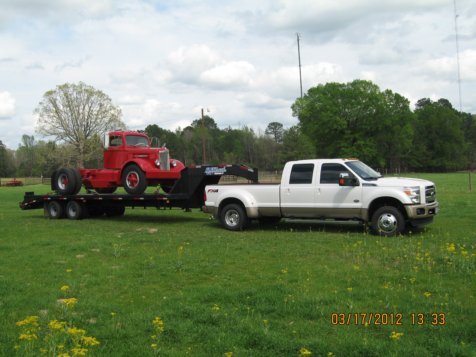

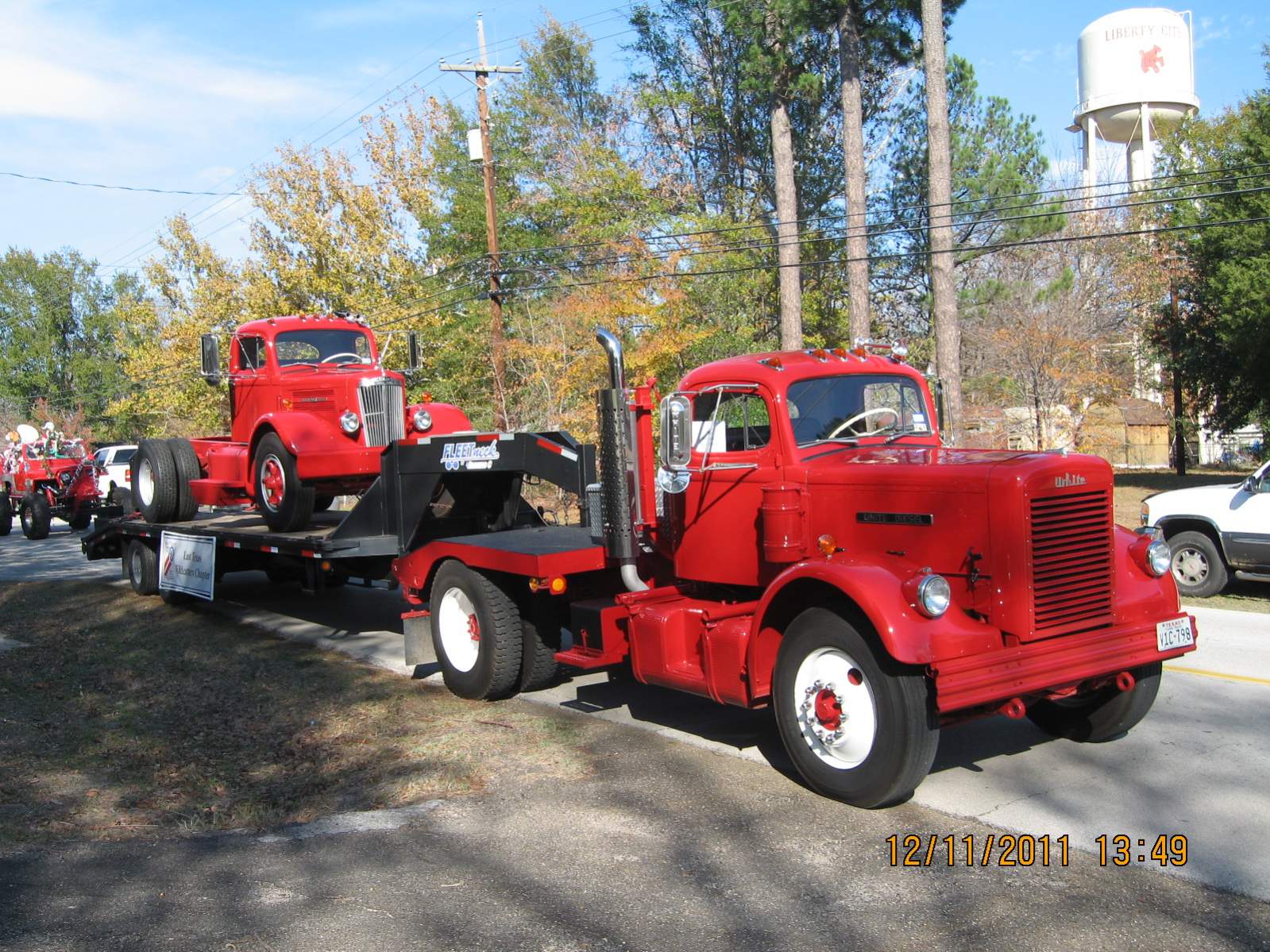

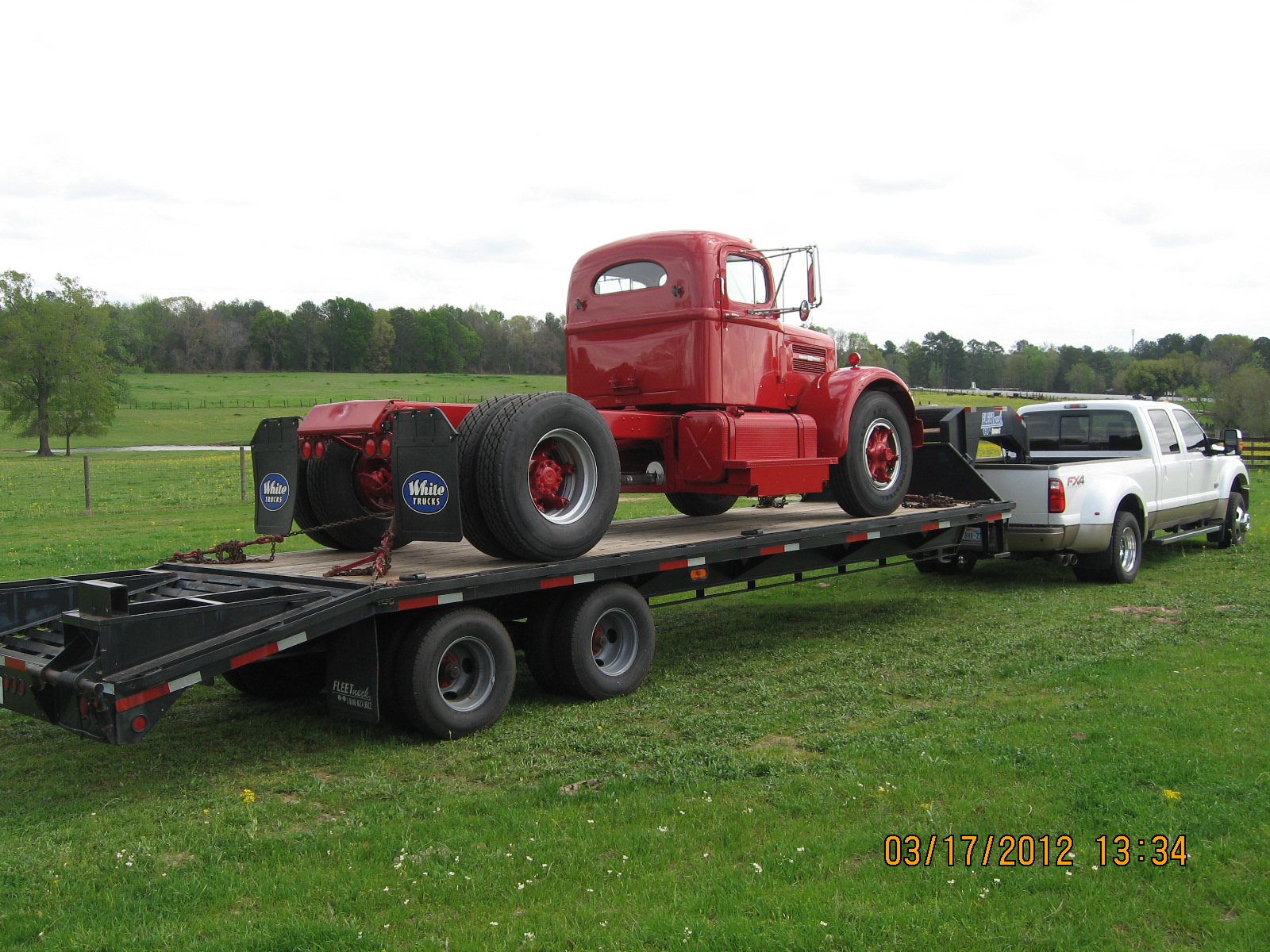

This is my first attempt at posting pics in here so hopefully they turn out.
