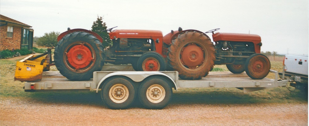

I started with a bumper pull 37 years ago, had several over the years, each one a little longer than the previous.
This was the last BP:

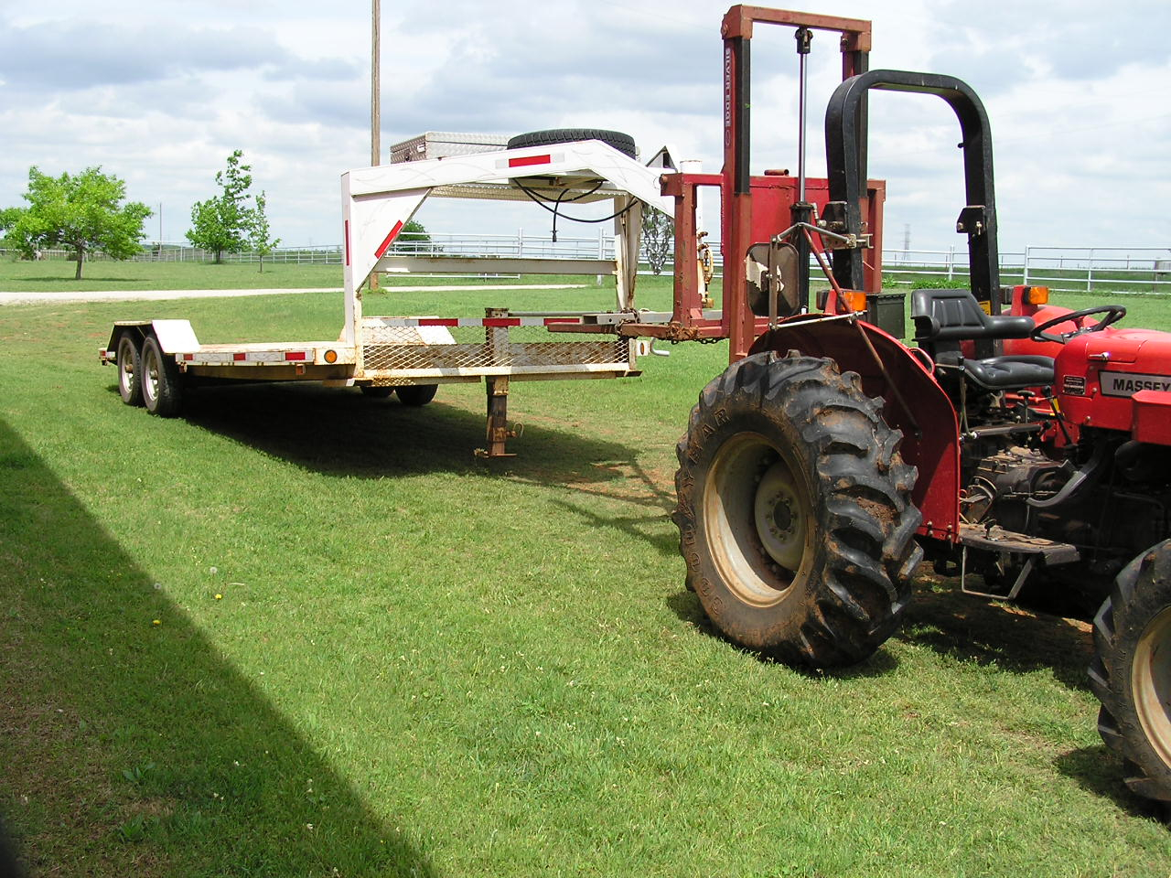

And the first GN:

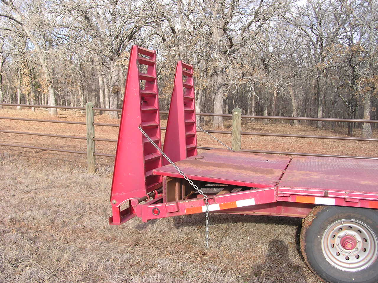

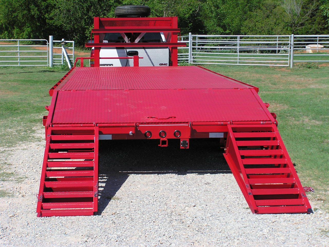

And the one I have now 18' + 4' pop up dove tail, picked up at the factory in 2006:
And the hydraulic ramps ;):Compact telehandler

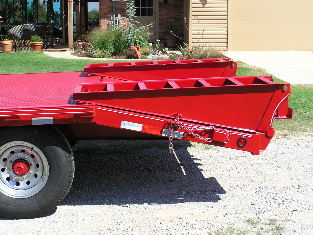

You can get a dovetail with fold flat ramps, adds 3' minimum. Don't like your how your truck is sitting get airbags easy 1hr installation, no onboard compressor needed, just use a standalone before you depart. I have a 18' deck over with 5' dovetail w/ fold flat ramps so 23' weighs 4100 lbs empty, trailer rated at 17k so technically could haul 13k has tandem 7k axles which means I could technically put 3k on the truck if trailers fully loaded properly. Airbags and Bilstein shocks make a world of difference. With that being said I'd never haul that much if I didnt feel comfortable stopping, 6.6 Duramax with exhaust brake. No weight distribution hitch as I run a pintle I also rarely go over 65 on the freeway unless I feel I have to.
And the first GN:
View attachment 717198View attachment 717199View attachment 717200View attachment 717201

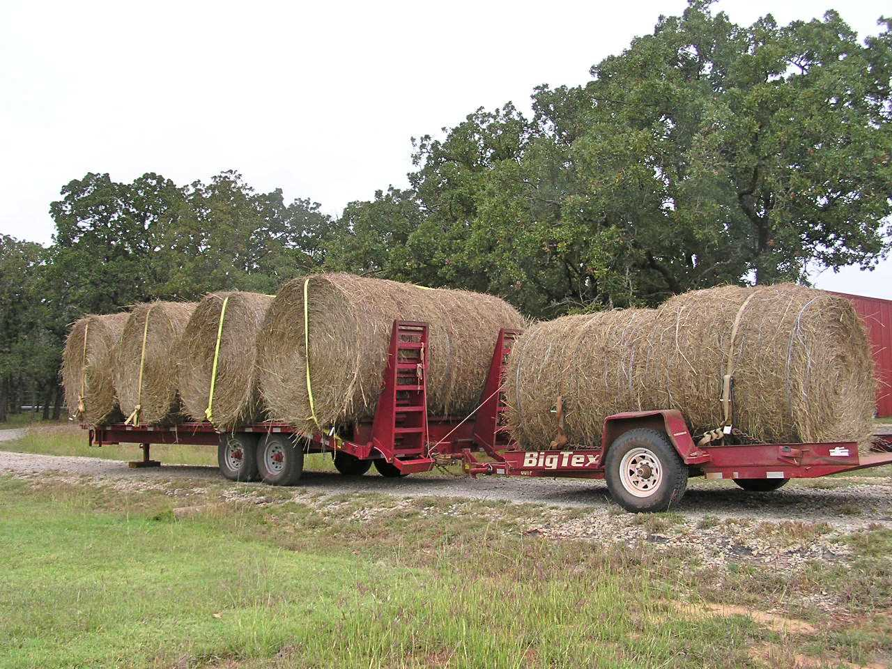

the new Ford Bronco should handle that double hay trailer easily.........
