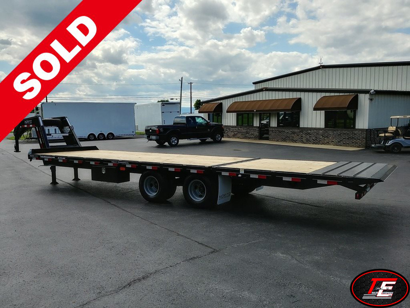

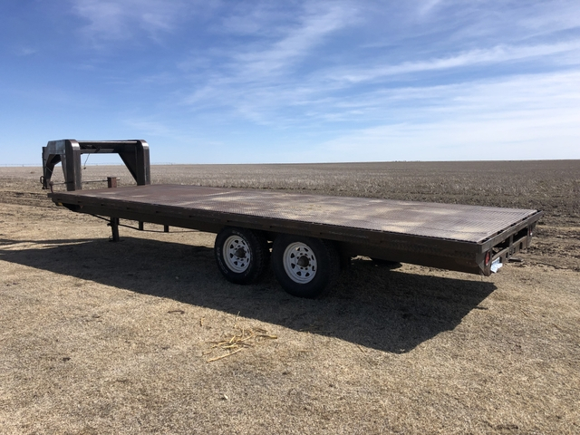

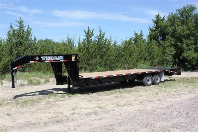

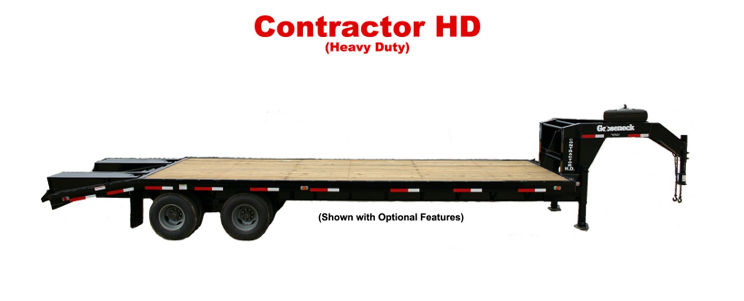

Here are some pictures, ignore the specifics, just look at axle placement.
This trailer has the axles more forward, meaning less load moved to the truck. This would be the type that is best, for a lighter duty truck, like what you have.
This trailer has the axles far back, in relation to the load carrying part of the deck. More weight on the truck. Easier to turn corners.
This is a spread axle (with hydraulic dove, ignore for this discussion) with the axles near the center of the trailer. Easier to get more of the load evenly spread between the trailer axles, even less weight on the truck. Tougher on trailer tires, when turning tight corners.
Spread axles, but set further back. If the truck can’t hold the tongue weight well, it’s easier to overload the front trailer axle.
A lot of F-250/2500 series trucks are traveling overweight. Especially, with Diesel engines. People think they can pull anything because their “tow rating” is higher than the weight they are pulling, but they almost never factor in the payload capacity of the truck.
