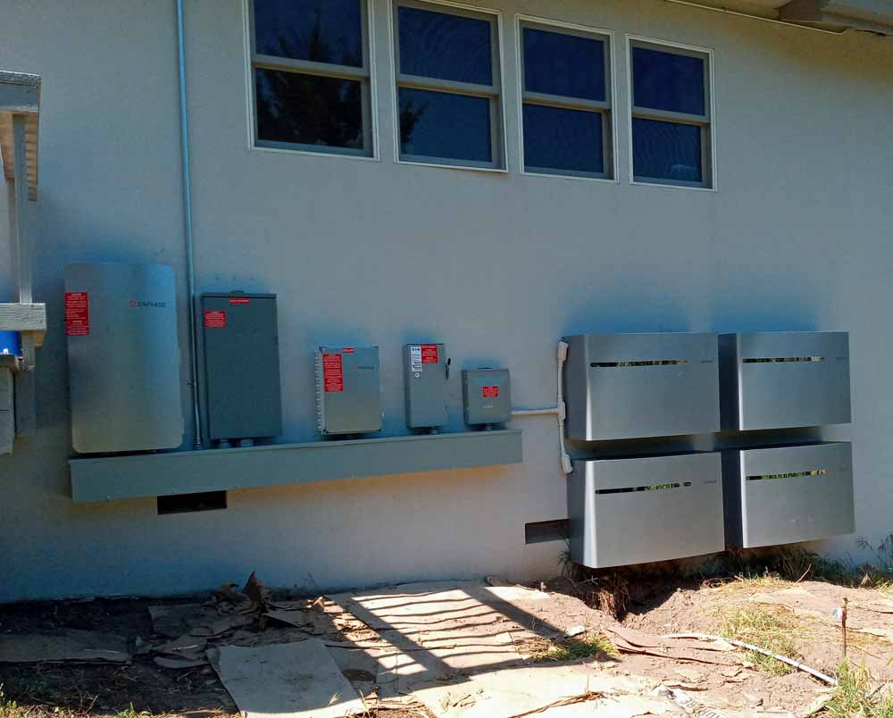

Our new neighbor on 5 acres just got their new Enphase solar system installed and working. 34 LG panels (13KW), with 4 Enphase batteries. $85K total up-front cost. Credits this year from the taxpayer will probably be about $30K, state and federal.
The switch to batteries when the power fails works seamlessly. The owner wants an EV to use more electricity as they now only have a PHEV. House is 3500sf with no shade and new A/C system. The lead time to get this system installed was just a few months.
