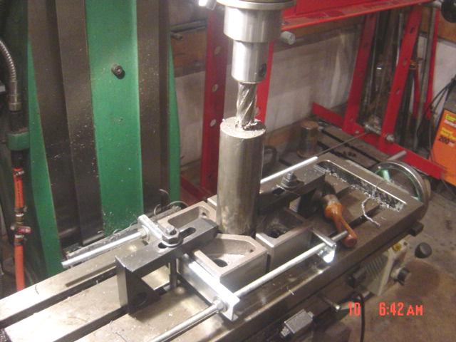

I use these when ever I can. ;)

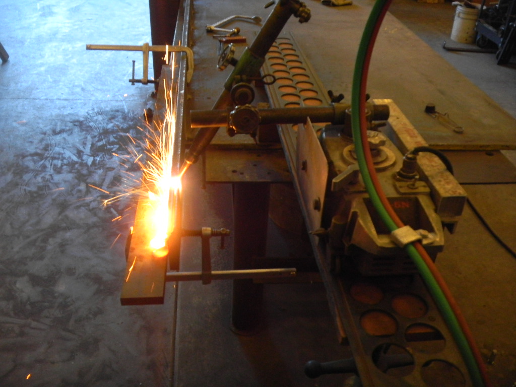

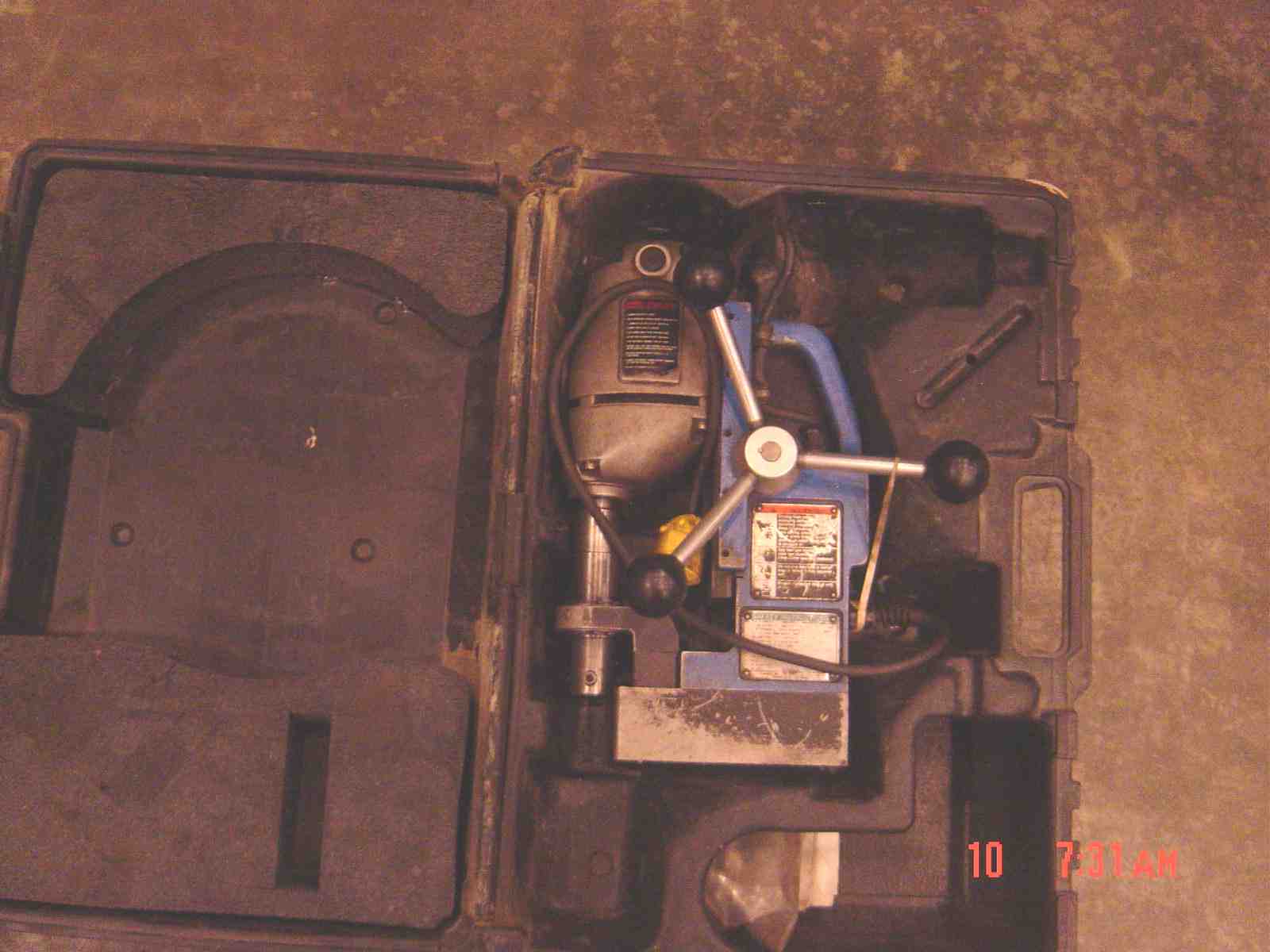

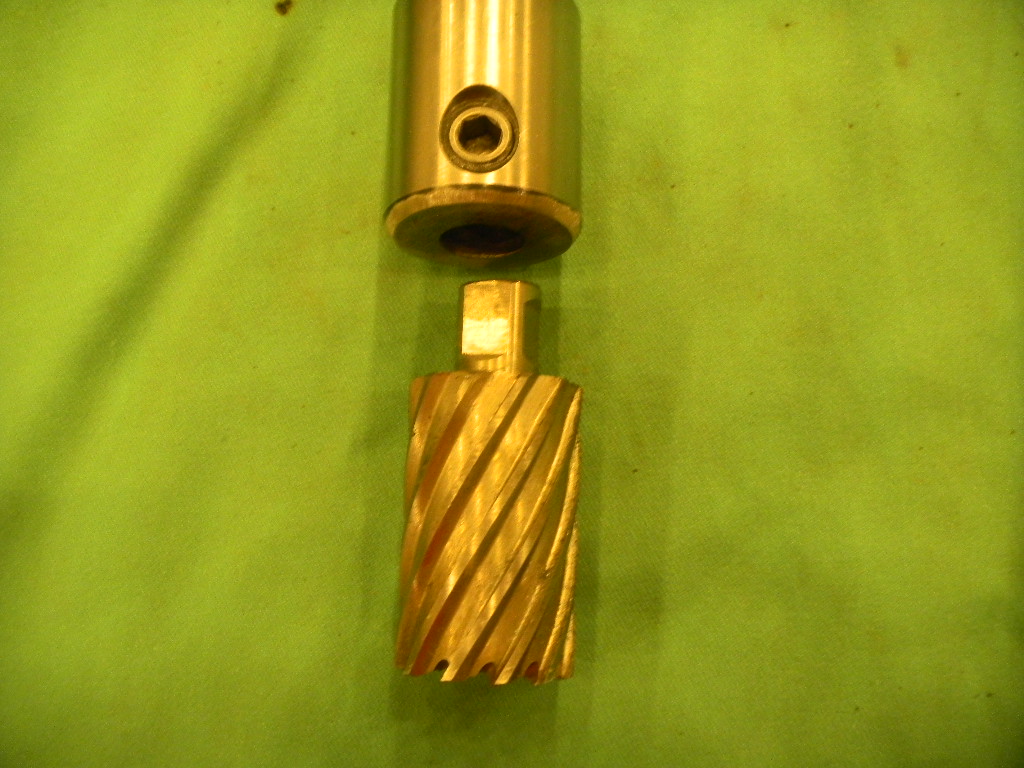

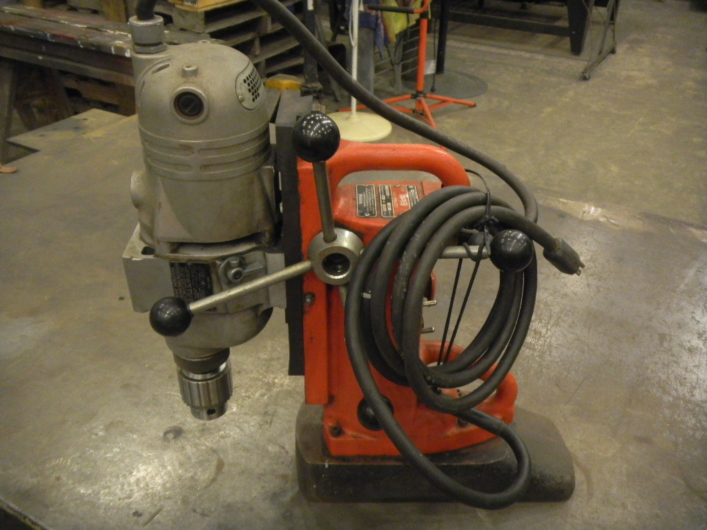

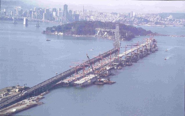

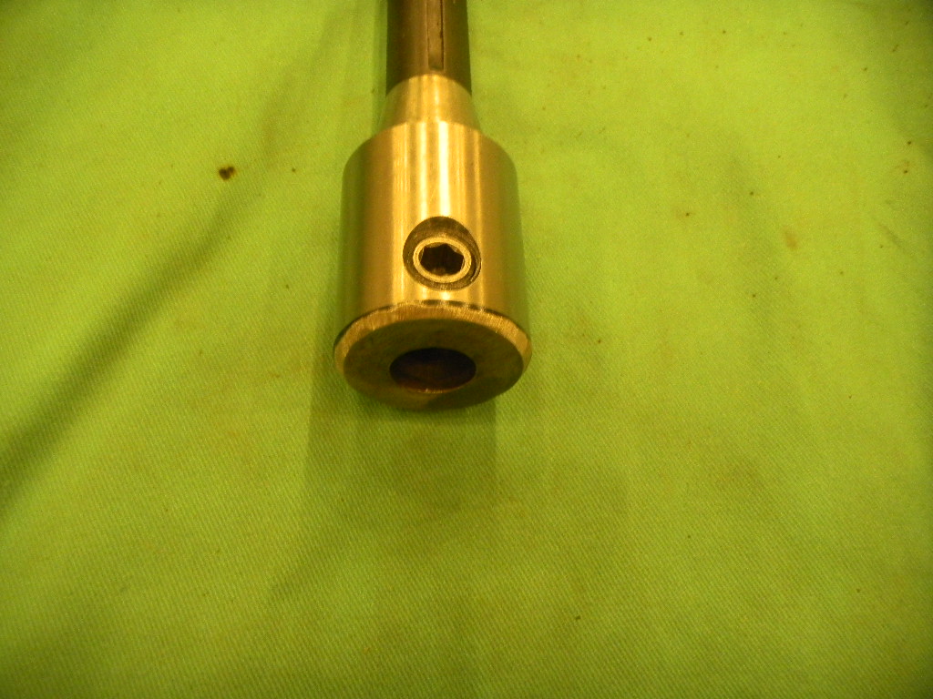

I didn't work for a mom & pop construction company. The company I worked for is fairly good size. Depending on the size of the project, the small tools budget may be in the hundreds of thousands of dollars. Can you imagine all the small tools that were bought for a project like the first picture? When these projects are completed all the tools, and equipment is shipped back to the yard. The small tools warehouse is probably 80' x 200' with a complete machine shop in one end. The small tools manager was pretty good at selling off some of these tools at times. I got this tractor torch for $50.00!
General Construction Company
I search Craigs list three times a day for good deals, I got this mag drill for $250.00. Sometimes you can get good deals on annular cutters off ebay, or Google Product Search.
I don't know how you would adapt an annular cutter to work on a drill press. What I did for my mill was take a 3/4-inch R8 end mill adapter, cut about 3/8-inch off the end, then grind one of the stops off the end of the annular cutter. So far it has worked really well.:cool:
